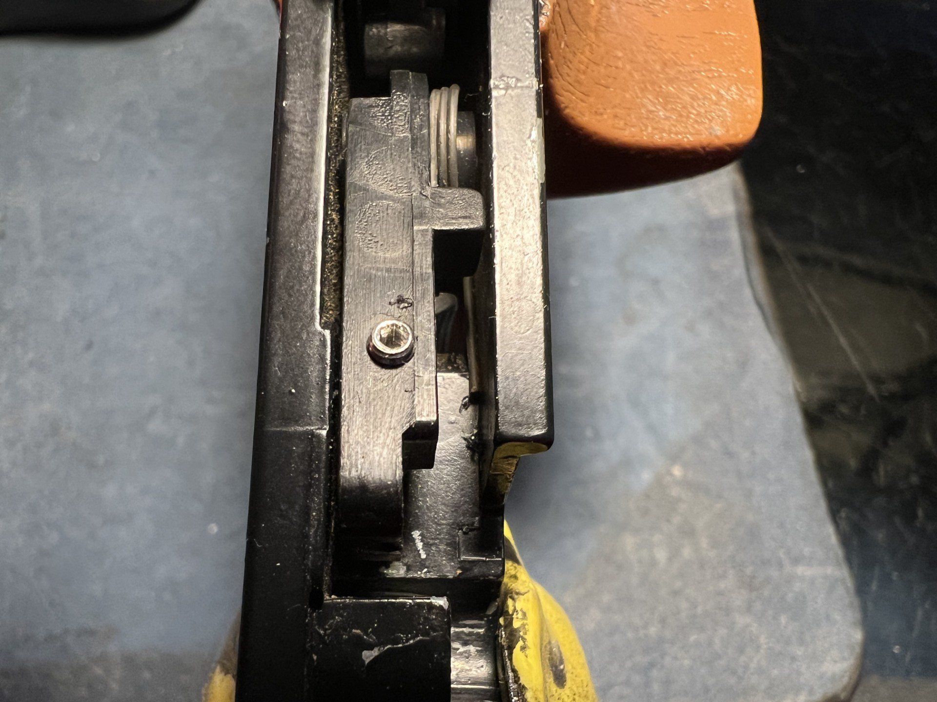

i have in the past been putting in a trigger stop
i like trigger stops because they keep you from jerking the pistol as the sear releases
i would normally use inch screws in inch guns but in this case i use a 2.5mm grub screw at 10mm in length
drill the trigger with a 2mm drill and i have been tapping them so a tap and handle would be needed
insert screw and test till it will not fire and back off and now when you pull the trigger it just doesn't move anymore
those who have never had a trigger with will wonder if it works and those who have will say yes it does
again, just an idea
