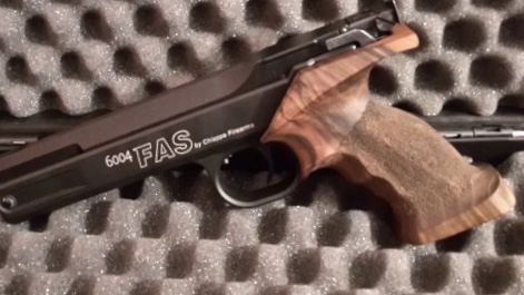

I have only bettered a 747 with a well set up FAS 6004 which is a base level fully fledges match pistol.

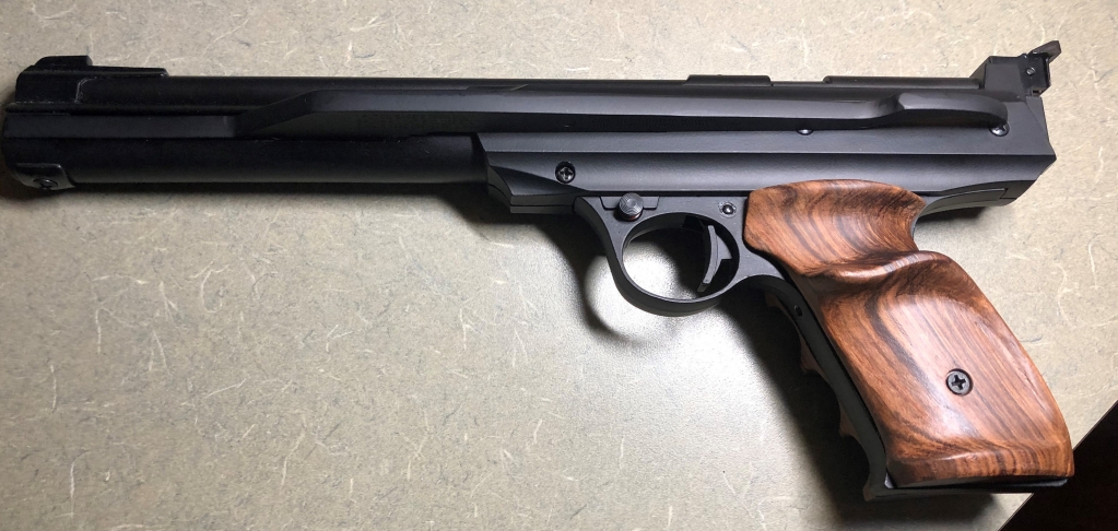

Steveoo , Sure getting a rise on my recently acquired Daisy 747. My 747 is wearing wood grips. Your hand melts in them. Trigger? Of many guns, this let-off is sweet !!
Reactions: SgtOutlaw76
Yes as said, you would be hard pressed to get an Air Venturi to beat this, especially when setup with grips like that....or at the least, the difference would not be worth spit. Less plastic also...
I know this is an old thread, buy where did you get a set of grips like that.
