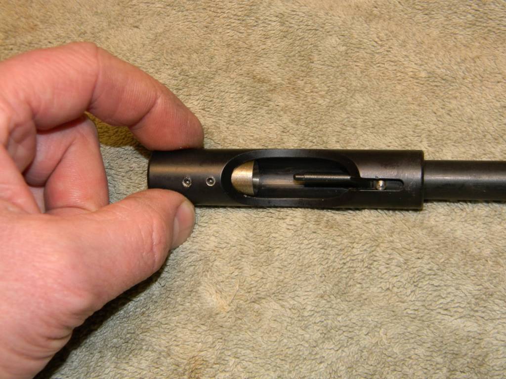

My 430 shoots really well as well. It won't quite match my Walther rifles for absolute consistency but it isn't far behind. Well worth the price, IMO. I've found the leade into the breech to be a bit oversize and that is a bit bothersome. Some pellets will fall out if seated with just thumb pressure. The 7.9 Crosman CPHP's are just snug enough to stay in place and shoot well in mine.
For what it's worth, some old Weihrauch barrel-cockers have the same issue with the leade size. I have found the secret to happiness with those is older RWS pellet designs, due to their relatively huge skirt diameters: Meisterkugeln, Hobby, Superdome, Superpoint, Super Hollowpoint.
Good to know. I'll look in my "hoarders's" supply and see what might be in there. I didn't make an inventory list as I did that unholy "hoarding" that some attack but since I did "hoard", I have stuff in there from lots of different brands. I know there are some RWS pellets I can try, as well as some H&N's. As noted, the CPHP's shoot well in it (and fit snugly enough), more than good enuogh for my needs, but consistency might be a bit better with some of those "other" brand pellets and better is better.
Interesting. I have not observed that with any pellet but I prefer tighter fitting pellets and buy them in larger diameters.
This rifle shoots better than my HW98 but being a 20 I have not had access to a lot of different pellets to try in it and one is lucky to just find pellets for it. You can forget specifying head diameters.
Might not be happening with guns made during a different production. Maybe it's the way you load it. I notice it badly with AA 7.33 Falcons and 8.44 DF pellets. If my gun is pointing upwards (my common position for loading the pellet), those 2 specific pellets will almost all just fall back out once I remove my thumb. 7.97 CPHP's all stay in in the same position.
You do know that you can buy pellets and specify the head size right?
The H&N FTTs I ordered for it were 4.52mm. The 4.50s don't shoot as well. This is true of any rifle. There is a head size that shoots best. Finding that head size is necessary to get the best accuracy from your rifle. That goes for HWs also.

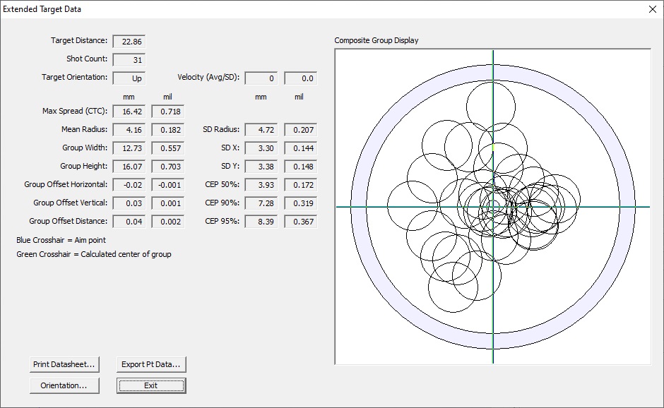

I use an application called "On Target". I am sure there are others. This is the one I have used for years to do target analysis.
I imported the last target I shot yesterday and analyzed it for rifle data and shooter data. When I want to know how the rifle performed I align the groups on their centers, disregarding the aim point. This emphasizes the performance of the rifle and minimizes the performance of the shooter when the aggregate group is formed. When I want to know how the shooter performed I align the groups on the aim point and disregard hold off or hold over. This creates an aggregate which emphasizes the shooter's performance.
So for the first analysis, "Rifle" error I got this aggregate:
This shows the rifle is shooting 2.59 MOA. One MOA at 25 yards is 6.35 mm (0.251"). This particular rifle really can put thirty shots in a row under a dime (2.83 MOA) at 25 yards . The next best spring rifle in the stable is probably my Model 36 which is off to John's for some work. The HW98 has not been given a real opportunity to shine yet. When I get an opportunity to get some pellets and specify head size (or sizing dies) I am confident the 98 will come into its proper place.

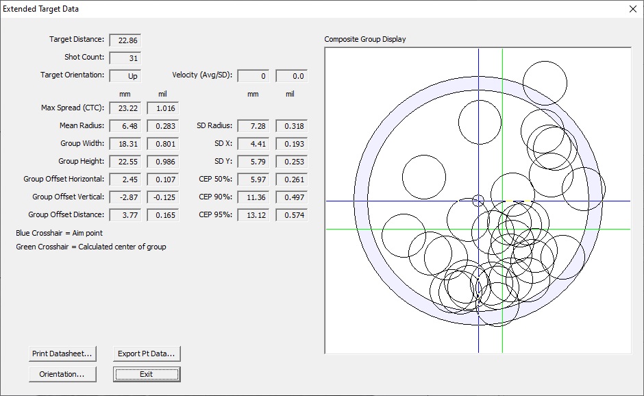

This next target shows how much additional error was present due to shooter error. Rifle error is included in this target and can be subtracted out.
Here the group size is indicative of shooter error and the offset is zero error. This aggregate is 22.86 mm in diameter (3.6 MOA). The other "Rifle Error" aggregate is 16.42 mm in diameter. This means I introduced an additional error of (3.6-2.6) = 1 MOA. That's not bad for conditions.
This sort of analysis can really inform the shooter about his rifle and his own shooting. One thing we can see is that my group tended to be below the green "true" zero on the second aggregate. Since that green X accounts for the error in zero, shots below that were caused by some error on the part of the shooter. Figuring that out is the entire point of the exercise.

No, I know that you can buy SOME pellets and specify head size. And what shoots best in YOUR gun might not do so well in another gun. The AA 7.33 pellets (and the 8.44's as well) shot just great in my 430, but they wouldn't stay in the leade. I have some 4.52 pellets as well. Didn't shoot so well.
