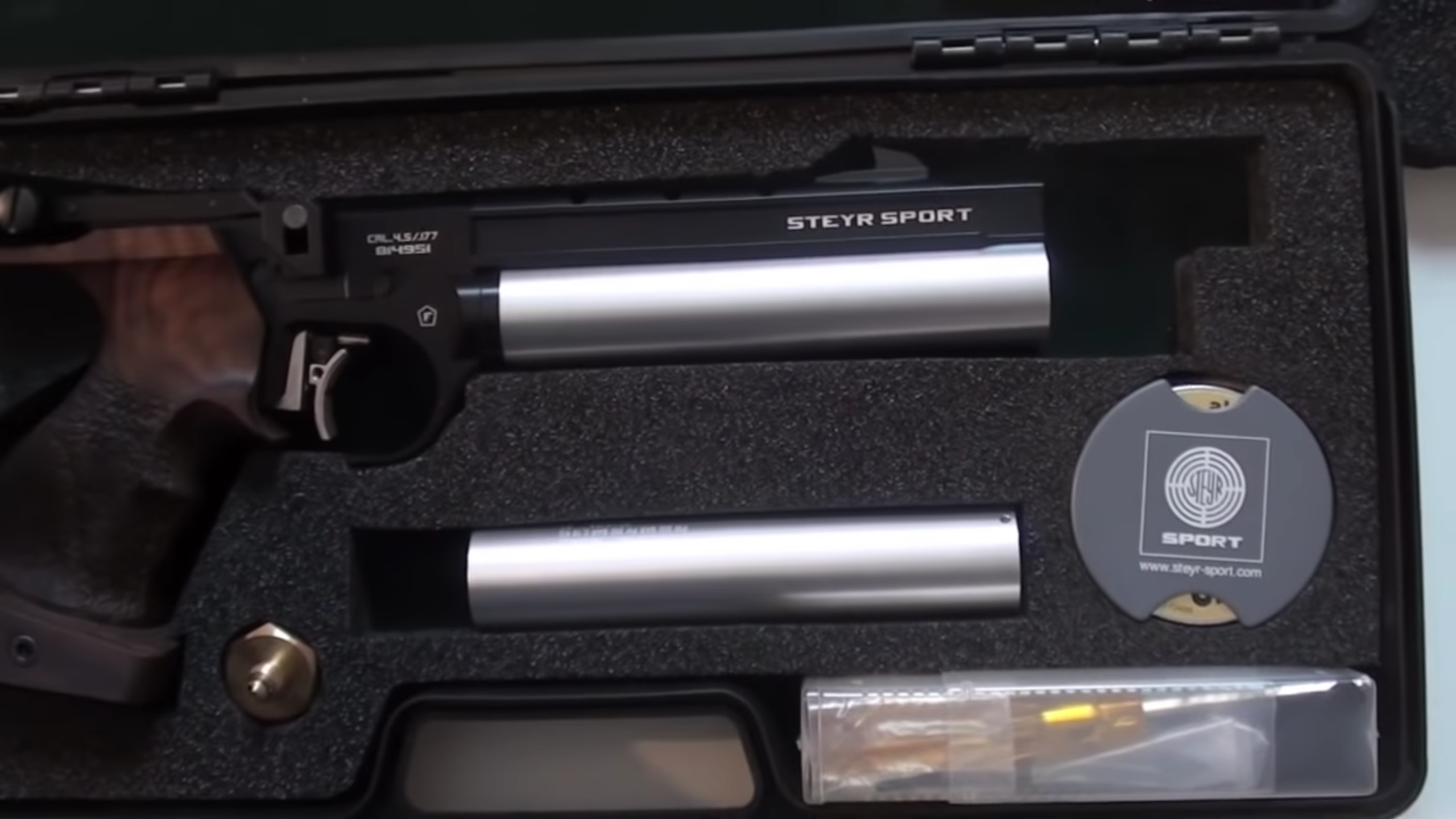

Cylinder Wrench

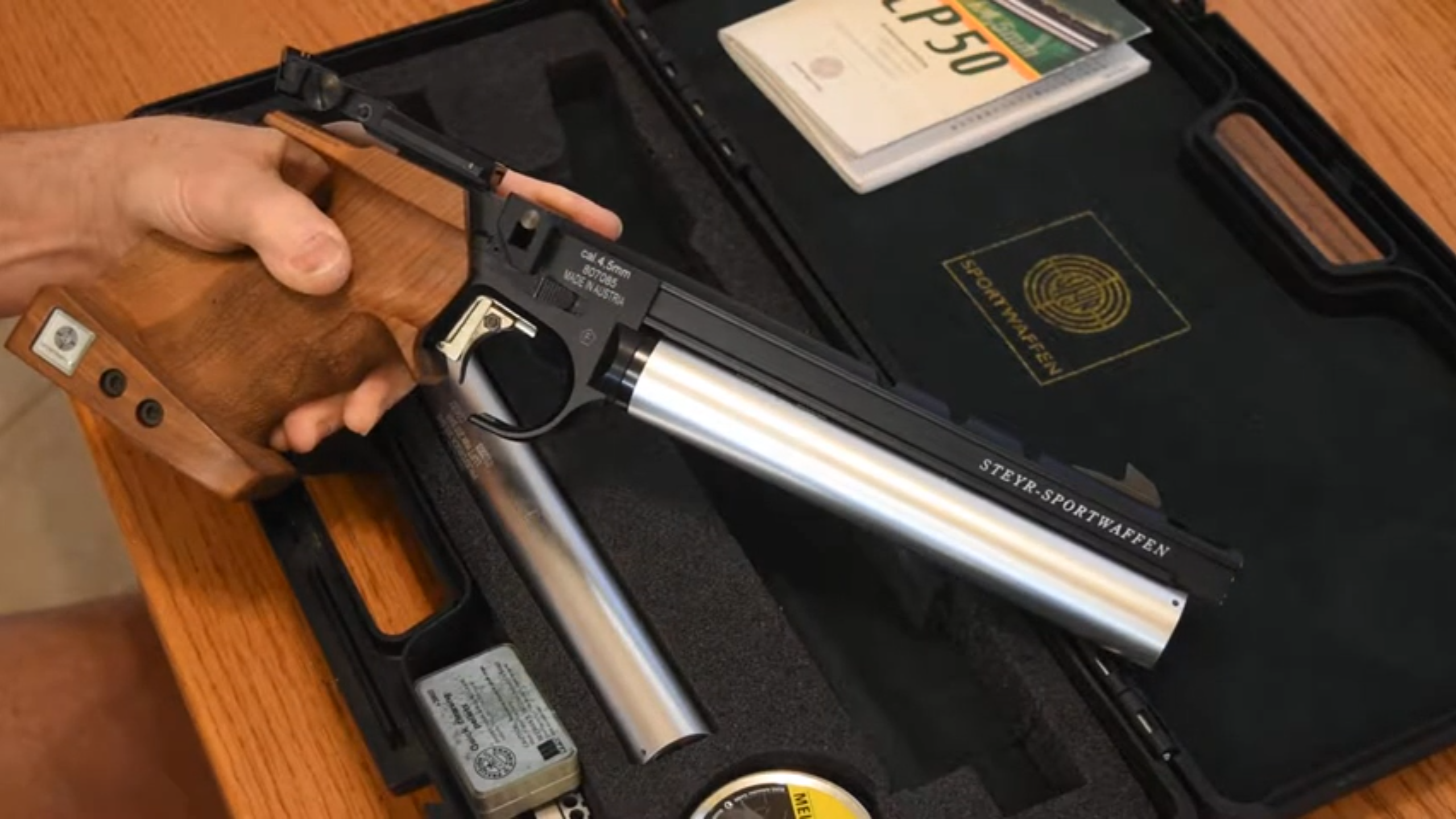

There is no gap between the barrel and the cylinder
Wow. What an excellent design!
I'd clamp the tube in a vise between a couple of pieces of wood while leaving enough room to rotate the rest of the gun a little. Turn the gun, release, reclamp, then repeat until it's loose enough to take off by hand. Then I'd sort out a specialty tool that would make the vise unnecessary. Perhaps padded-jaw pliars or vise-grips.
Edit - Just looked at a pic of one. What I said applies.

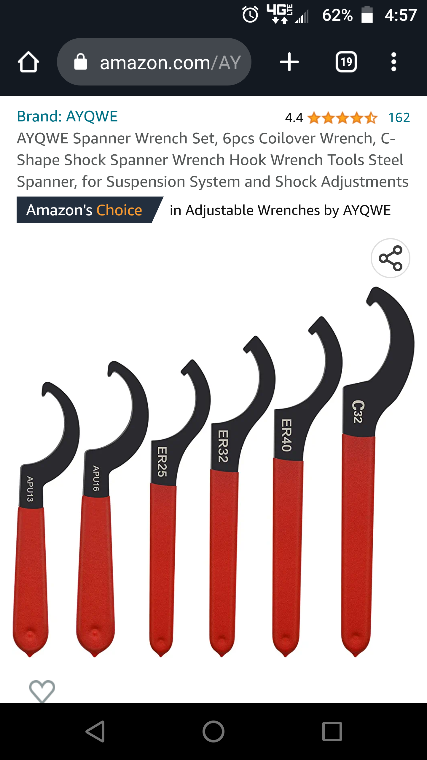

Spanner wrenches only work upon round objects that heve the correct indentation milled or molded into them for the wrench to take hold.
Steyr appears to have machined a hole in the side of their air cylinder for removal and installation, specific to a spanner wrench of the appropriate size.
