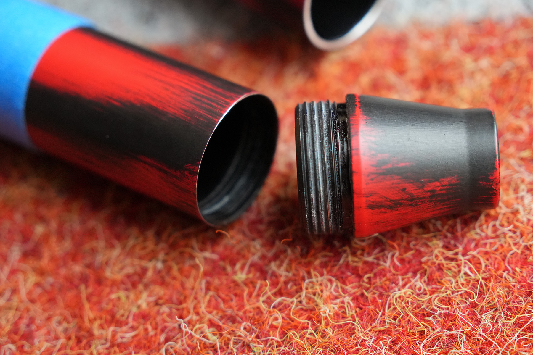

So I cut the gun end of my 700mm M3 shroud and found out that it is also threaded on that end as well as shown in the photos below. Cutting on this end is definitely still the right thing to do b/c cutting on the other end would affect where the barrel end sits in relation to the end of the shroud and probably make it less effective. So now I have to get the newly cut end of the shroud rethreaded so that the cap will be able to be screwed back on...
Why to screw back on? Take a file and remove the thread tips (only to the bottom of the thread) and it will slide back into tube. Of course you will glue it at the end...
The mainest reason i can think of, is that threads are a lot better way of adjoining 2 pieces of metal, vs glue. He wants it to be nice, like factory, not a cobbeled up piece of junk.
Ive just bought a 500mm barrel for the maverick second hand and cut the shroud to lenght for the 500mm impact with a plumbers pipe cutter.
The cut was perfect, take your time and don't do it in a worry.
Filed the threads of the cup and installed it with some strong 2 components glue.
Works like a charm and saved me like 150 dollar.
Just waiting on my Alsafe 300cc bottle now.
It's not a bad idea to file down the threads and glue the end piece back on and I would do that if I didn't have another option readily available. Luckily, a local friend has a machine shop and said that this would be easy for him to do (at no cost) so that's why I would prefer to go with getting the newly cut end of the shroud rethreaded. If that wasn't an easy option (or if it was going to cost and arm and a leg to do), I would definitely consider going with the filing/gluing route...
