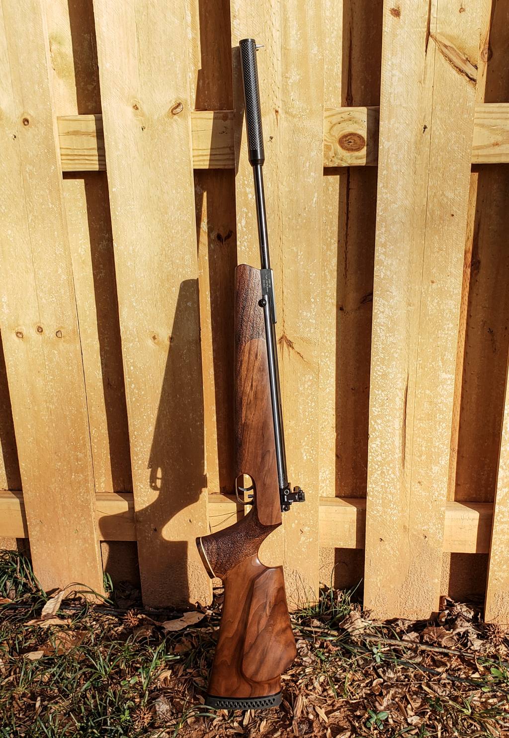

I recommend you do what I did. Get a slip on mod and make some internals for it. Mine covers at least 5" of my barrel, and I use it to cock the gun. Still effective at sound dampening, too. (hw50s)
