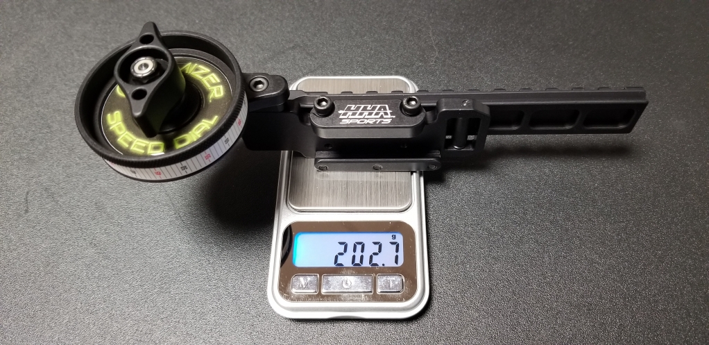

Does it really weigh 1.2 pounds ?
I have a digital scale kicking around here someplace..
If I can find it, and it turns on / works still, I'll weigh mine as soon as it gets here, and let ya know.

As promised, here are a few different weights for the setup - complete - straight out of the package. 🙂👍
Thanks... could we see the other side please? I just want a good idea of how it works.
Welcome, and you betcha.
Actually, I did one better, and threw together a quick video for ya. Photos first, then the Optimizer in action!
https://www.youtube.com/watch?v=jCJ6pMwuNds

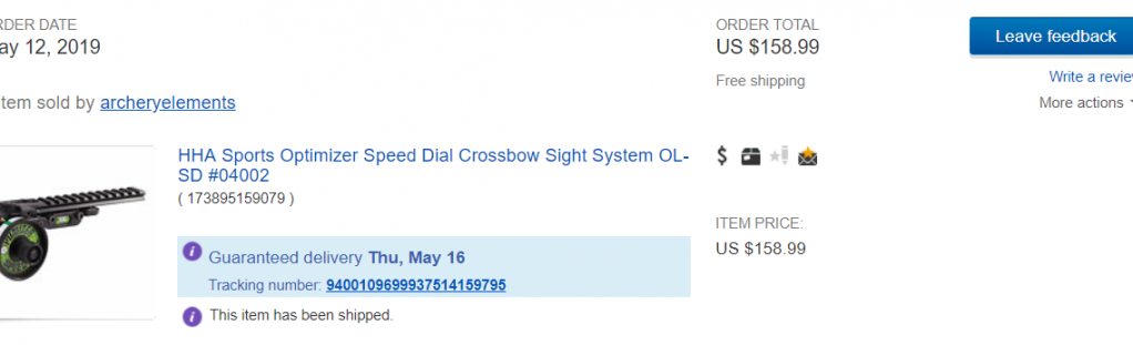

And not just because the Optimizer showed up.. Today [well.. yesterday] I lucked out, and scored a new rifle!
I scored a KalibrGun Cricket Mini Carbine WST .22 Cal from another member on here, sooo...
Now I'll have a Killer little gun [that I've been wanting forrrever] to put set the speed dial up on! I can't wait!
