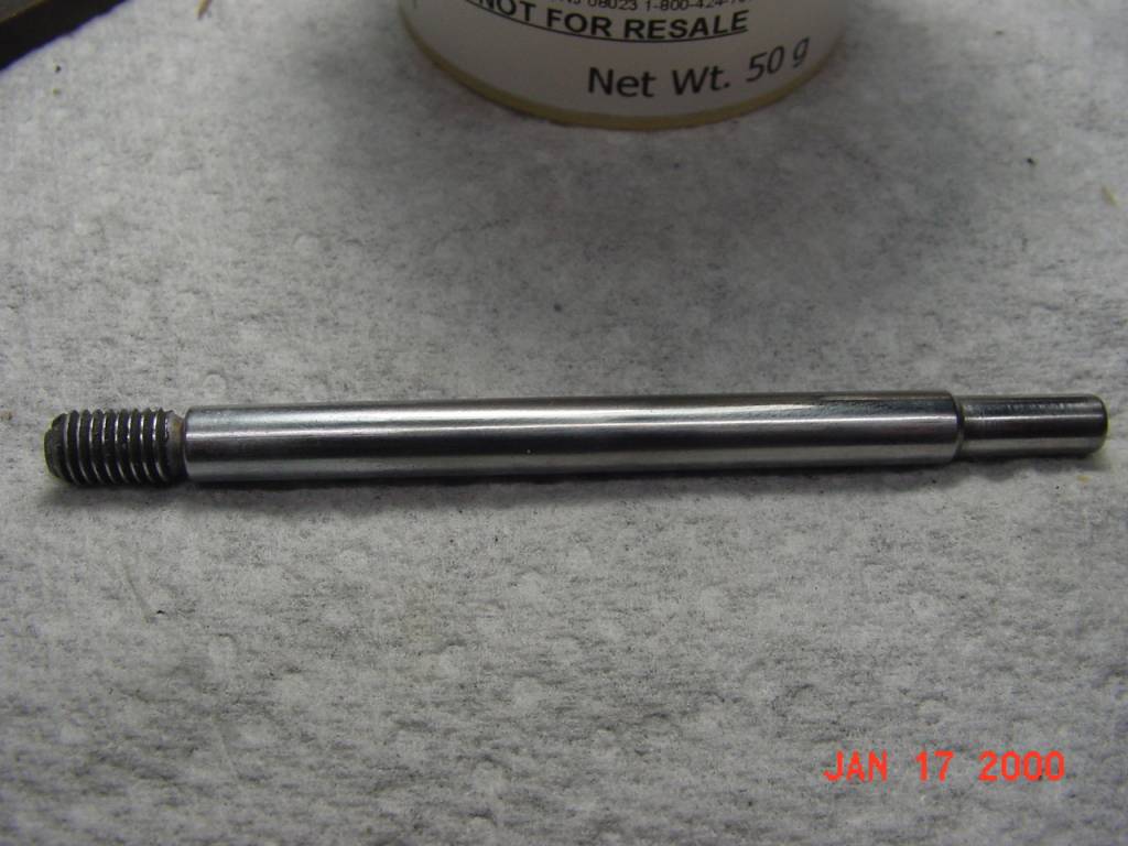

As many of you know, I have been in contact with the company while evaluating a few issues with the platform. I have made several suggestions to them and most of, if not all of the changes are being implemented.
Here is the first improvement, the Hammer Guide/Adjuster rod will be upgraded to harder steel rather than he current SS rod. The Stainless Steel rod and Hammer combo is causing galling and is the source of the erratic fps numbers This will change that.
Customers need only to contact Cattle man for the upgrades which will be provided by them happily.
This is the part that will be replaced in the first change and available to the customers. The new steel for the upgrade has just been ordered and will be implemented immediately. 👍
