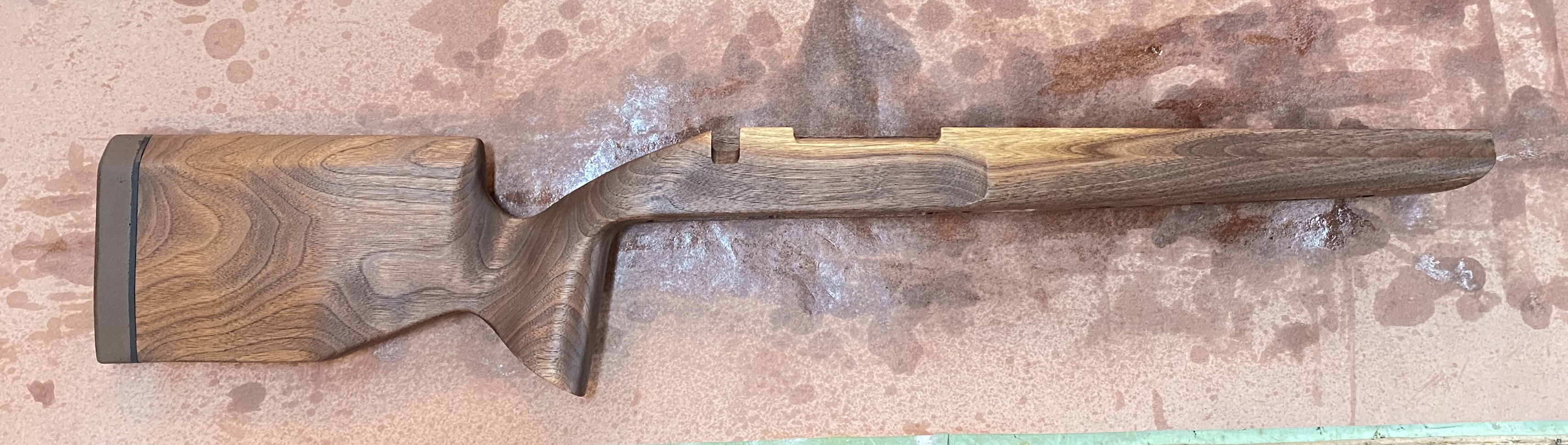

I've made a few stocks. I first inlet them for the action while the wood is a square shaped blank and then I bandsaw to rough shape and then use various tools to bet the outside to final dimensions. I've been using my domino machine a lot recently (a hand-held slot mortiser) for the inletting but a plunge router works well too. Never used a milling machine or metal lathe, however. I attached a picture of the most recent stock.

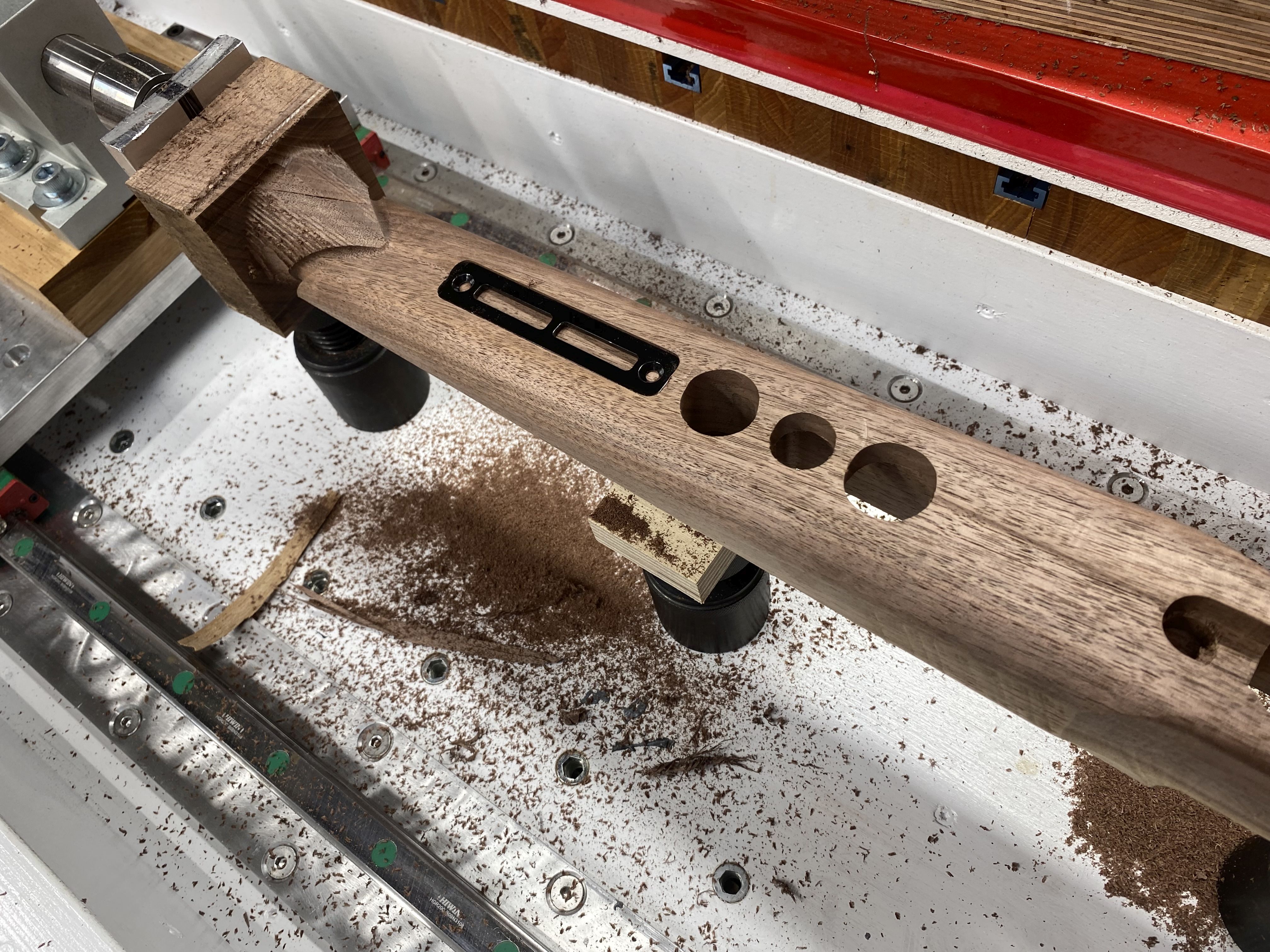

I actually had already model and cut stocks for some Remingtons. I used one of those models as a starting point for my CAD model which did save a bunch of time. This action is NOT a drop in for a Remington 700 stock. Close, but that only counts in horse shoes and hand grenades

Thanks, at this point nearly all the machining is done.

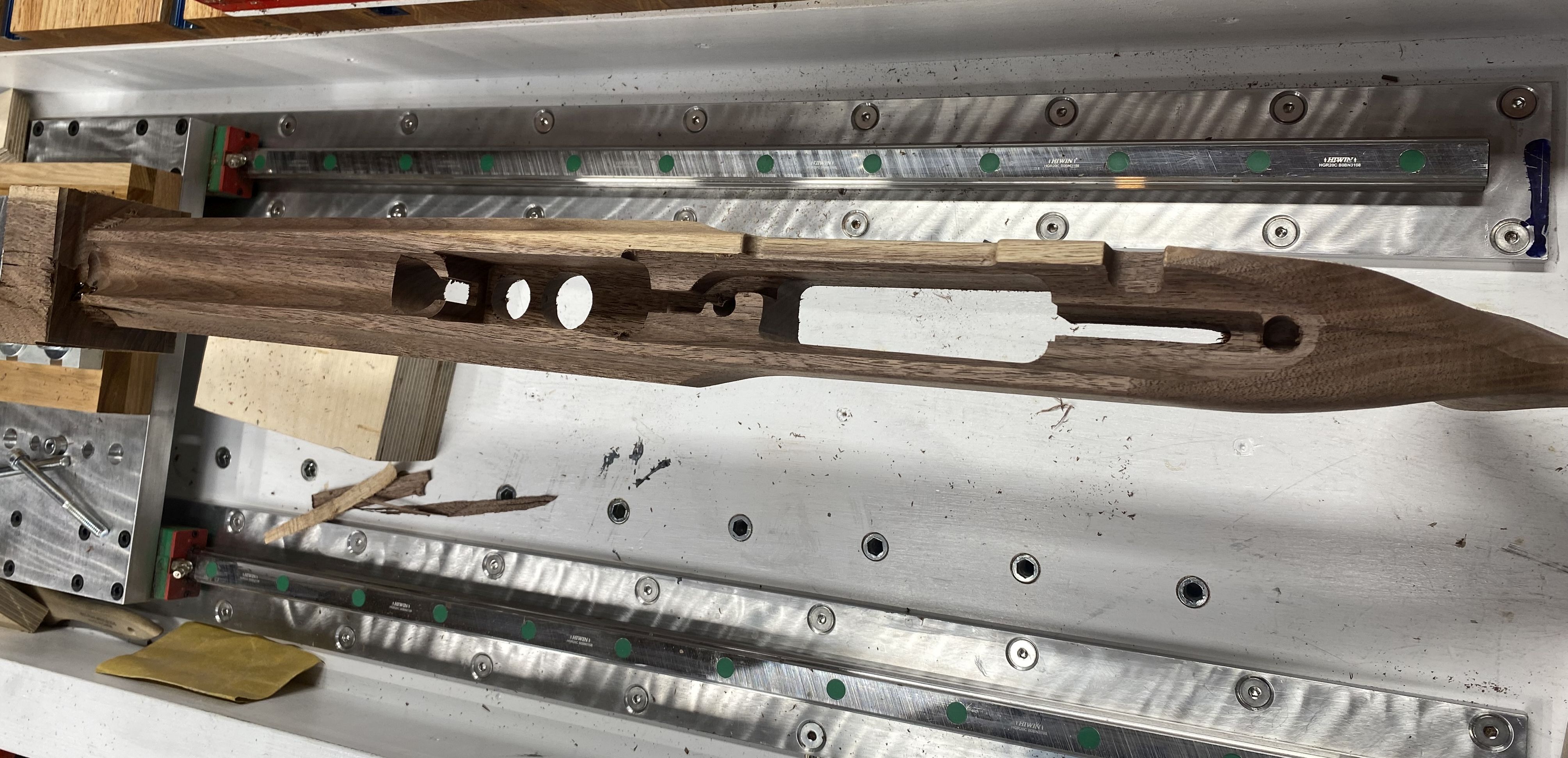

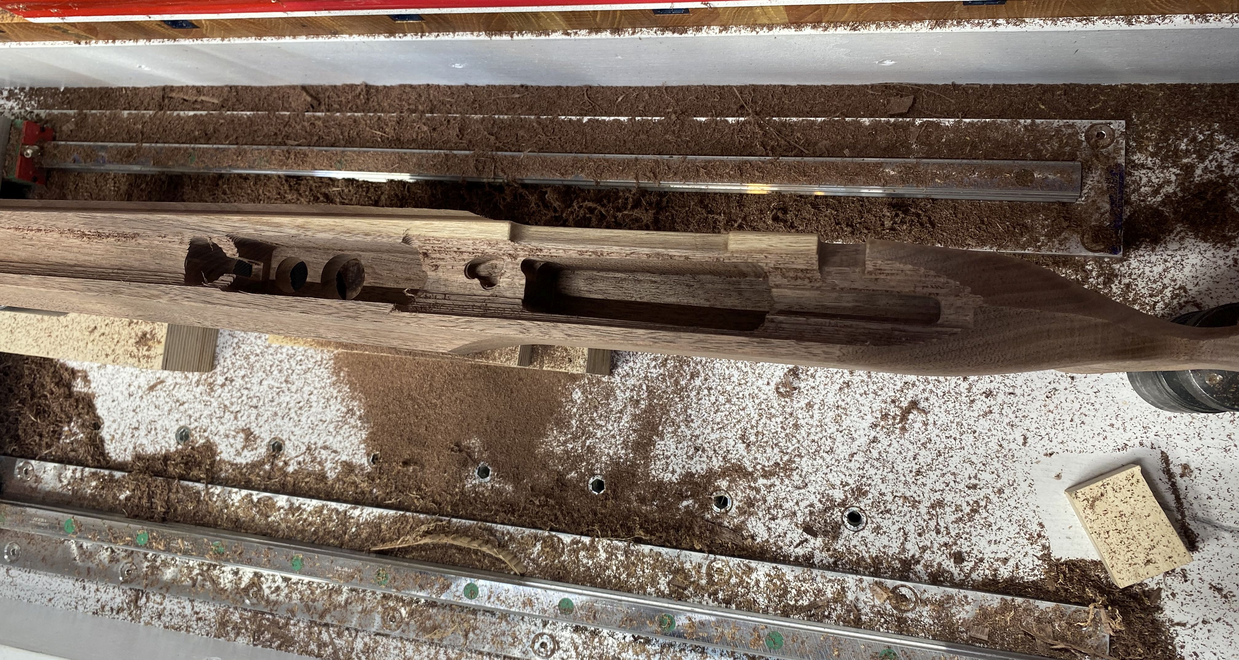

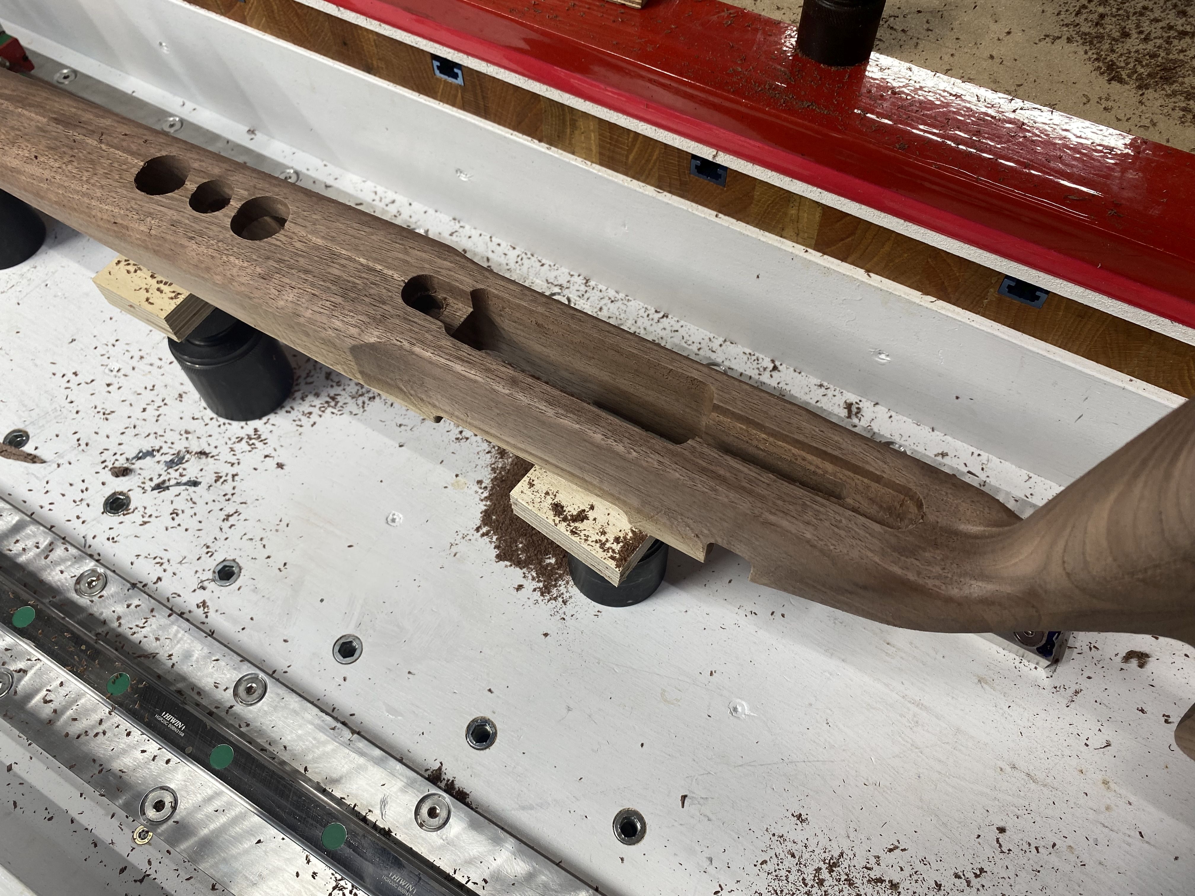

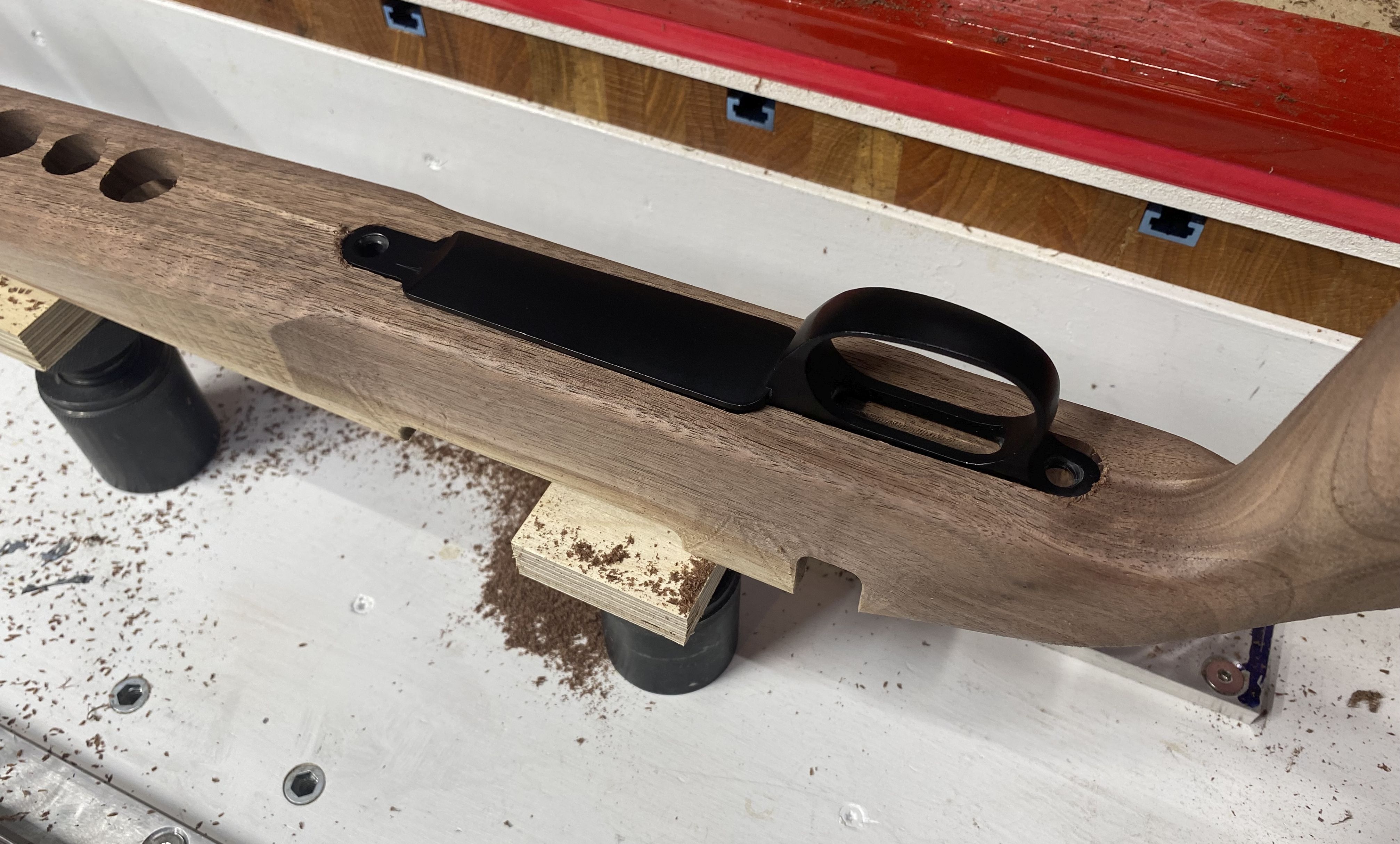

Fresh off the CNC. Cut the tooling lugs off the ends and dropped the action in. I think it is going to look pretty sharp once fitted out.
My mind wants to flatten the hand grip to the same line as the butt. But that could be your signature. Extra props on all the gauge cut outs, you must be one of the few that can do that work. You must have been inspired.

It came to function over form. Bringing the grip bottom up starts making the grip a bit to short. I made a number of 3D printed prototypes of the grip before cutting wood.
