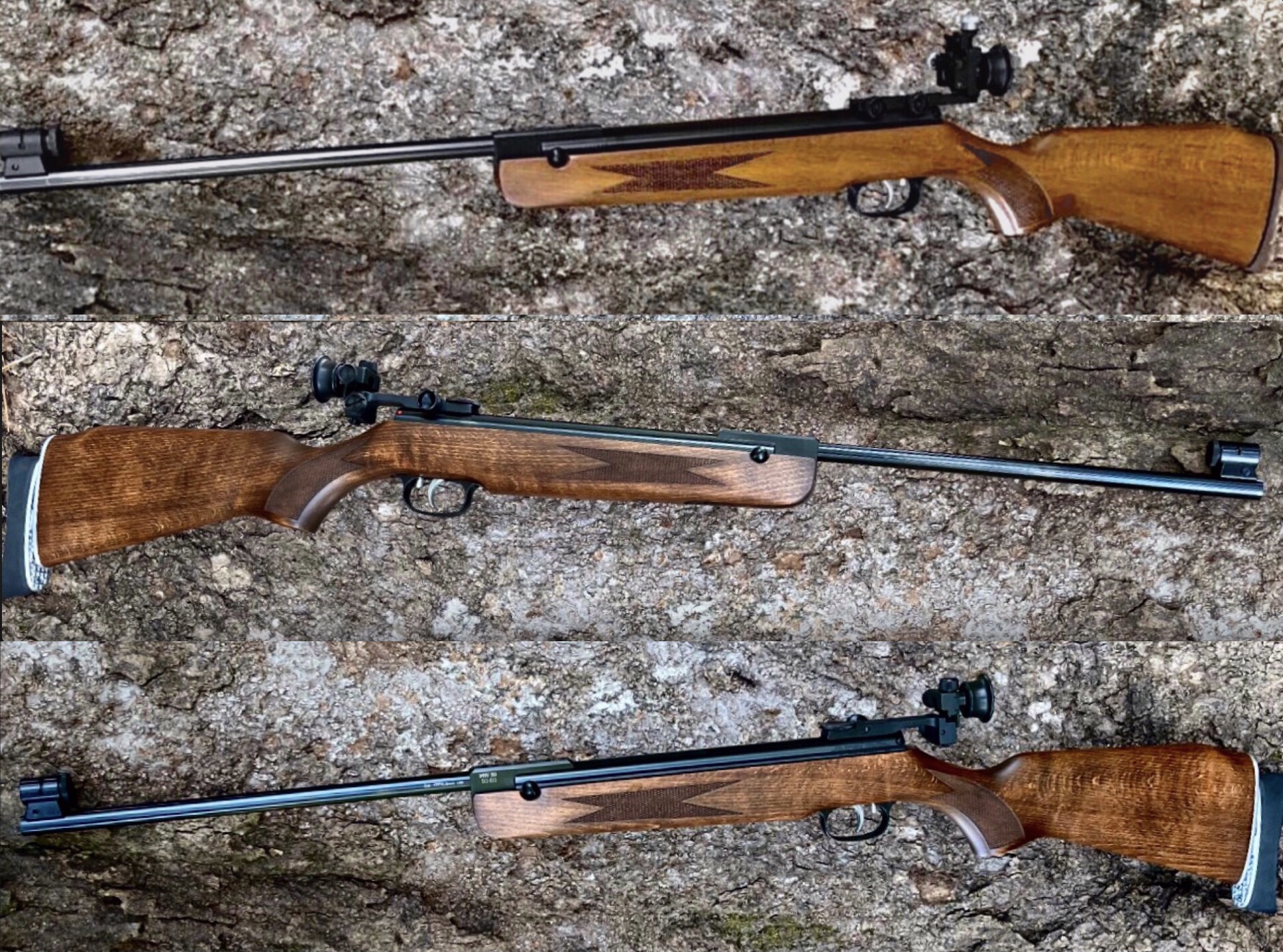

That wood is not American walnut of any sorts..I’ve owned many of them and sold each one( the stock only) as I replaced them with my own.. Webley used some over seas wood, that unless filled pulled the snot out of your beard .. As for finishing, you can’t get the proper finish in three days.
If you want to get the chatoyance of the woods potential..its not a oil sealed sand in.. it’s much more complicated. Unless your lucky enough to have worked with the stock makers of the 70‘s .. you just won’t get it.. A true glass finish with pores microscopically filled ,yet satin sheen..

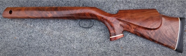

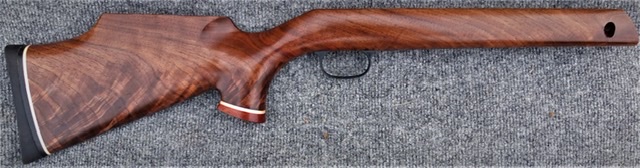

This is a $1500 fiddleback exhibition Claro blank I did ,15 years back. Sealer IS SPAR varnish/ spirits/ first 3 coats.. Then Spar/turps/tunge oil blend . When complete glassed over and pores filled, the fun starts. Dry sand down with 320/400 to remove most surface finish, leaving big pores filled. Wet sanding of tunge oil blends starts and the slurry fills micro pores and grain giving the start of the color. This transpires several times wiping the slurry less and less. With paper towel or burlap .. Then it’s 400 with wet oil to smooth over and dry wipe, depending on wood could be 4 to five times. Each coat needing at least 12 hrs to dry and fall INTO the wood.. Now it’s palm rub time.. another 4 to 5 times.. drying each time.. After you get the deep stare into the wood look and any figure pops like a 3 d (chatoyance) cats eye . You let it sit 1 week..
your close but not there yet.
Time for rotten stone and oil to even smooth it all together.. then the final coat is BLO . Then you maintain it with BLO EVERY NOW AND then. If your working on it every day it’s usually 30 days…
oh yeah.. Checkering.. have to wait 30 days minimum after finishing to make sure woods stabilized and hardened so you don’t get fuzzy diamonds. Another long expensive ordeal..
THIS WILL GIVE YOU A WEATHERPROOF wood stock that will not warp or crack . Pending your wood was properly aged and ready..
Ps ..for the record ,I wouldn’t put Macarri oil on my dogs house… 🤮
Thank you for sharing your experience. That's a very, very nice stock. Flawless satin finish.

In the process you describe, how do you deal with the checkering? You can’t really paint it with SPAR and then sand it off. How do you keep it looking consistent with the rest of the finish?
A new Stocks Checkering is done last, after the whole stock is finished. If you’re refinishing an existing stock it’s actually a bit more work than doing a new stock. Checkering is usually taped over with masking tape while you’re stripping and sanding. Then you use a mild solution with a toothbrush to get the Checkering softened. Usually it’s re-pointed after you refinished. Most airguns you see are pressed checkered or laser cut. No manufacture does true diamonds.

Notice Macarri and Corcoran don't use old fashioned BLO techniques. It's not necessary IMO.
Macarri uses his own RLO and Corcoran uses Minwax Antique oil. Both can be completed in a few days.
This Tomahawk stock has a coat of oil stain and only 3 coats of finish. First one sanded in to fill some grain. Edit: No, it was only two coats!
Lovin' that left hand stock.
