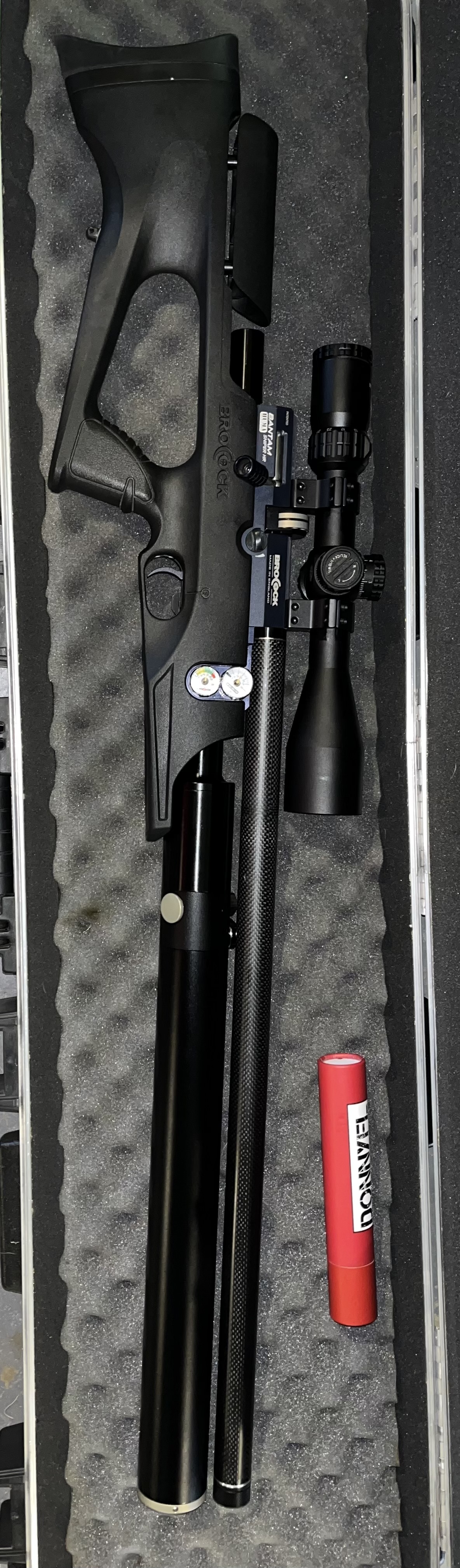

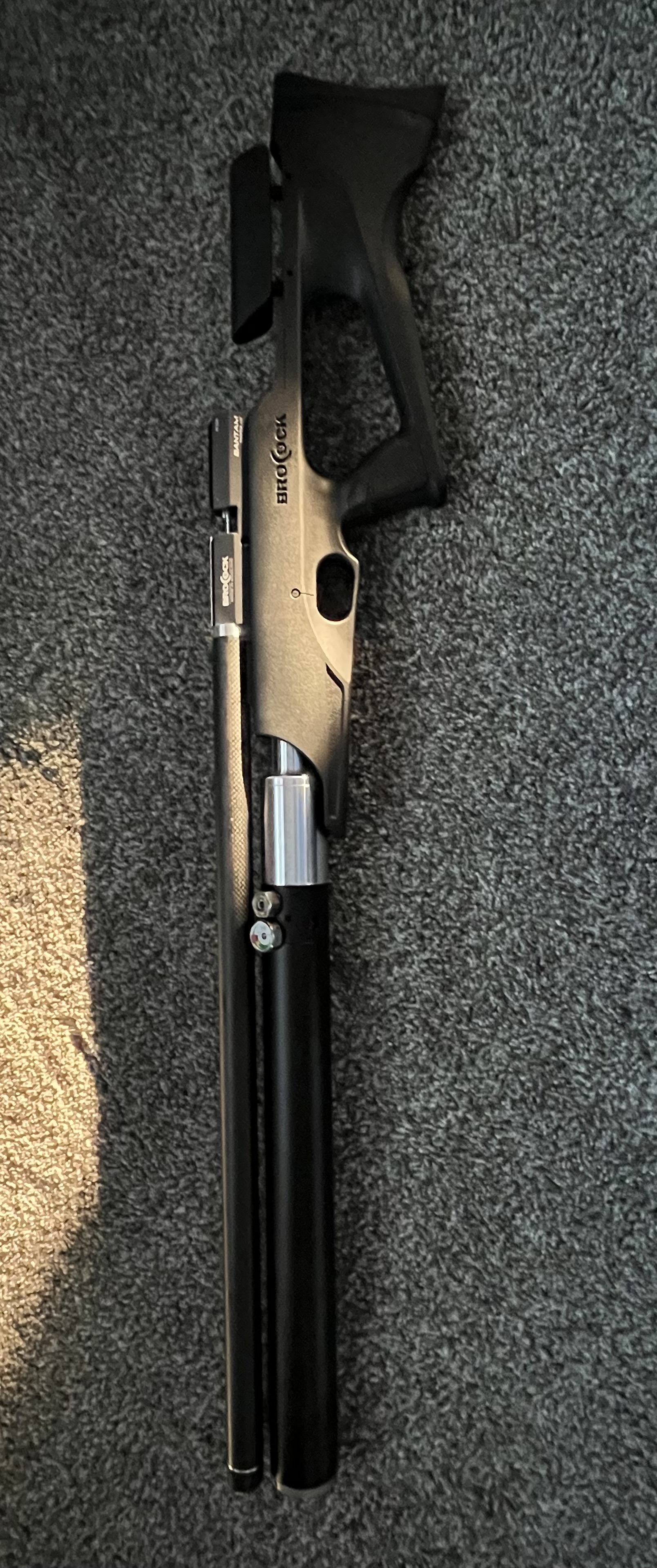

Havent posted on here in awhile. Figured Id share my latest boredom. I wanted to ditch the tank as I favor tube guns. So I adapted a aea 600cc tank, external reg and plenum. Adapter is 7075 aluminum. You have to bore some flow holes in the body and plug a couple things. It also has a tensioned tj .25 barrel, custom hammer and spring stop guide ( not shown). I’ll post finished results once everything is back from annodize. Its also got a custom valve and is ported. 165 bar quick test showed jsb 34gr at 1080fps. Im going to tune it for 880fps for a high shot count. Barrel is 27.5”. Lets hope its accurate!
