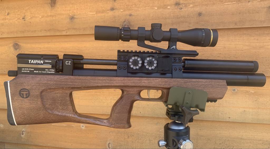

Are there members here that are making custom shrouds and baffles for the Taipan Veterans? I have a .25 Compact with a plenum extension. I'd like to add enough length to add at least one more baffle, maybe 2.
Thanks in advance!

Here's my gun as is, with plenum. Running the JSB's 25 grs at 865 fps. Sweet spot for decent ft/lbs (42). Super accurate, but a touch loud to my ear, hence my want for either a slightly longer shroud or standard compact shroud with a 4 1/2" moderator. Hammer spring feels like its almost backed out. Not planning on reducing power any time soon.
Once I get the moderator I will follow up with a report.
