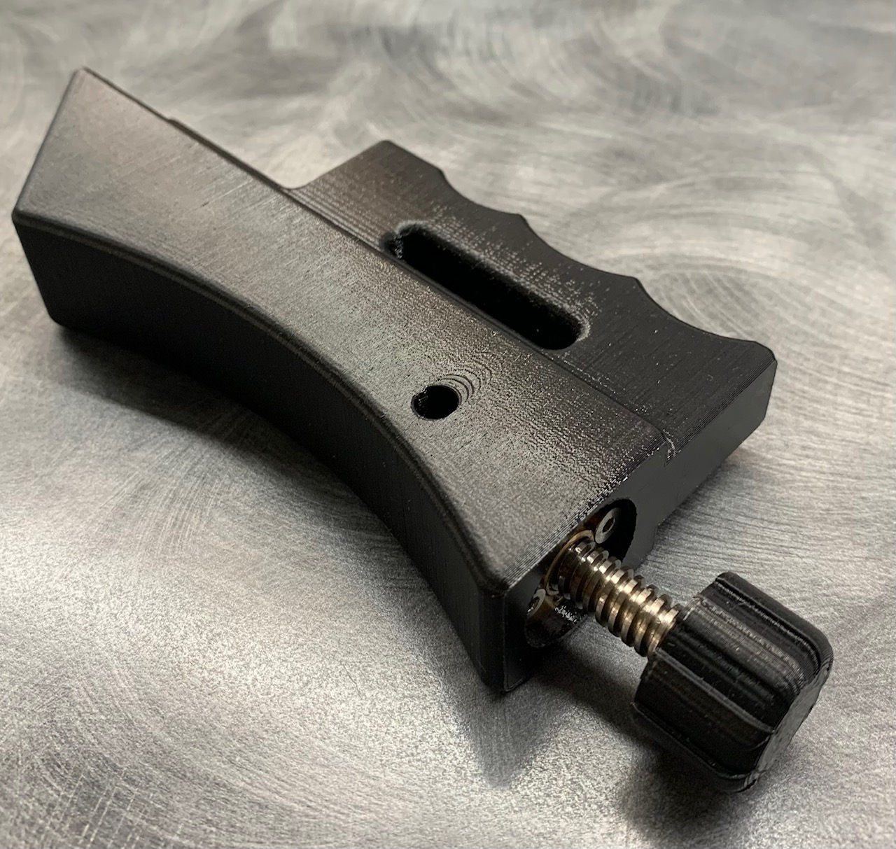

The the sabre tac monopod is using a 3d printer drive screw. These can easily be sourced online. Below is image of a FX impact 3d printed monopod with the drive screw and brass screw nut. It works excellent, very smooth and tight. With this stainless screw and brass nut a monopod can be easily made for most AGs.

FX Impact monopod by KMonroe
This uses a lead screw similar to saber tactical mono pod. printed in PETG at 25% fill use small screws to hold lead screw nut into PETG lead screw does not fit into cold base nob. Heat up screw with torch and screw into nob, it will bond tight. Not too hot! UPDATE: Knob 2 has round base and is...
