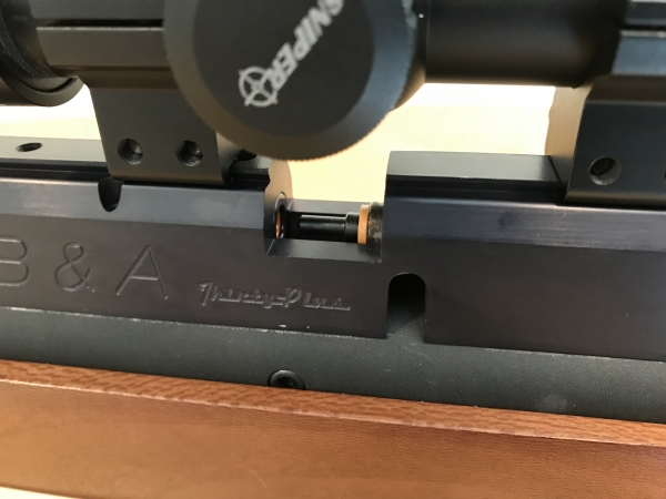

Hey Everyone, a couple of months ago I began on the expensive and addicting path of creating my custom marauder. Back in December I got a .177 marauder and after a couple of weeks of shooting it, I wanted to convert it .25. For a while I flirted with the idea of doing it and decided at the time that I wasn't ready nor experienced enough to do the conversion.
Fast forward to February, I was hunting around the internet and came across hillairgun.com and saw his valve that he made and bought it. I had my .177 shooting 15.74 grain pellets at around 1050. Of course that wasn't enough so I looked into converting it to a .25 cal and decided to go ahead and do it. I felt that I was experienced enough. here is a list of what I put in my rifle.
  • Hill maximum performance valve
  • Hill higher flowing transfer port
  • 1/2" OD shroud mount
  • the 17lb hammer spring from Jefferson State Air Rifles
  • Baker Airguns Marauder Big Bore breech
  • ..25 barrel from alliance hobby

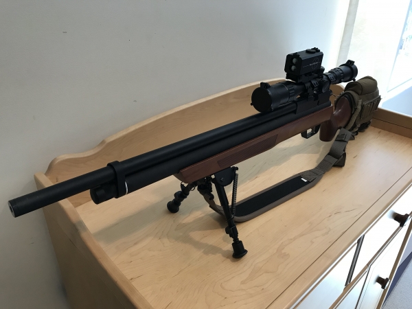

My intentions are for maximum power so my rifle is pushing 31 grain H and N Grizzly's at about 950fps. I get around 10 shots from 3000psi down to 2000psi. And please if anyone wants to fuel my addiction feel free to recommend any other parts. I also have a LE-032 scope mounted range finder on top of a Sniper 3-9x32 scope. I'm thinking of getting a screw on LDC because it's a little louder with the hill valve. and If my bank account is up for it I will top it off with a boyds stock. here are some pics of the rifle with the grouping at 50 yards. I'm open to any advice and feedback.
