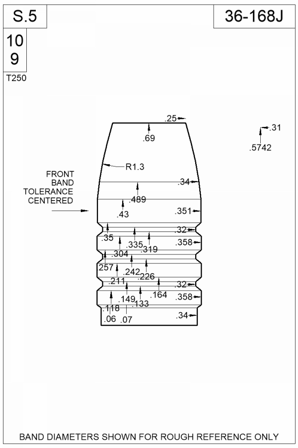

I designed this new .357cal 94gr bullet for my Winchester model 70-35.
I sent the design to Tom at Accurate Molds and ordered a mold from him last Thursday. The mold arrived today and I made a sample casting run and sized samples to .359, .358, .357, .356, and .355 with past experience with the rifle telling me the .357 would most likely do the best. That held true in some shooting across the chronograph indoors at 15 yards.
After that testing I still had the lead pot hot and full of molten lead so I went to town casting my new custom bullets from design to shooting in a week!!
Here is from casting this evening. 10.8 lbs of bullets==800+rounds
Hopefully I will get these sized and get some outdoor range time this weekend.
