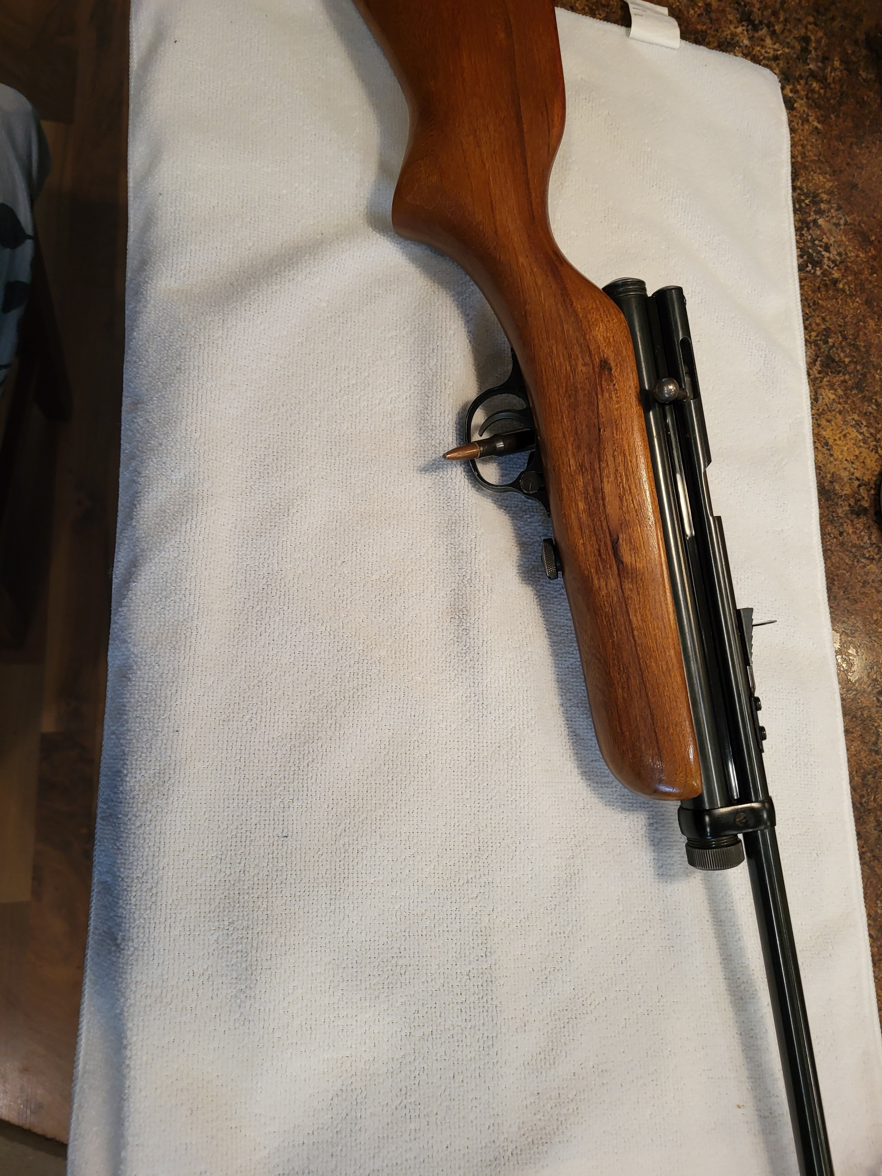

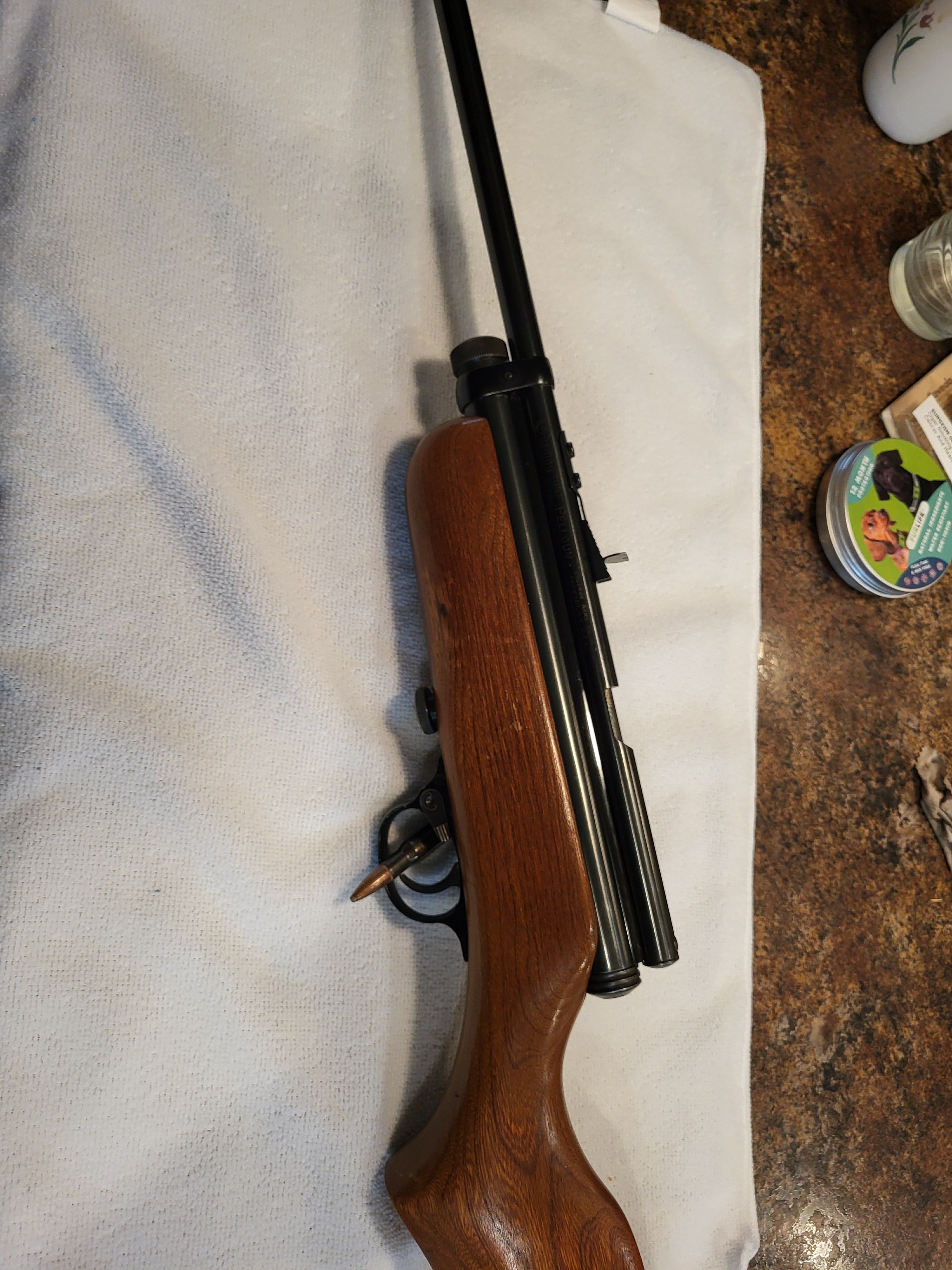

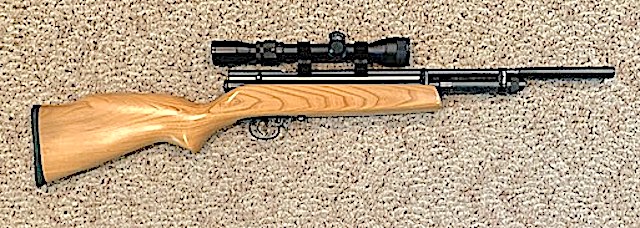

A few years ago, I heard about a guy in California who had available some 8-inch Co2 tube extensions for these units along with a 45-degree angle bulk fill connection that would allow one to convert these units to bulk fill Co2. I decided to order 2 of these and add some scopes using 'Ron Robinson" clamp on scope mounts (excellent mounts) purchased two, 2x7x32 AO scopes and the custom upgrade began.
After a complete rebuild internally and installation of the upgrades mentioned, (NOTE the barrel band must be moved forward to support the ext. tube) I wound up with two accurate short compact powerful C02 Rifles. The weight of the rifles increased to 5 lbs. 8 ounces afterward, but that assisted in off-hand shooting in my opinion, but they still had the compact AOL of 34 inches as a bonus an increase in both shot count and velocity was observed.
The 180 moved to 600+ fps for 40-45 usable shots and the 187 up to 650 fps for 50-60 usable shots. This was with a 1.5 - 1.75-ounce Co2 fill. The most accurate pellets were the JSB Exacts in both rifles, 187 capable of .660" with a 5 shot center to center and the 180 with a five shot had a .985" center to center grouping at 25 yards.
The effort was well worth it in my opinion, two of my favorite old Crosman's in my collection.
