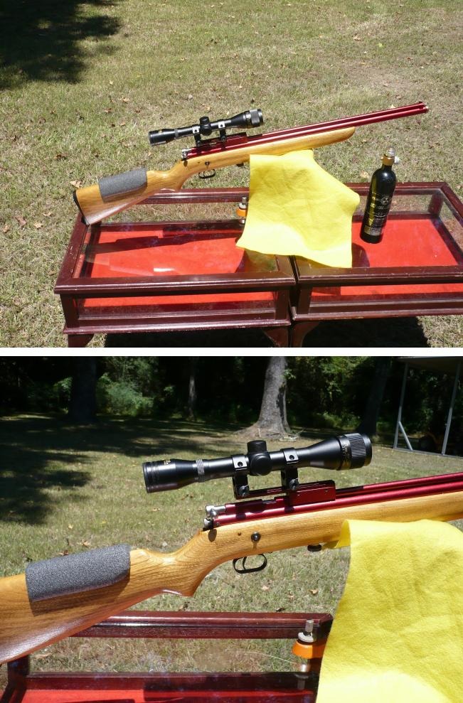

Hello to all;
In 2017, I picked up a Crosman M- 114.22 cal. off of the internet at a very reasonable price, $25(and there was a reason for this low price) the Breech assembly had come completely unsoldered, I could lift it up and see daylight!!! It was also missing a few minor screws, filling head screw plug, rear sight, stock was pretty dinged up, and this was all pointed out in the ad, ““A Classic Basket Case.” I knew I could get any parts I might need, or could not make, from Rick @ Precision Pellet, the rest I could take care of! Rick is one of the real “Gentlemen” in the parts industry for old Airguns. He of course also does repairs; there are a few of these folks. Those of us who dabble in restoring/repairing old Air Guns owe them all a debt of gratitude for their efforts in making parts available for these old units!
After receiving the 114 and evaluating the rifle I knew the first work at hand had to be the re-soldering and re-attachment of the breech to the tube, if this could not be achieved the rest was mute. After a complete disassembly I started the process. I have re- soldered breech separations in the past with success, but never one which had separated so completely! Firstly, I used low temp Solder; with flux and plenty of heat sink in the appropriate place; (one has to be careful in this step to not loosen the internal soldered in-valve component). I cleaned both attachment surfaces really well, placed the tube/ barrel in my mill vice and using c-clamps positioned the breech with a few small pieces of solder placed strategically in between breech and tube and began heating/ slowly tightening the C-clamps until the breech and tube were flush. I then soldered the exterior joint on both sides of the breech and the front and rear. After some cleanup it looked to be good!
I had already decided to paint the tube and barrel assembly, so after reassembling and installing new valve components, this was set aside until I decided on the color and I turned my attention to the stock. The stock had a number of dents and dings but no cracks etc. I started out scraping off all the old finish using a tool with a mount for a single edge razor blade. I covered this before on a post so won’t go into that, it works for me! Anyhow after removing the finish and sanding down the wood I used a heating iron and wet cloth to raise the dent areas and after final sanding left the wood natural and applied two coats of clear Polyurethane. Re-blued all the small metal parts, trigger guard, small screws, polished others etc. and at this point all that was left was to paint the barrel / tube and reassemble.
I was perusing the net one day looking at some old “Custom 38 Buick coupes”, another interest of mine and came across one painted “Candy Apple Red” as soon as I saw it I immediately knew, this was the color for the Crosman 114 I was working on!!! Why was it “THE” color for the 114? I dunno just liked the idea, and so it is! I cleaned and prepped the barrel tube assembly using crocus cloth and after paint prepping set up; used 1 coat of self-etching primer 2 coats of ‘Candy Apple Red” and one coat of Clear Coat (I let it set 1 hour between coats) and let set for 48 hours to cure. Afterwards I reassembled, and charged the unit with CO2, it held with no leaks at breech or anywhere else, Success!!!!!! I ordered a Winchester 4x32 AO scope and an IA scope mount, (I had originally planned on using a peep sight) and at this time installed both. With a fresh charge I set up for a velocity check. I am not looking for “Shot Count” but rather a “Usable shot count” that will produce an average of 600 fps+ or about 11- 12.ft lbs. usually this is in a range of 25-35 shots are there about. The teen series rifles will get 60-70 shots or more on a good charge of course, but the velocity range that interest me is as stated above!! Power adjuster was turned all the way in and backed out 1 turn. I used Crosman14.3 gr pellets.

(Custom Candy Apple Red Crosman Mod. 114 Co2 .22 CAL.)
(“Excerpt from my “CD “(“Old Airguns and Memories”)
Hello to all;
