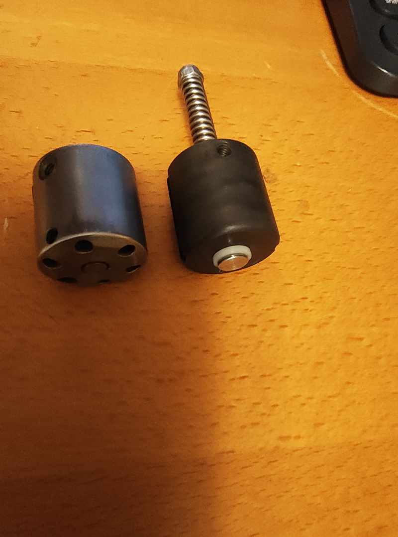

have you looked at these, I do not see a weight, you can give them a call
they also have a no-bounce hammer kit
Contact Veradium Air have both metal and the lite weight hammers for marauders.
Yes I have the SSG they sell, the other two are the stock hammers for prod and mrod. Those are like 4x the weight I’m looking for. Thanks for looking though, I didn’t even notice AGR had hammers for sale separate to the SSG
Be forewarned ... going with Light hammers the use of an SSG becomes less needed and can lead to the requirement of hammer spring to get so heavy/strong that cocking is excessive and trigger loading etc is far from ideal.
