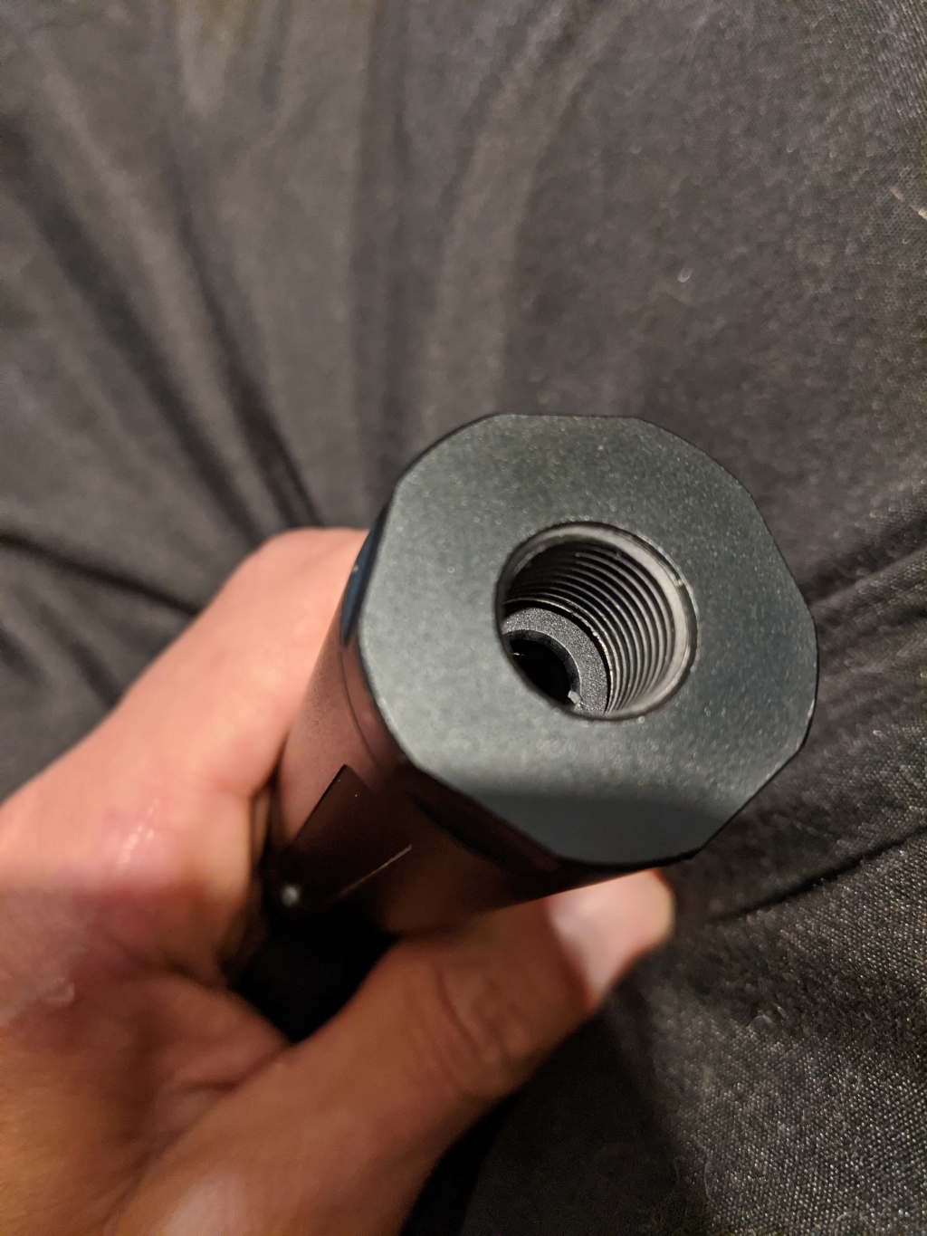

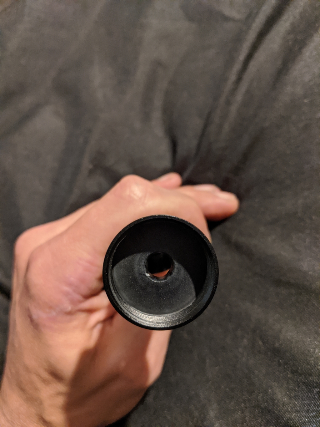

See that gray ring around the first baffle? See how close it is to the face of the muzzle? There is nowhere for that initial blast of air to go, and in my theory it was destabilizing the pellet.
Put it on three different guns and neither were as accurate with it on. I put it in the lathe and bored out the first baffle to muzzle diameter. Fixed it on all three guns. Another issue is the thread tolerance on this are floppy loose. Looser than all the other moderators I've owned.
When I threaded the barrel on my HW100 I used the Tanto for my fit check, since it was going to stay on it, and none of my other mods will even go on the threads.
Putting an oring between the moderator and barrel face will destroy the only thing that keeps the moderator square to the bore. The interface of where the rear of the moderator meets the square face of the rear of the threads ensures all is square. Loose andfloppy threads can cause a loss of concentricity. Hence the reason for fitting the threads to the Tanto when I cut them in. Later on if I want to use a different mod, I'll have to chuck the barrel back up and cut them deeper to fit the new one. IMO it's the best way to make sure everything is lined up the best it can be.
