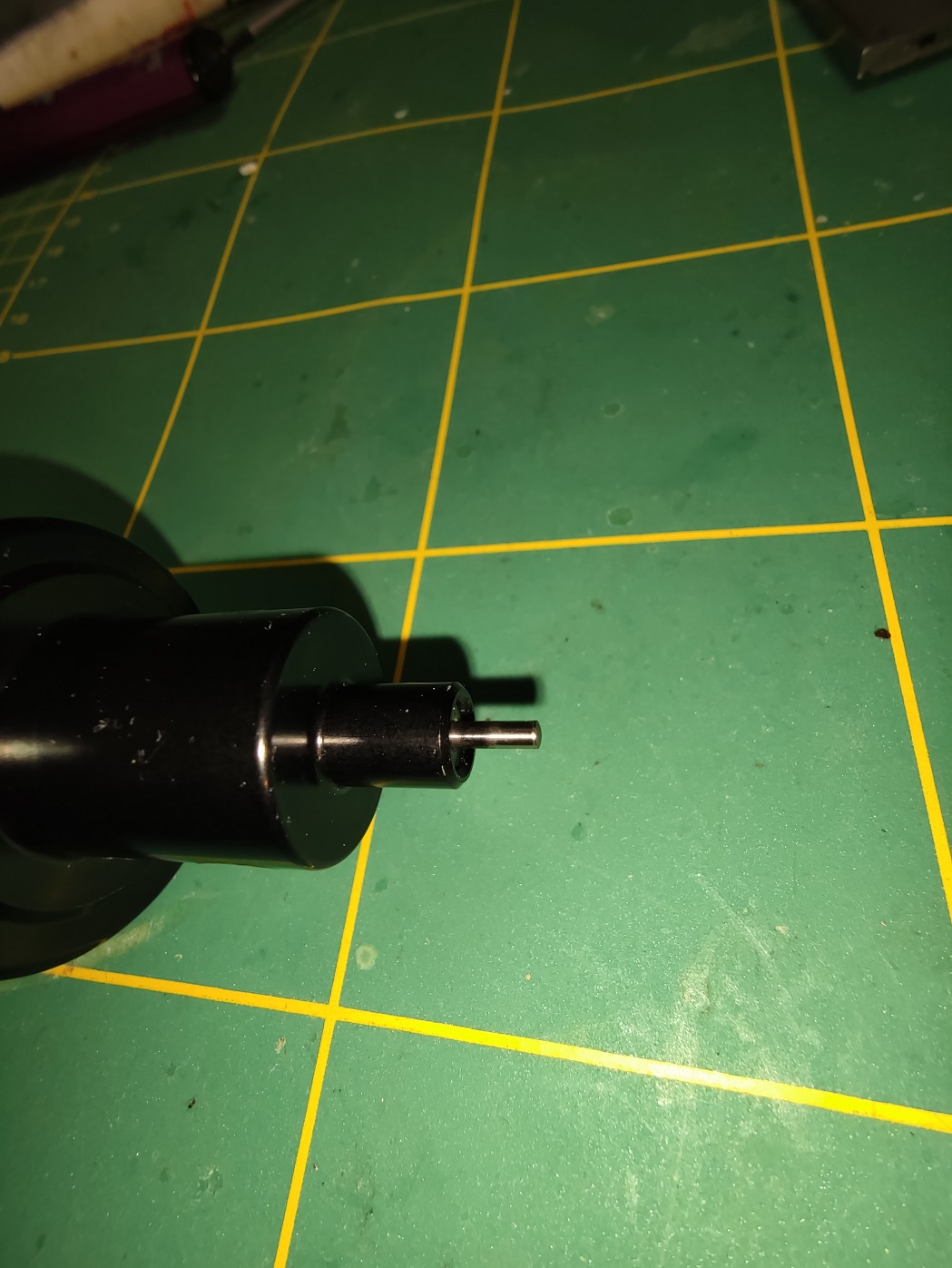

The part of the valve pin that come out of the,,,, eeem plenum pipe in the vulcan, and as i see it pretty much most CZ made airguns CUZ i feel they are very much alike.
Well that part look as small as it have always been, i think the travel are only like 6-7 mm at most, the hammer hit a stop so it do not crash into the part the valve pin come out off.

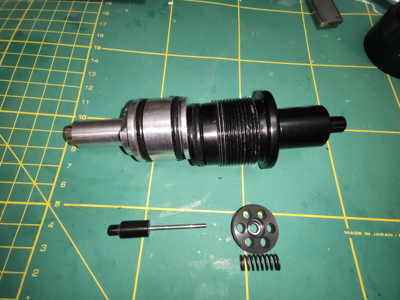

I will take it apart soon ( 10 in the evening just about ) but i can degass it and look around, maybe snap some pics to share.

I have just dismantled the rifle and breech O-ring seem OK, and silly me i thought i had a repair kit for the vulcan 3, but NOPE i do not have that, so online shopping in 3-2-1
I am able to blow thru the regulator, with the little pressure i can make with my one lounge, so there is a hole thru it alright, when i screw on the airtank ( tank with FX 1 way valve, so the pressure go up at once the bottle valve open and then i think i can hear the regulator regulate, just like you can hear in between shots shooting my Maverick.
