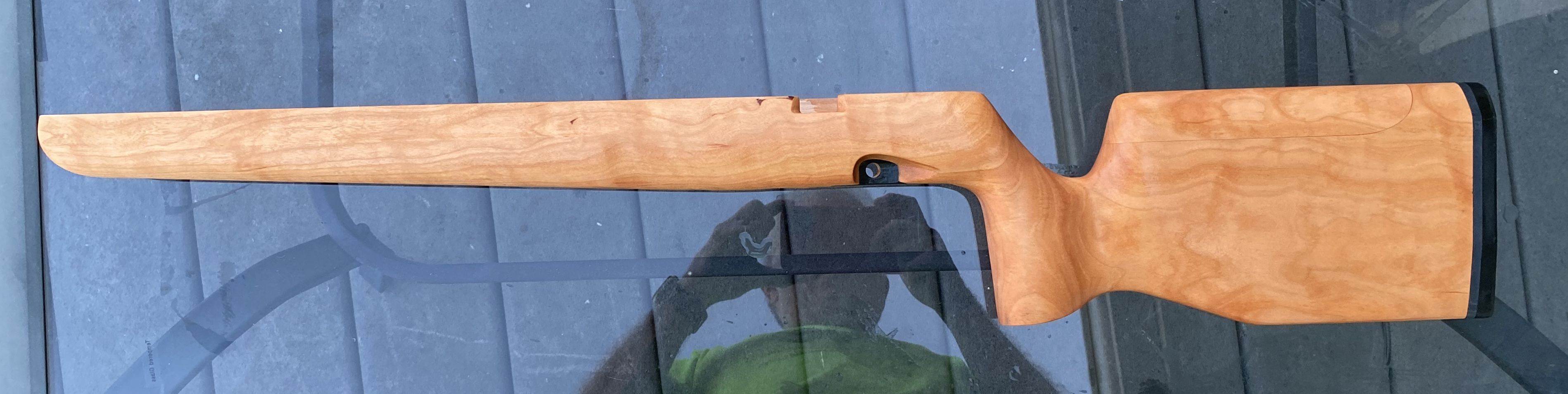

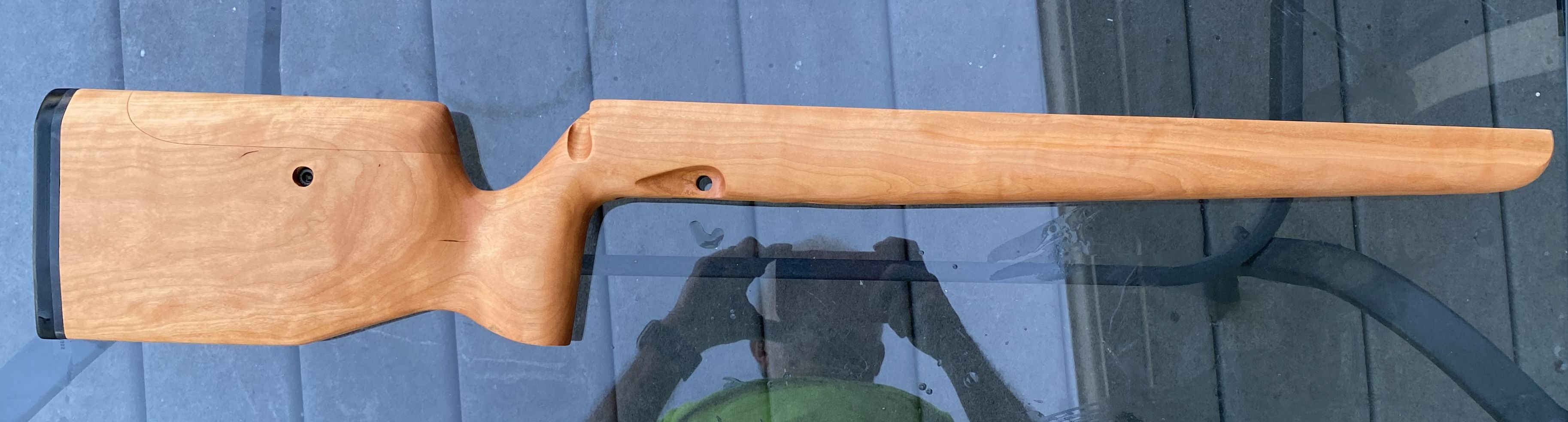

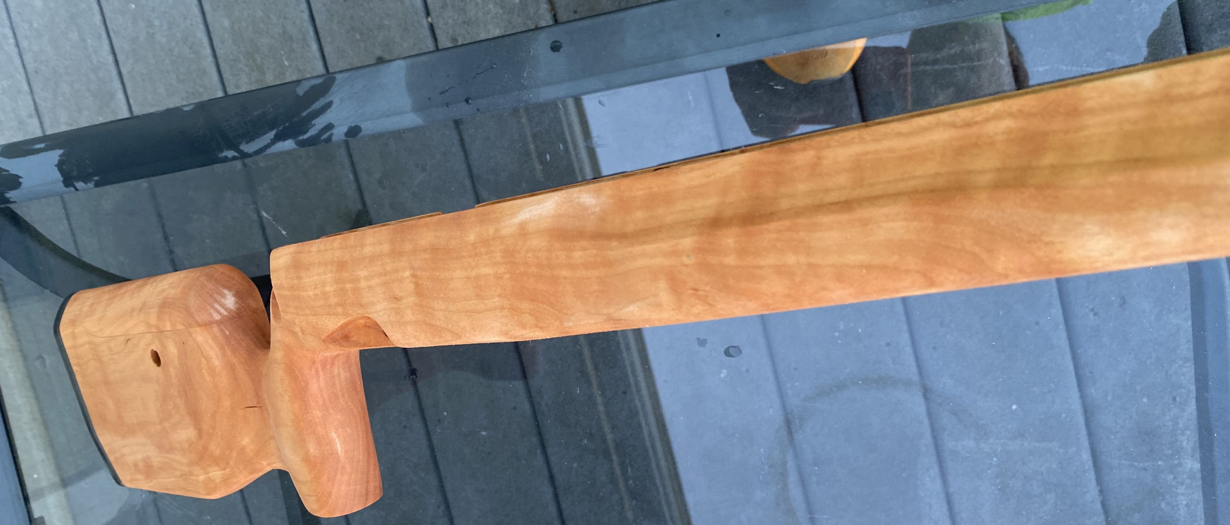

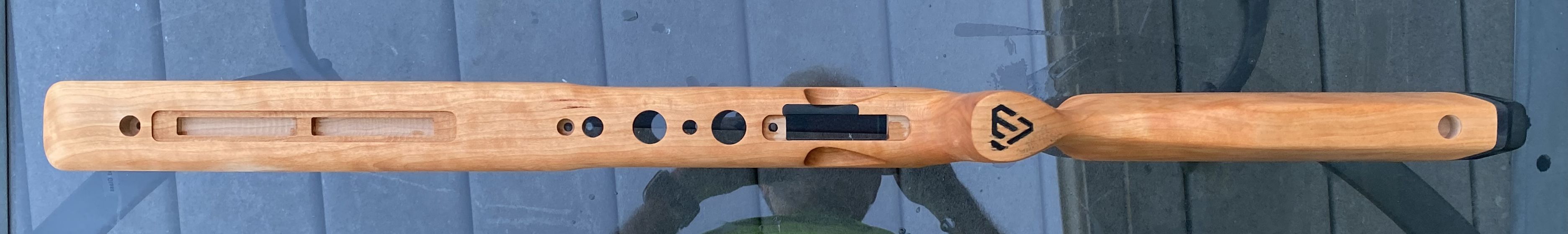

Curly Cherry For The Barra 250Z

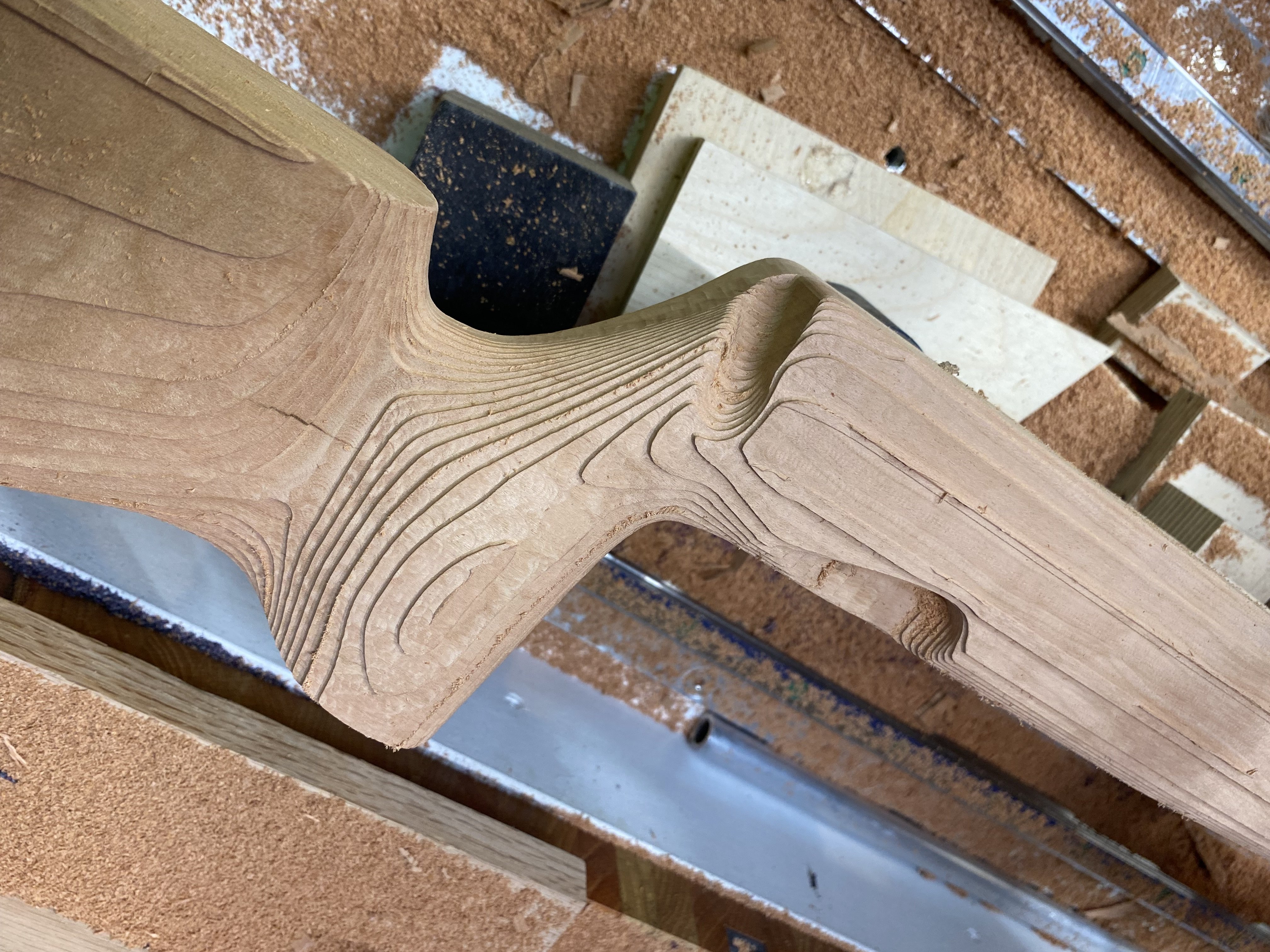

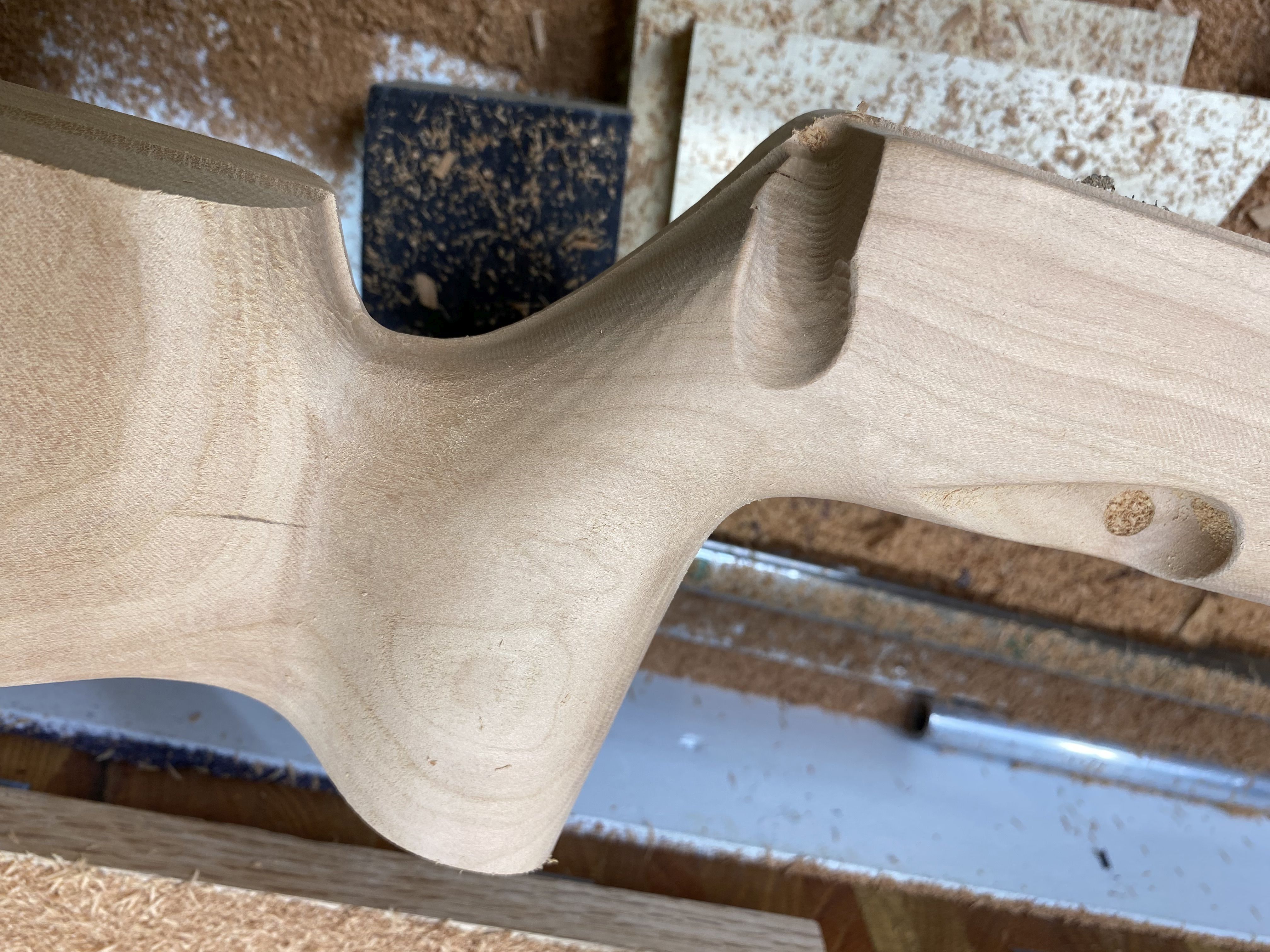

First round of sanding down. Wiped down with a wet towel to raise the grain before more sanding tomorrow.
