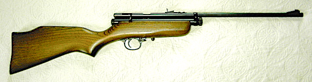

1960s vintage Crosman 187 Co2 rifle.
And after-

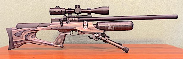

Converted into a world-beating Field Target pistol, capturing three National Champion and three State Champion titles (to date). Tools used to chop and recrown the barrel were a hacksaw, sander, grinder (with buffing wheel), and a rotary tool with tapered (rubber) polishing bits.

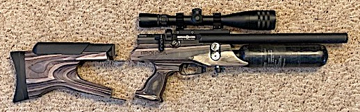

.22 Brocock Sniper XR.
And after-
Turned pistol/carbine convertible with the same tools and techniques.

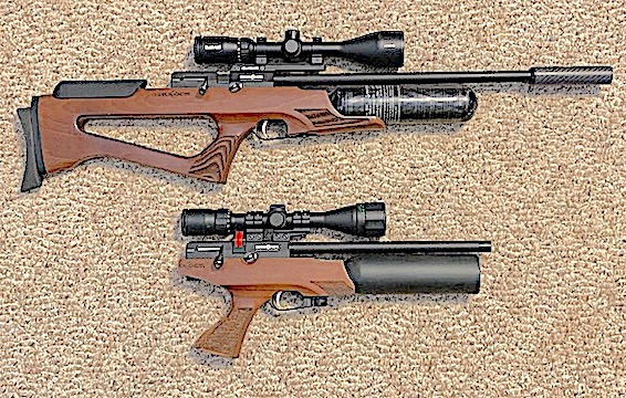

Brocock Bantam HiLite rifle and pistol-conversion. Same tools and techniques.
All shoot as well or better in pistol-conversion form than they did in original rifle form.

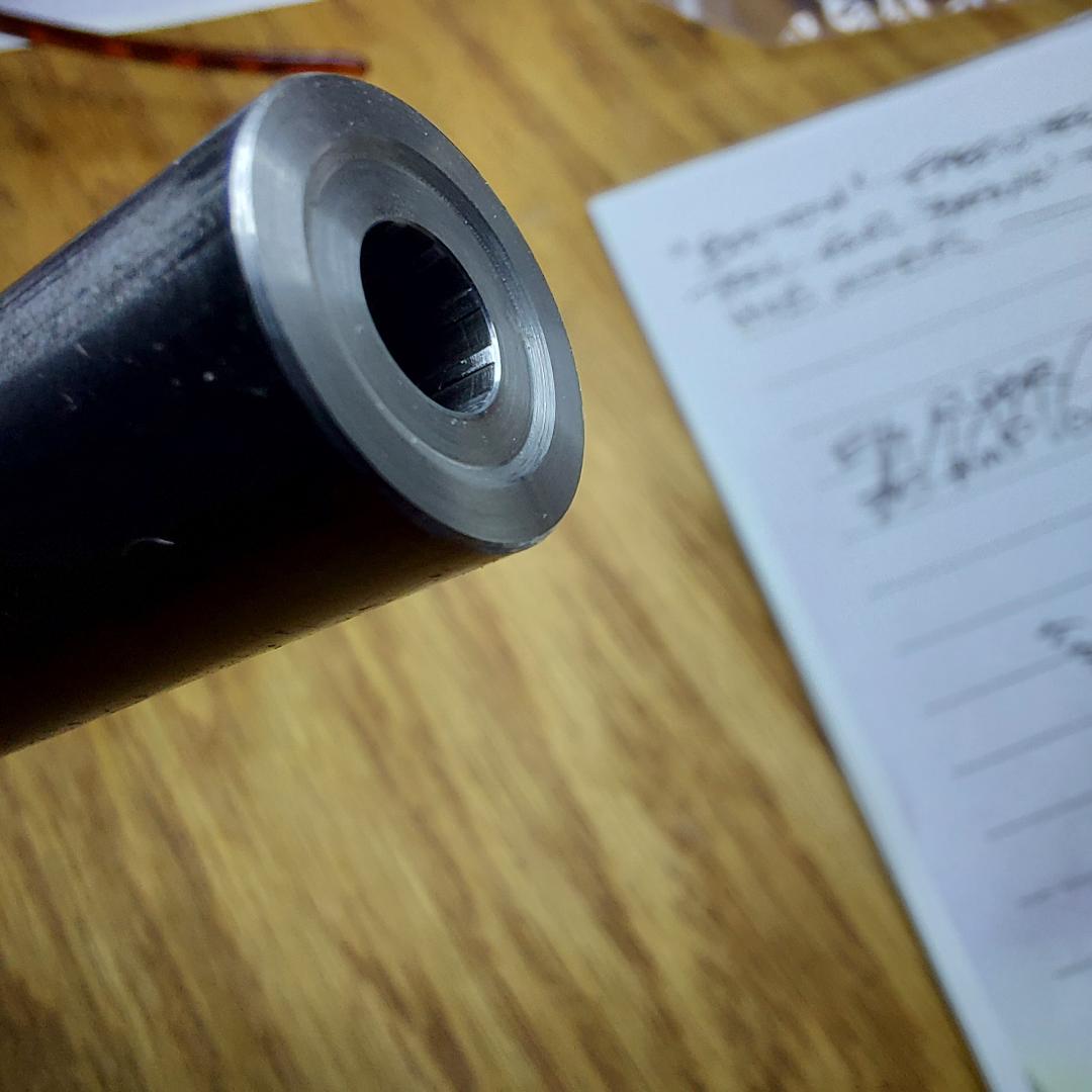

Nicely done! I happened to have an 11* chamfer tool in my empire of dirt that works well enough for crosman stuff. I like your method too.
