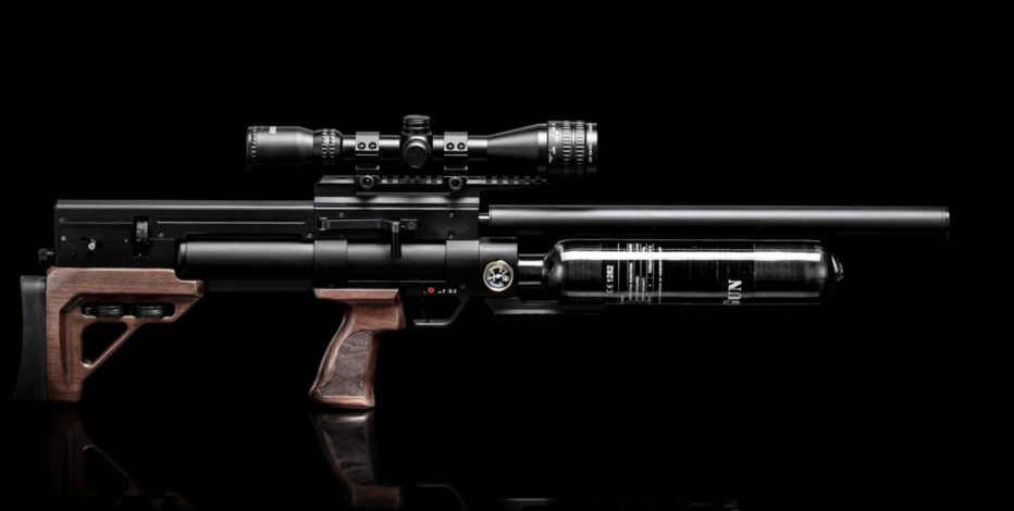

Forward to today, my coyote hunting config consists of either the 600mm TJ shooting the orignal 62gr in (BHN 8.5) at 955 and this 700mm Heavy shooting the NEW style 62gr in the standard/softer alloy at 1002 (BC 0.144). My 600/.22 barrel has been setup to shoot 40gr Griffin 2S nose RBT (currently at 957 / RA4 BC 0.163) for NRL22. I can push it harder with a heavier sprint, but it's still not making nearly as much power as it was in my Taipan "Supervet" rifles, which shot them at 1140FPS/600mm). That said, there are many advantages over the Taipan with this Mav (side lever, high cap mags from Midwest Elite, etcetera. The K&L chassis also makes it fairly bombproof.

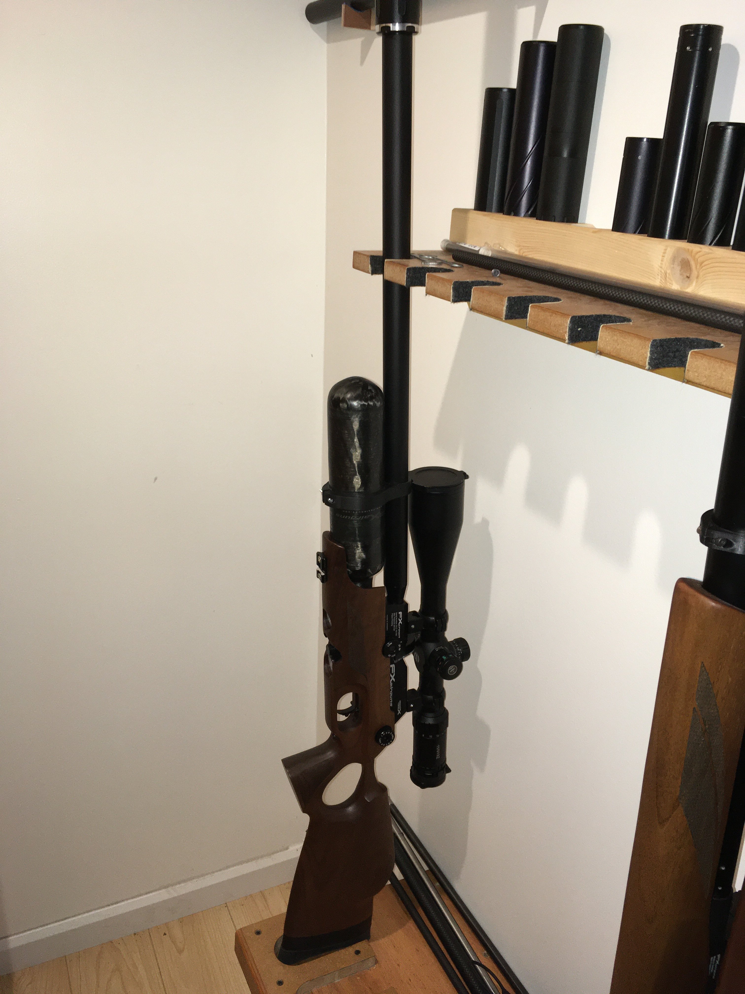

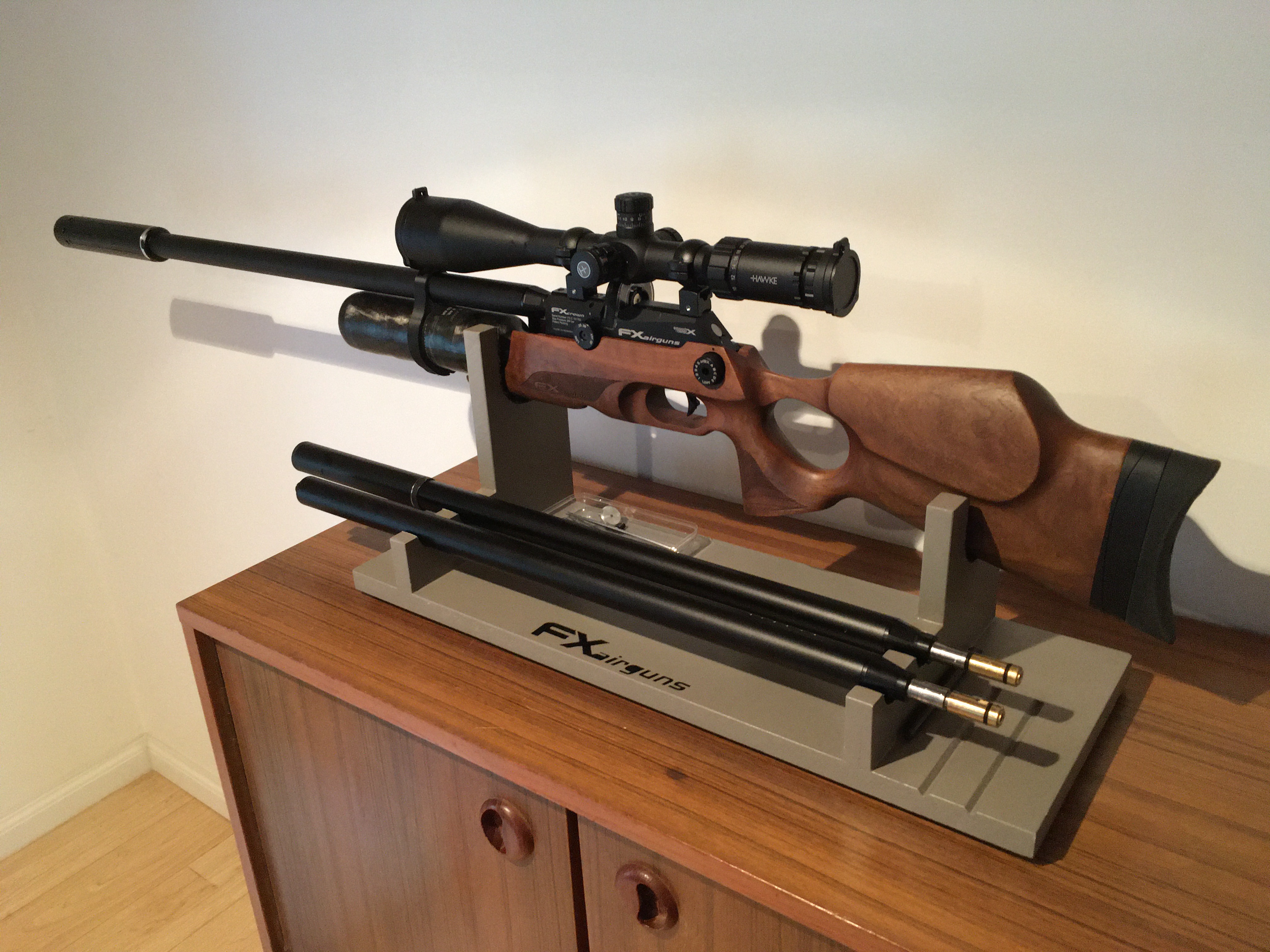

I understand your explanations , madeintheuk , and you are right on that point . If you don't "touch" the barrel there is no reason for POI to shift . I just notice that , when I take the gun from its rack , most of the time I have to re-zero it. The Crown stands up right in the rack , that means the shroud supports a little pressure . Could be the reason of the problem ? Possible. I built an horizontal support to see if any difference is can be noticed. Maybe a shorter barrel , 380mm could help too. I really would like to fix this problem; the Crown is a pleasure to shoot regarding the action smoothness , ergonomics , magazine...
Below are the pics of the two stands.

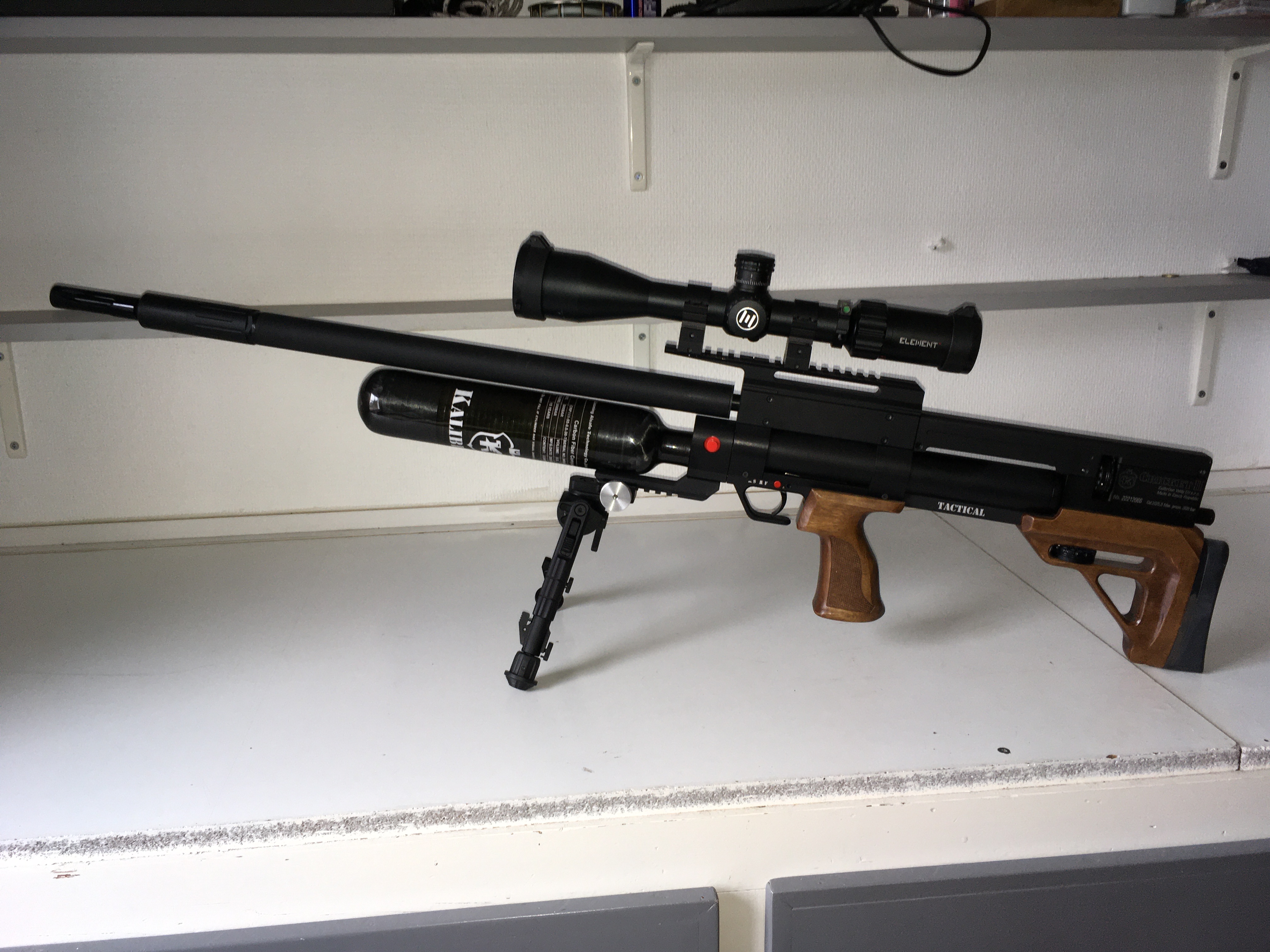

You can't be wrong with the Kalibrgun Tactical . I get five Kalibrgun , love them all but the Tactical 60 in .22 is my favorite. Accurate , consistent , very well built . POI shifting problems simply don't exist with these guns . I saw the video from Steve about the .30 and , as he said ," Take the gun out of the box , load and shoot it . " It's that simple . :giggle: .
Here a pic of my gun . Just put a small Huma moderator and an air stripper .
