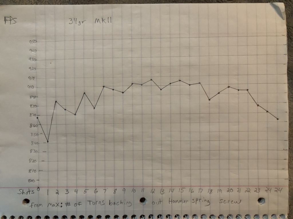

So I decided to see how good the factory tune on my Continuum was. I recorded hammer spring adjuster measurement (16.4mm) I then maxed out my hammer spring.
I setup the crony and started shooting and backing off adjuster each shot. So here is my graph. Where would you guys turn the adjuster back too? Looks like it was real consistent from shot 7 to 17. Any advantages to being closer to one end or the other? Is 17 about at the “knee” or is it at shot 22?

Try 12 and see how consistent it shoots there. Being a bit behind the curve isn't bad either. (10) either way, if accuracy and consistency is there... It's all gravy. Can always listen to the shot, too. That'll give you some feedback, too. Generally a balanced tune is a good bit quieter (on the muzzle end) than if it wasn't balanced.
As always, field results are what we want.

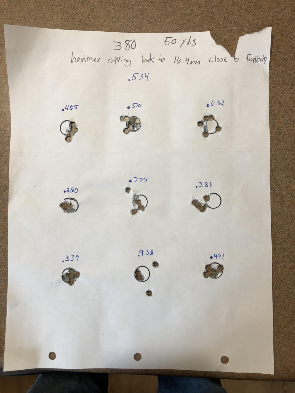

It looks to me that the factory setting would have landed at about 13 or 14 which looks like it was right in the middle of that nice plateau. It appears it was in a pretty good state of tune from the Factory. I think as long as your in that range you’re good. I may test within that range but for now it seems happy.

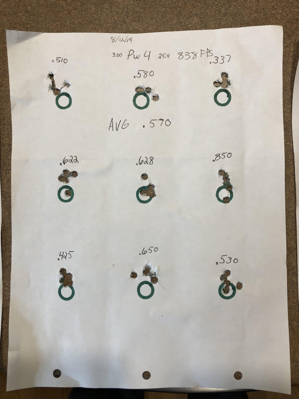

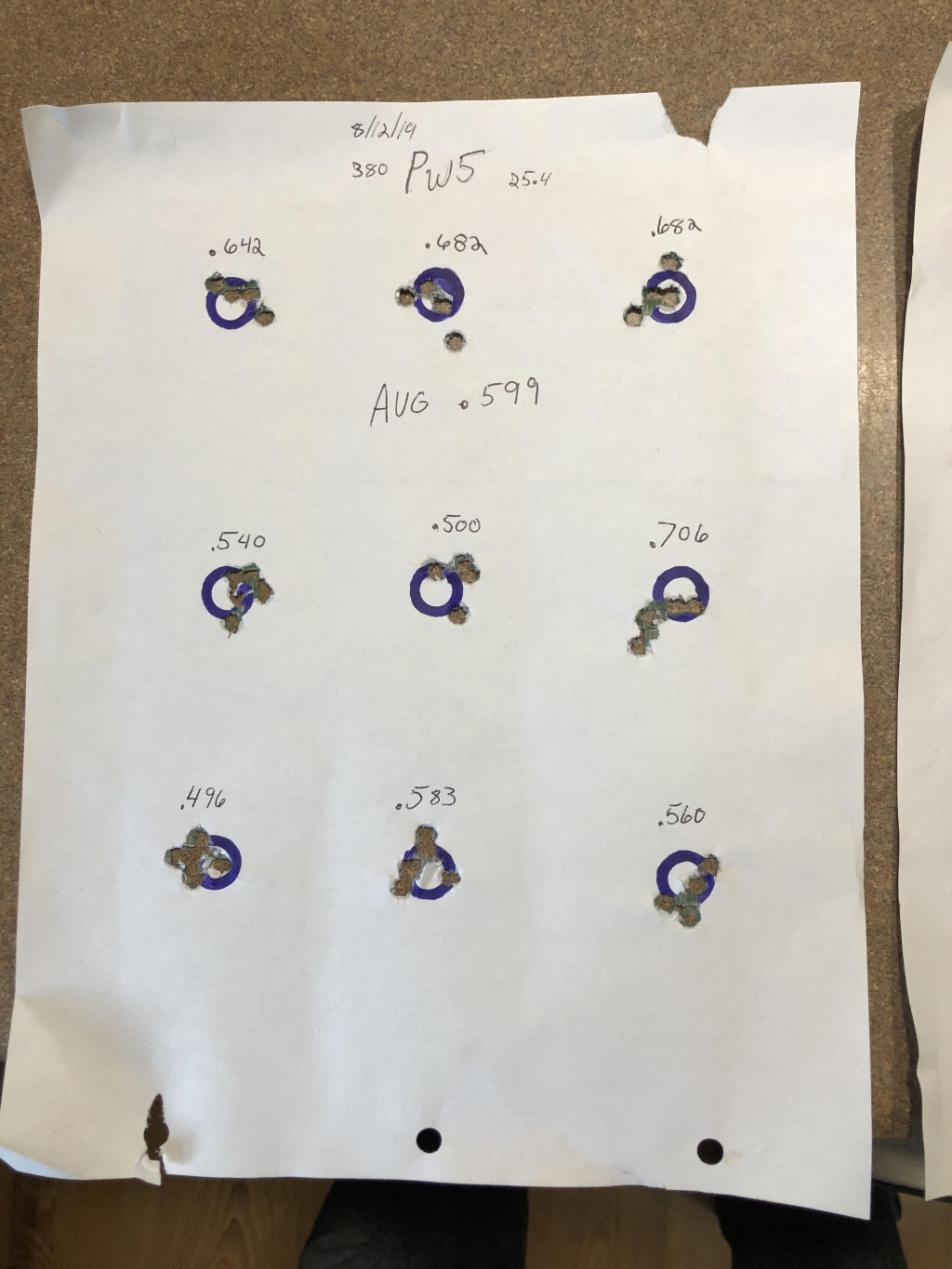

Tested a bunch of weight and sorted MKI’s and MKII’s w/700mm. This “A” pellet liner did not impress with either. 1.25” groups at 75. I then shot 10 5 shot groups w/25.4’s which this liner was made for, a little better but still not great.
To be sure I didn’t mess up I put the 380mm back on PW 4 zeroed and shot a .600” 5 shot group at 75yds. So I shot 10 more 5 shot groups for an average of .841” same kind of groups it was shooting on factory tune. Pellets straight from tin. I’m going to sort some and see if we can shrink even further. Pretty happy with this 380 liner.

I was a little confused about the graph at first too.
I tried a few shots at 0 on the graph, “hammer spring adjuster at “Max” and there is no consistency from shot to shot. That’s why you have to keep slowing backing it out 1/4 turn at a time until you start to see it flatten out.
I don’t think you will see any consistency in the 1-7 range no matter how many shots.
I’m still testing but I’ve adjusted it to “11” then up to 16-17 and now I’m back to about “13” 16.4mm which is pretty much right at the factory setting. It’s shooting it’s best 50yd groups with the 380mm here. Groups were really pretty good across the whole plateau.
I’m shooting 9 5shot groups and was averaging .560” - .600” and on the current setting .534 and if it wasn’t for a couple flyers on one group out it would have averaged .481
