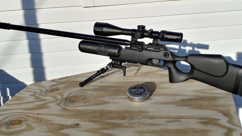

Crown MK2 in synthetic stock-
Tune: Regulator at ~165 bar, Hammer Spring pre-tension screw 2 quarter turns from max. I didn't change these settings, only the Transfer Port(TP) and the Power Wheel(PW) dials.
380mm Superior liner shooting-

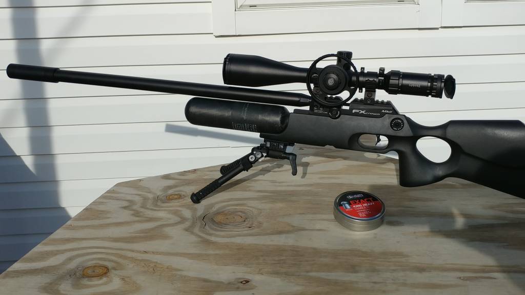

700mm pellet A liner shooting-
JSB 18g @ 878 fps: TP-High, PW-1
JSB 18g @ 675 fps: TP-Low, PW-5
and 700mm pellet A liner shooting:
FX 16g @ 886 fps: TP-High, PW-Min
FX 16g @ 686 fps: TP- Low, PW-5

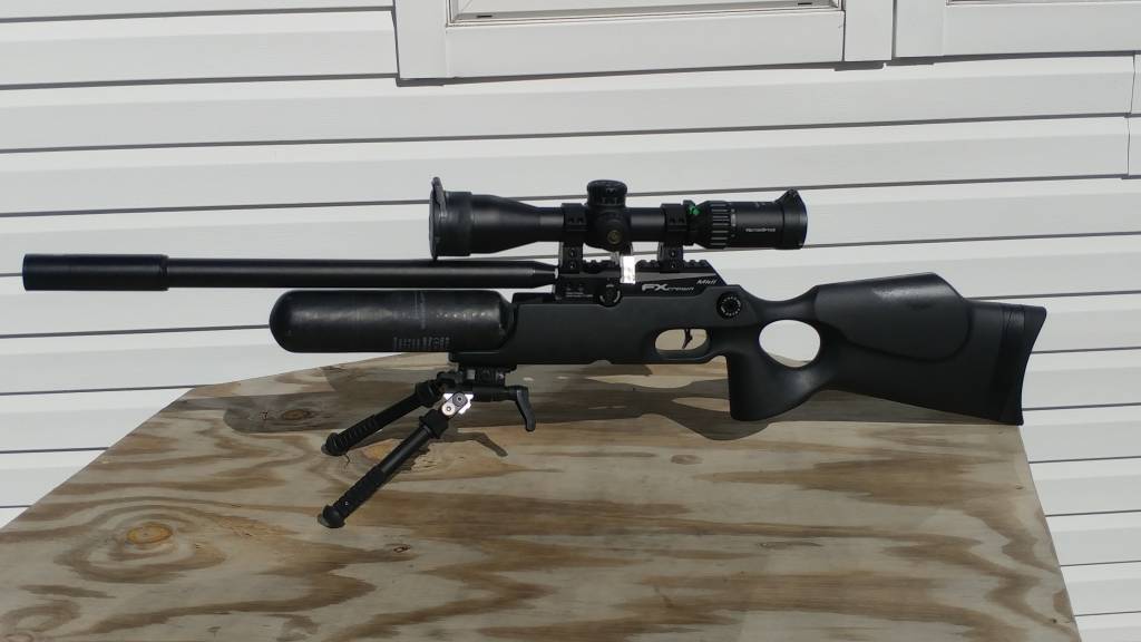

.25 380mm pellet A liner shooting:
JSB Kings @ 884 fps: TP- High, PW-B
JSB Kings @ 698 fps: TP- High, PW-Min

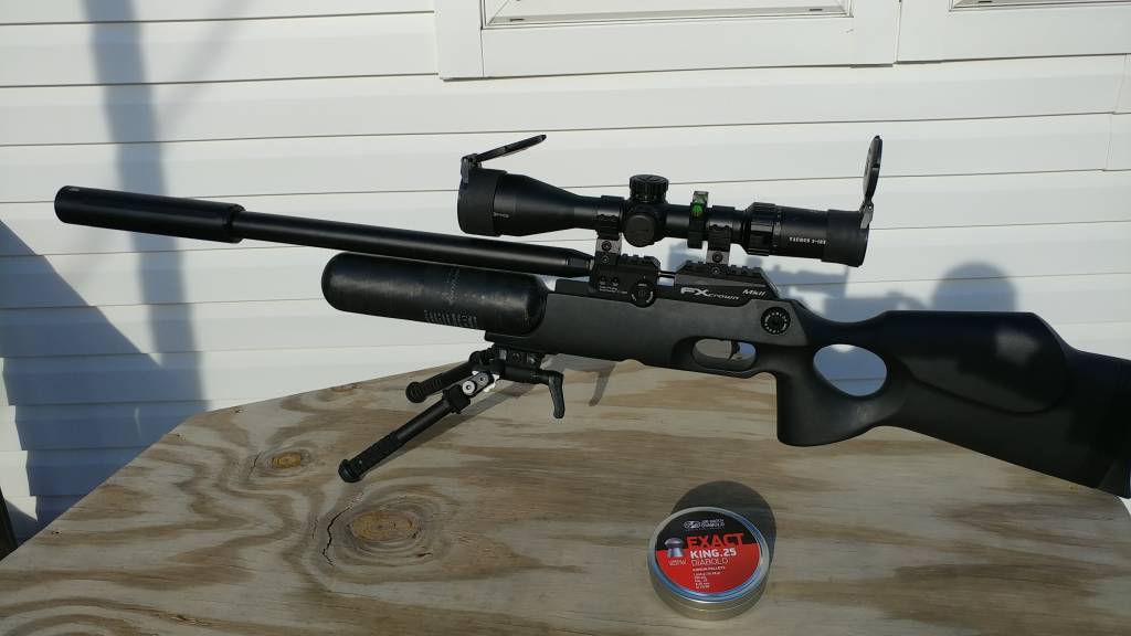

.25 600mm Superior liner shooting:
JSB King Heavy MK1 @ 912 fps: TP-High, PW-5and a half

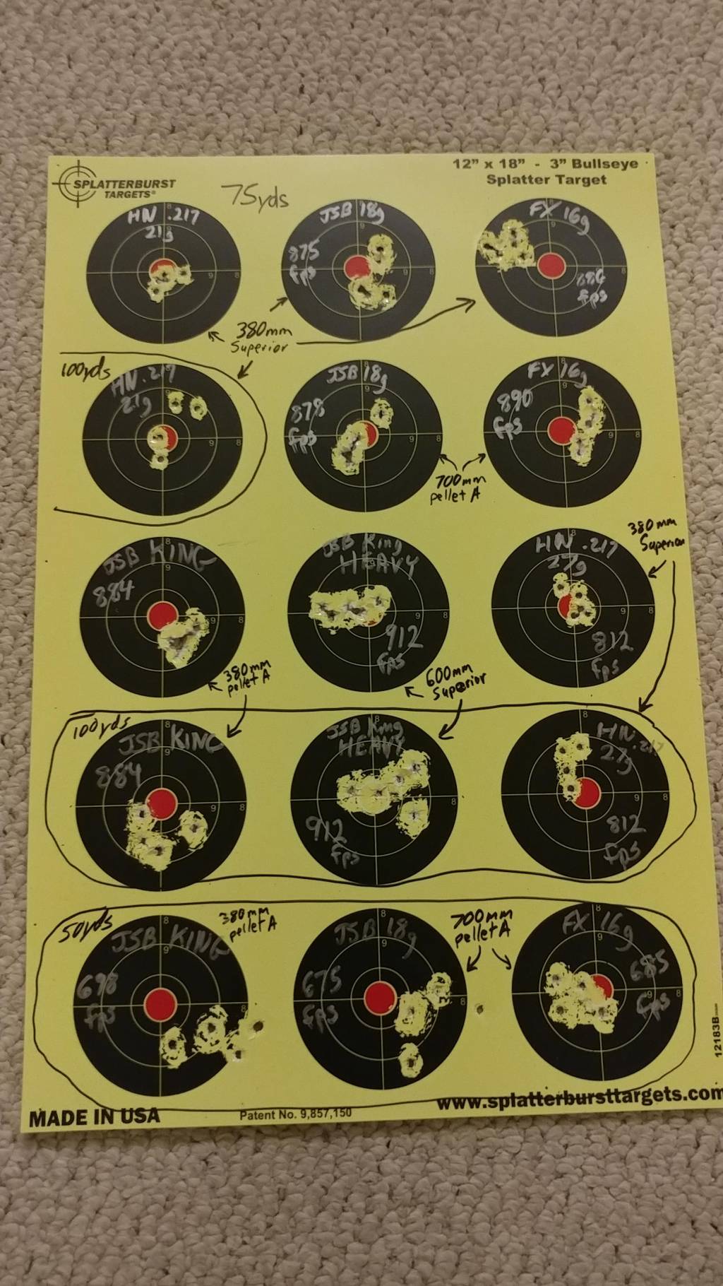

There is a lot to take in on this target and I did my best to label it. I started with the 380mm Superior barrel shooting .218 H&N 21g slugs in the upper left corner at 75 yards. The last group I shot was directly below the upper left, back with the 380 barrel and H&N 21g slugs again. I switched out barrels/probes/scopes and shot this target in less than an hour. In general, I shot the targets from top to bottom and left to right, although I did skip around a bit.
I have range cards on each barrel/scope combo to assist zeroing. I fired 3 shots to "season" barrel in between ammo changes and took a few sighters to verify POI at given distances. I shot with an FX chronograph on the barrel. It wasn't the point to try to get ABSOLUTE accuracy out of every setup. Just wanted to demonstrate the ease and speed of switching speeds/barrels/calibers with the Crown, and being "in the ballpark" very quickly.
I originally intended for all shots to be at 75 yards, but there was a 4 to 8 mph headwind and I didn't think I could hit the target at 75 yards with some of the low powered ammo, so I moved the target to 50 yards. Conversely, I moved the target out to 100 yards for some of the higher powered ammo.
