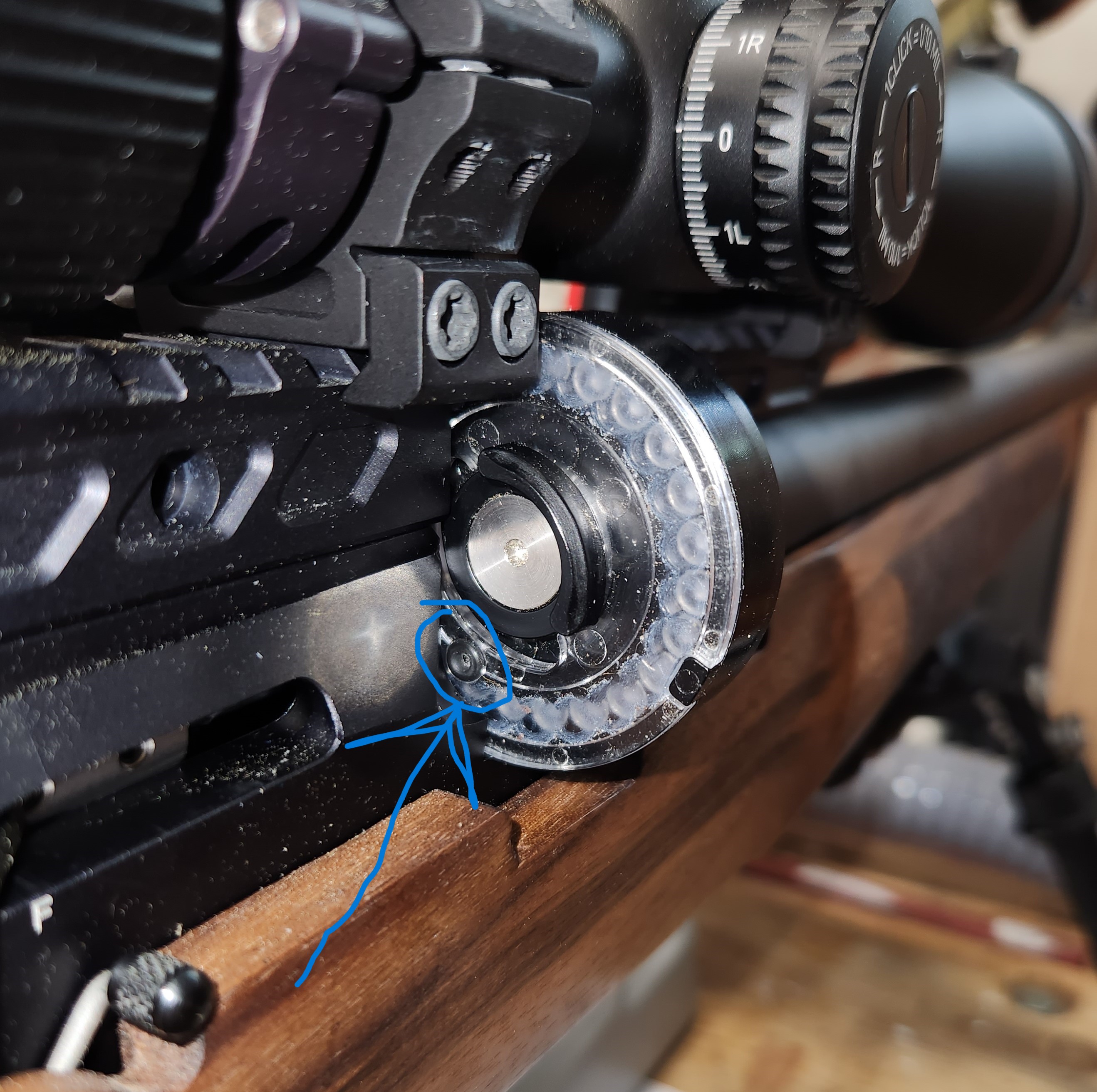

The old ones just tend to fall out of the breach - the culprit is that the location of the o-ring on the older mags is in a position where it never engages with the DRS block (see picture below. The magazine is fully inserted in the picture and the action will cycle. It is just too loose and wants to slide out.

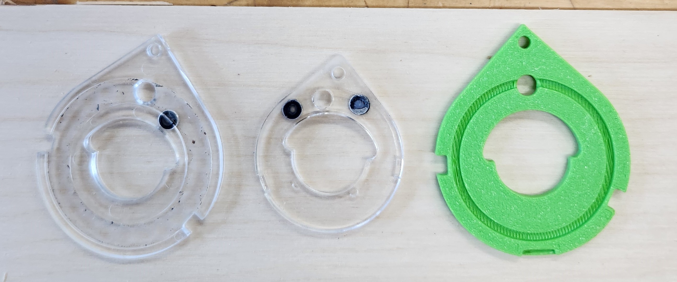

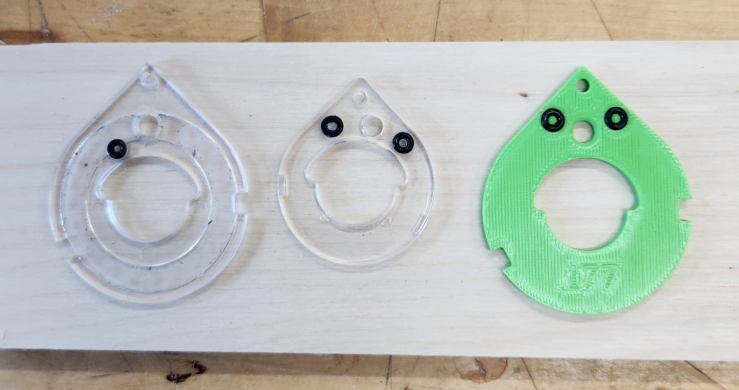

My solution was to 3D print some new magazine covers with two o-rings in different locations. Below is a picture of the old mag cover, the Mini mag (which comes with the DRS) cover, and my 3D printed cover. Note the position of the o-rings.
These positions allow the orings to engage the block and hold the magazine securly in place. I also modified the underside as I don't need the added depth for long pellets that the circular grooze in the old mag cover provides. However, I did need to put in a small groove as there is a small pin on the rotating piece in the mag that sticks up and makes contact with the cover if there is not a groove. See my last pic.
I did the drawing in Sketchup Pro, coverted to an STL file then printed on my Bambu P1S. If anyone wants the files I will be happy to share them. Just reply to this posting and let me know what file type you want.
