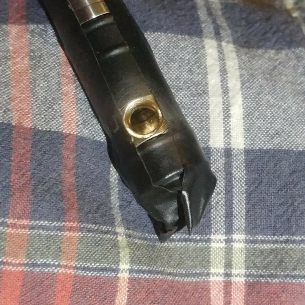

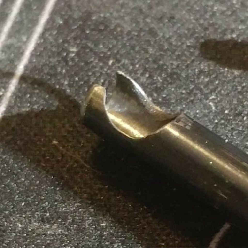

My continuum 700mm has been tuned by me to produce 65+ FPE in 22 caliber 🤷 I'd say that's plenty to push slugs. The 700mm barrel has little or no droop. 380mm barrel with no thread protector weighs 9.5 Oz vast majority of that being centered in the reciever. 700mm is 14.6 Oz. Not a huge difference. But you don't want to put a heavy moderator on it. I use one that weighs about 4.5 Oz
Tuned in what way? Just the adjustments already there or did you have to modify things?
Ported barrel inlet, ported probe. Ported VS to 5.8mm, 7gm hammer weight
