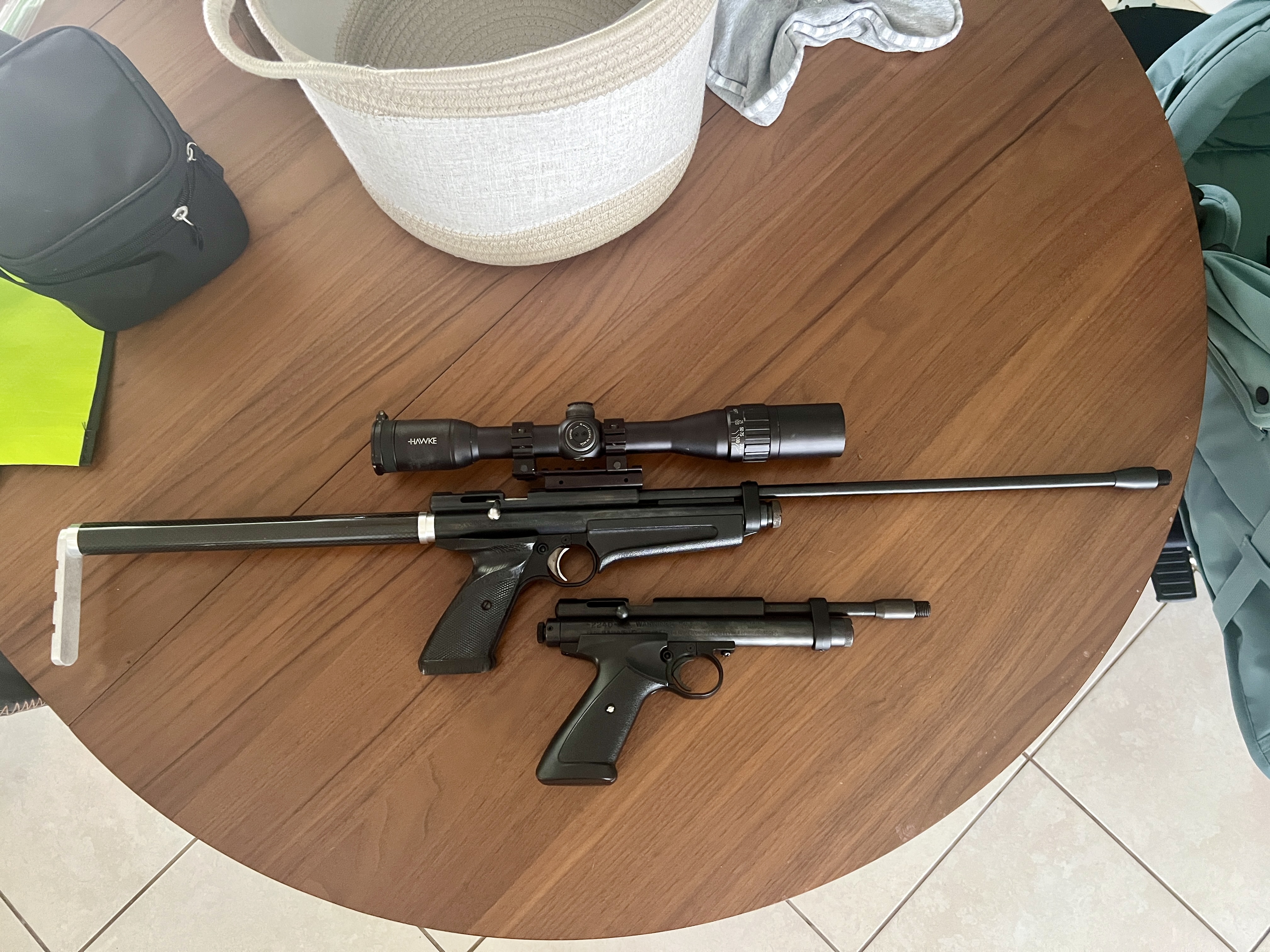

I put in one of the larger transfer ports and it did well with the 16” barrel I use. I pieced together my 2250 build, it’s not a factory 2250.
