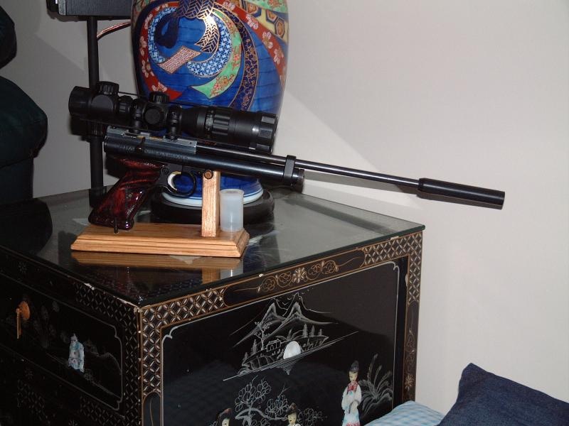

I've built quite a few myself and they will end up in the $300 range, depending on where you source parts and your hands on skills. My 2240 is currently set up with a 1720 177 barrel and shrouded with 8 baffles. It's quiet as a mouse fart, stacking cheap pellets out to 35-40 yards, and is doing 11 fpe for 100 shots on a 250cc bottle with 4000 psi fill.View attachment 332516
If you don't mind me asking where did you get the shroud for the barrel? Did you make it yourself or is there a company that makes shrouds for these. Also are there any shrouds for the .22 barrels?
I made it from a kral np03 shroud and front cap, a rear end piece from a TKO moderator, and an Mrod air stripper with 8 baffles.
You can get Mrod shroud ends, air stripper, spring/baffles, and a shroud. Cut it down to the length you like, and just pin the rear with a set screw or have it re threaded. The parts will fit the crosman barrels, theyre 7/16" OD
How can I PM you I have few more questions? I can't find the option anywhere. Will it let you initiate a PM with me?
