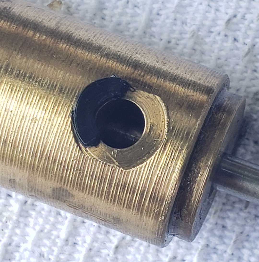

Bingo! Time to order seals unless something like this can be found at the hardware store!
Way past time for a reseal. The valve O-ring will probably crumble into little pieces when you go to replace it, and that will be your confirmation as to why it leaks down.
The pump cup might be okay or might not...sometimes they just relax over time and lose firm contact with the tube. Storing it with a couple of pumps in it can help keep it formed. But since you need to go in anyway, it would be best to go ahead and install a new one.
Will these do it?
