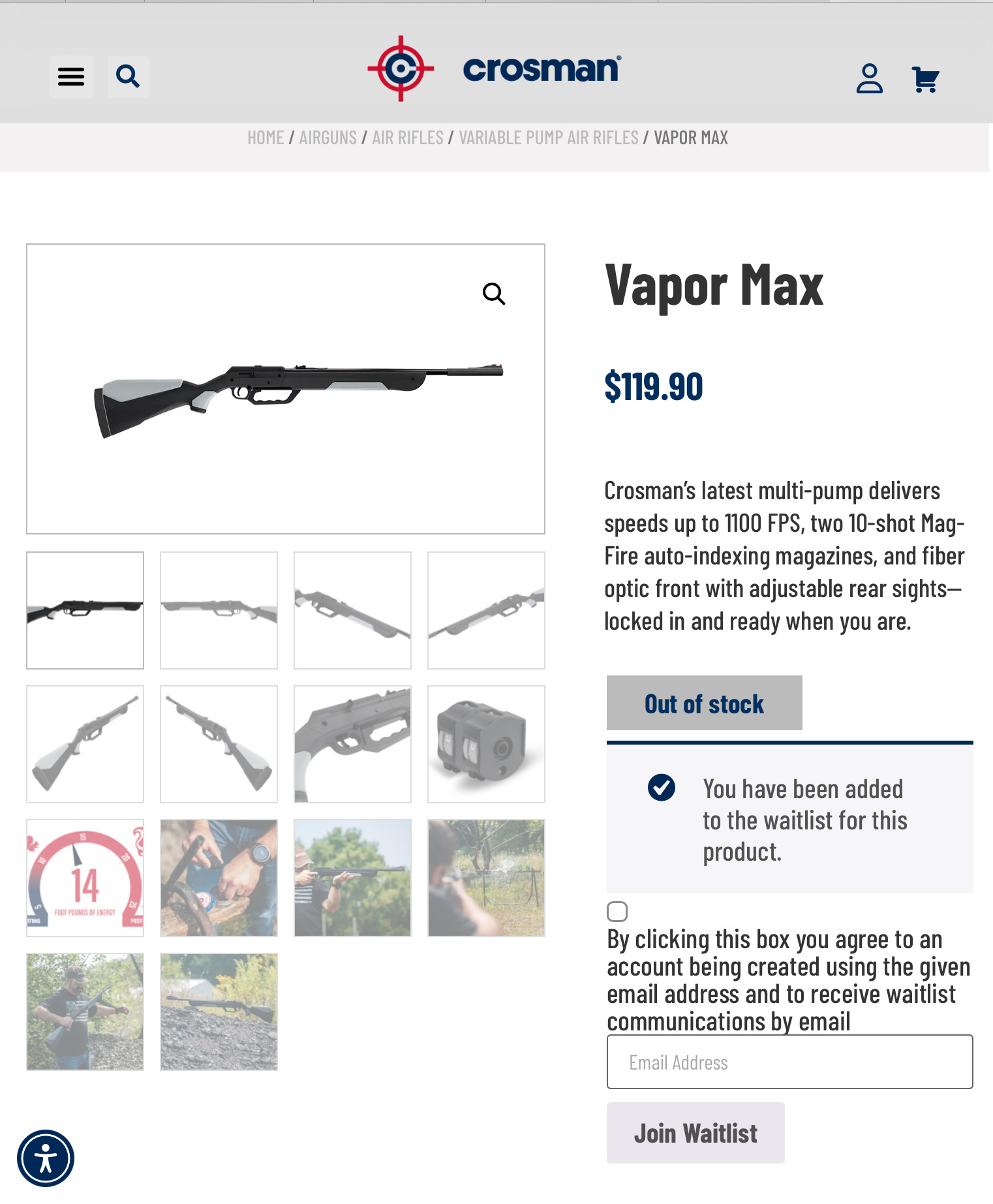

The main reason I purchased the Vapor Max was its looks. Normally, I put function ahead of appearance, but in this case, aesthetics won me over. The two-tone stock, in particular, caught my eye. The ads showed a brighter contrast than what I actually received; the lighter panels appeared much lighter in the promotional photos. In reality, the gray-and-black contrast is more subdued, and while not a deal-breaker, it was a little disappointing compared to my expectations.
Power (14 ft-lbs?)
Beyond appearance, the next big draw was the advertised power—14 ft-lbs in .177 caliber. That’s impressive for this platform, and in my testing the rifle lived up to the claim. Using Crosman Hollow Point 7.9 grain pellets, I recorded the following five-shot string: 898, 896, 894, 896, and 894 fps. That averages out to about 14.07 ft-lbs under conditions of 82°F, 78% humidity, and roughly 75 ft above sea level.
Confession: I did push past Crosman’s recommended 10 pumps and tried 12, hoping to break 900 fps. Instead, velocity dropped to 853 fps. Lesson learned. Later I realized this is because the design doesn’t use a hammer system, but rather something similar to Daisy’s 700 series match pistols—modified with a check valve for higher pressures.
On three pumps, the rifle averaged 602 fps with the same pellet, which is plenty for casual plinking and very easy to pump at that level.

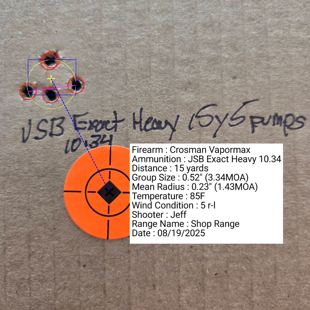

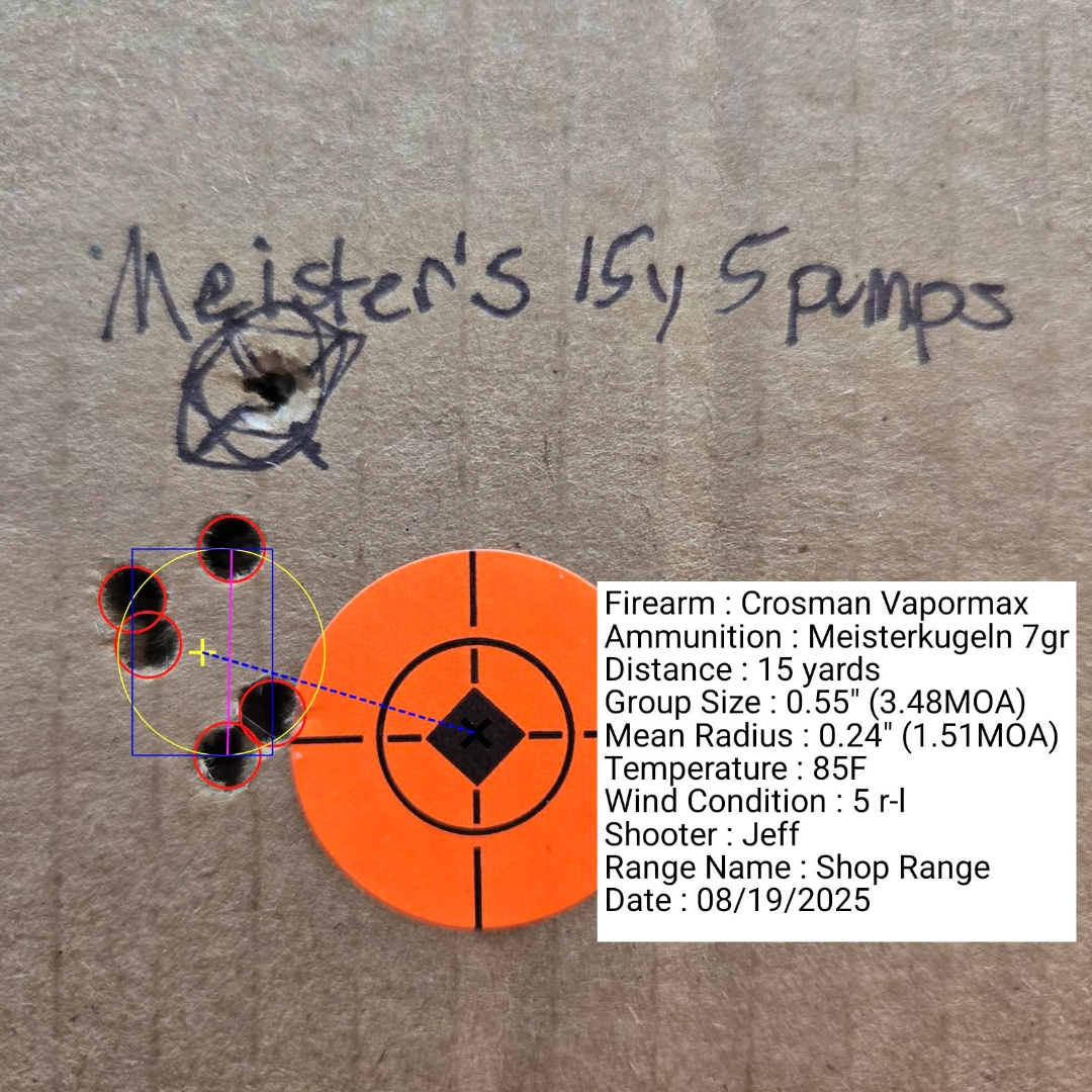

Great review man, I just looked at mine to see if I had as much flex as you are getting and it is minimal on mine but I am also using a 2 screw wider ring base so maybe that is the trick on these. Sorry to see the accuracy you are getting with yours, I only had the crosman round Nose 7gn to try but they were short in the magazine however I did get around .65"@ 15 yards, I think I have some CS HP's I'll give them a try and see what I get i hope these don't end up being luck of the draw or bad QC! I'd like to pick up another one. Thanks for reviewing yours I hope you find a pellet it likes oh and that's a big difference in fps at your elevation compared to mine lol.
