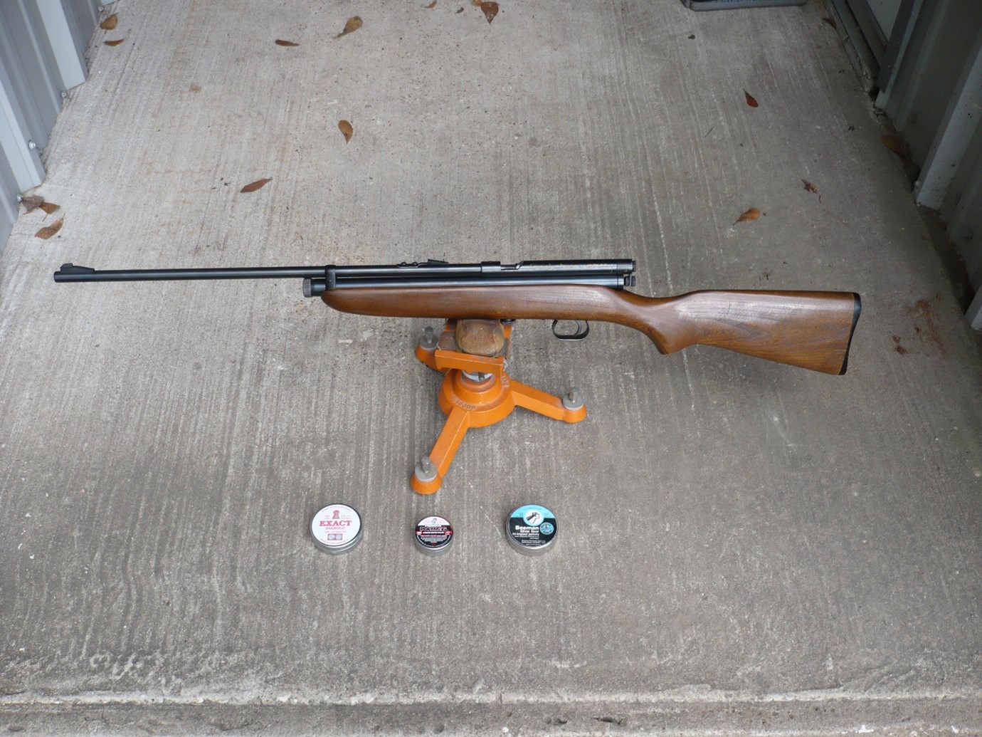

Crosman CO. introduced in 1955-1956 perhaps one of their most famous series of CO2 Rifles, the 160 series. Model 160 .22 cal. and the Model 167 .177 cal. powered by dual CO2 cartridges. The lesser known and smaller production, number wise, Model 167 .177 cal. is under review here. The 160 /167 series were made from 1955 – 1971. There were three variants of the 160 series, 1st variant, pinned trigger thru stock no barrel band, 2nd, variant simple trigger with barrel band and the 3rd variant with the adjustable trigger mechanism and barrel band. All the 160/167 series were powered by dual 12 gm. CO2 cartridges. They weighed 5 lbs. 10 oz. and were 39 inches long.

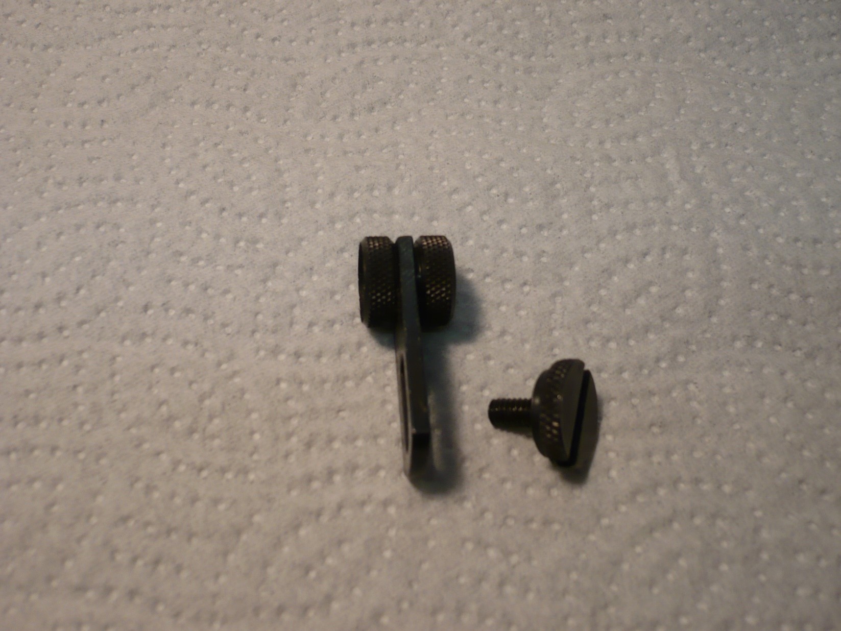

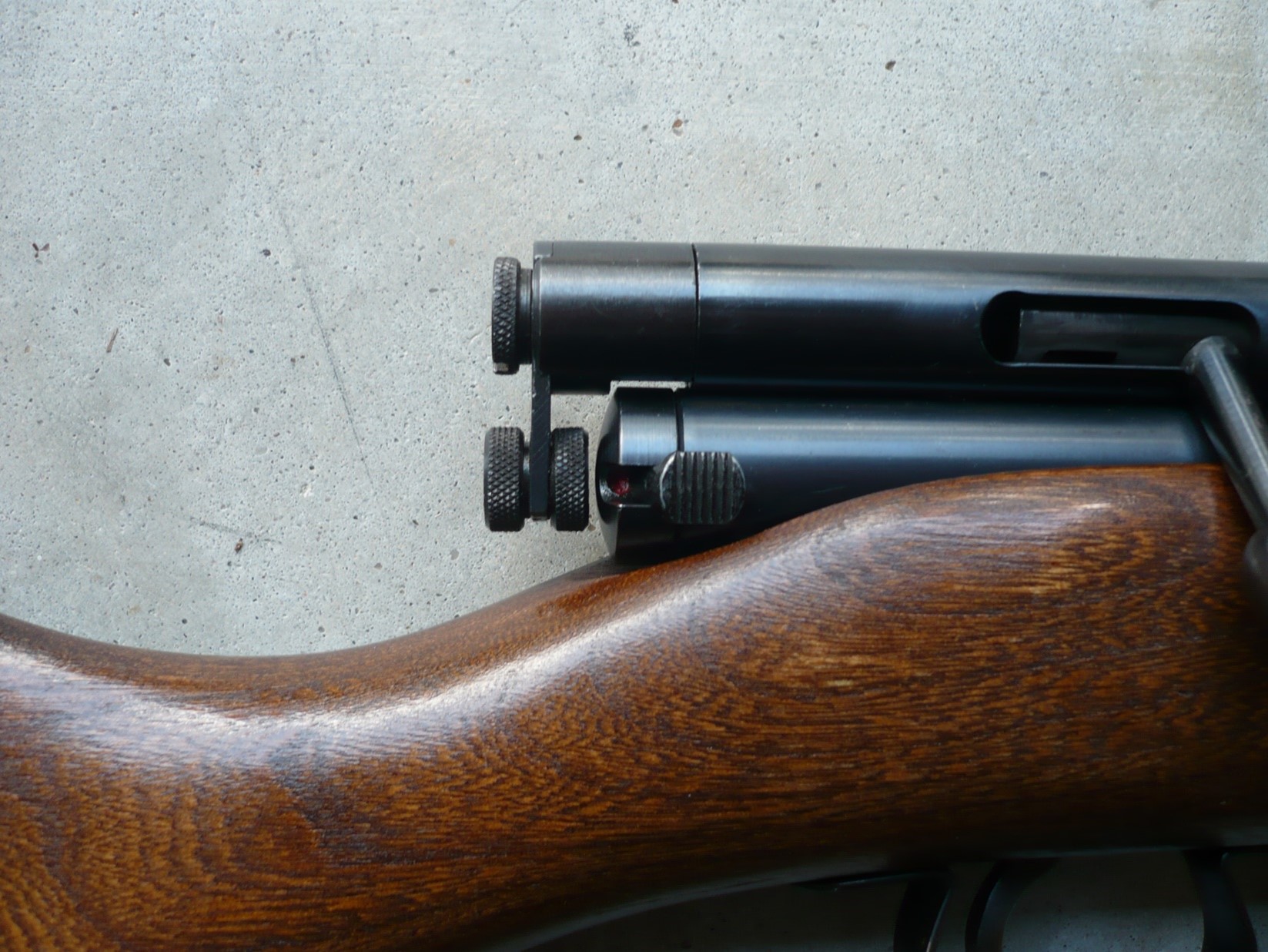

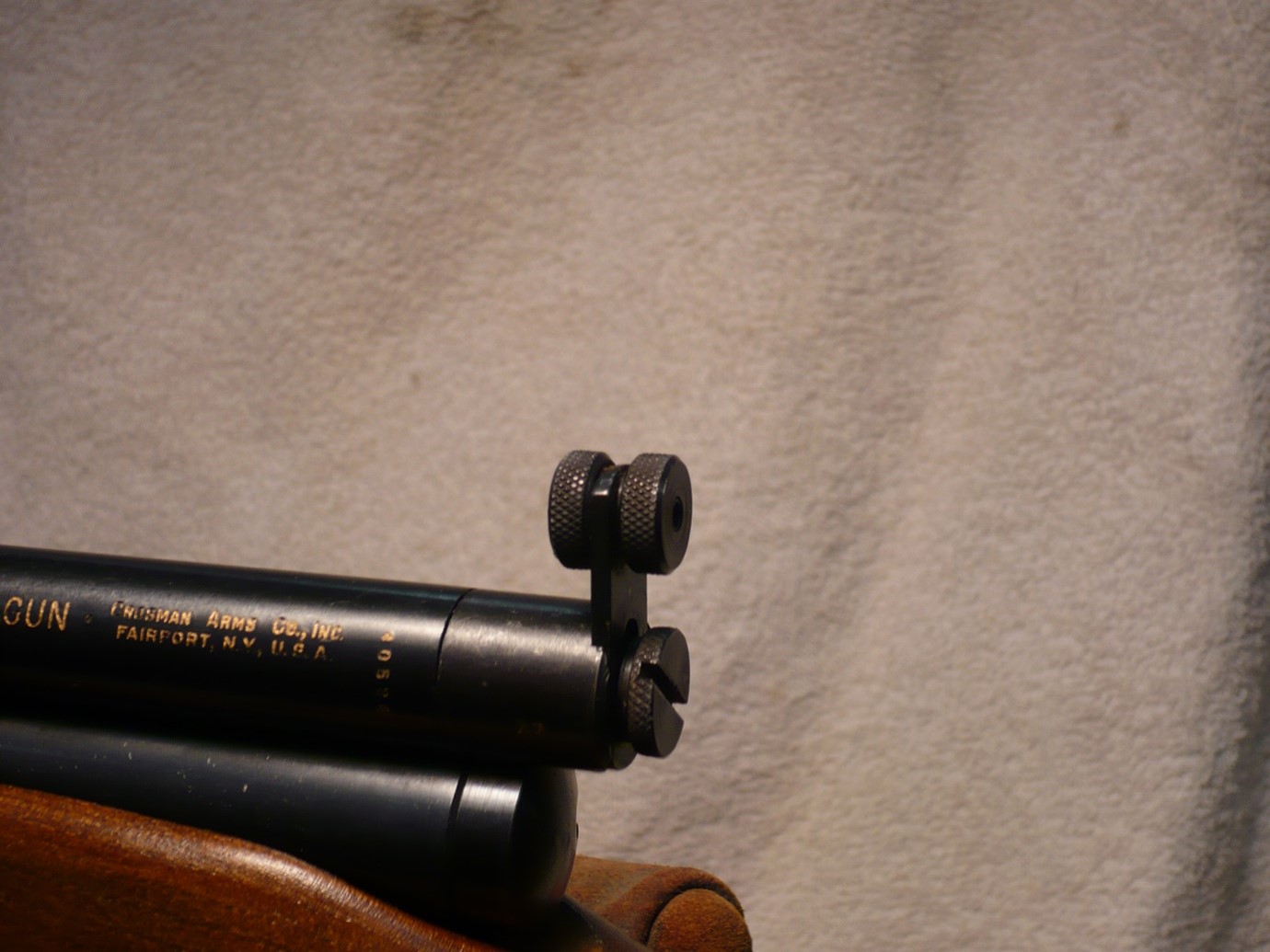

I had been looking for a M-167 for many years to compliment my M-160 and was finally able to locate one in excellent shape it had the rare Crosman 360 peep sight, this peep sight differed significantly from the more well-known Mossberg S331 peep sight seen on many 160 series models. The C-360 peep sight was a rather simple design attached to a slotted plug on the rear portion of the rifle with a thumb screw. The thumb screw when loosened allowed raising the peep sight for elevation; the peep could be moved left or right for windage. The 360 peep could be taken off and rotated 180 degrees reattached via the thumb screw thereby returning to the use of the standard rear sight located on the barrel, a simple but elegant innovation!

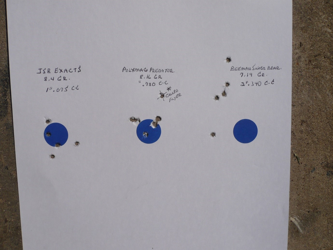

Accuracy test were conducted at 25 yards from a bench rest using the rear sight on the barrel (I could not use the Peep my old eyes would have none of that) I selected 2 pellets I knew shot best, Polymag Predators 8.16 gains and JSB Exacts 8.4 grains and a third Beeman Silver Bear 7.2 grains which most recommended for Air Pistols so I did not know how it would shoot. As always, I use card stock paper with ½ diameter adhesive dots, three on a target shooting left to right. Shooting 5 shot groups, JSB went into 1.075; (after a called flyer, elbow slipped) 5 shots of the Polymag Predator went into .780 and 5 shots of the Beeman Silver Bear strung vertically into 2.340 inches (obviously not for this rifle).
The clear winner was the Polymag Predator pellet, shooting a .780 inch group at 25 yards is as good as I can shoot with any open sight Air Rifle and I could do this consistently from the bench with this Crosman M-167. I always try to set up an Air Rifle for maximum accuracy, there just was not much to do for this rifle it was intrinsically accurate, trigger was good @ 4.0 lbs. etc. groups could have been improved with addition of a scope no doubt (which I normally do) but I am resisting this at least for now, the rifle is just such a pleasure to shoot with open sights.

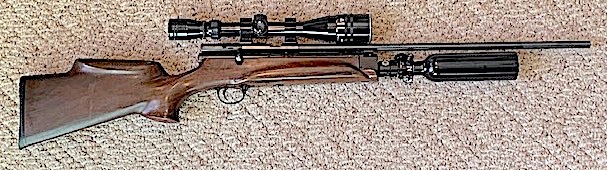

The latest evolution of the .177 QB above just won a Bench-Rest Silhouette match (1/10 scale silhouettes to 100 yards) against a .22 Scout and .30 Brocock Ghost producing 2-3+times as much energy in the hands of national-caliber shooters in Slug Class-
