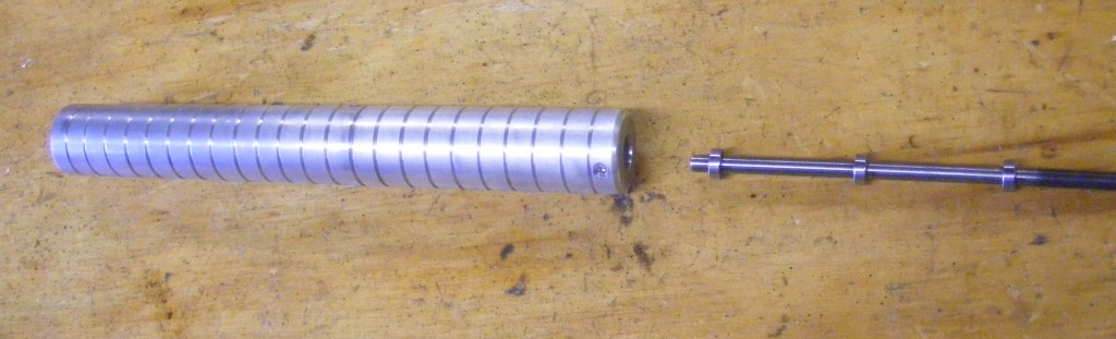

What ball bearing rod do you recommend?
The two purchased rods I use are Pro-Shot and they are nice quality rods, but I've also made a couple using cheap generic ball bearings and they work just as well so I expect most any ball-bearing rod is suited to the task.
Those purchased rods, at rifle barrel length (24"-30"), are close to $40, which is more than I want to spend.

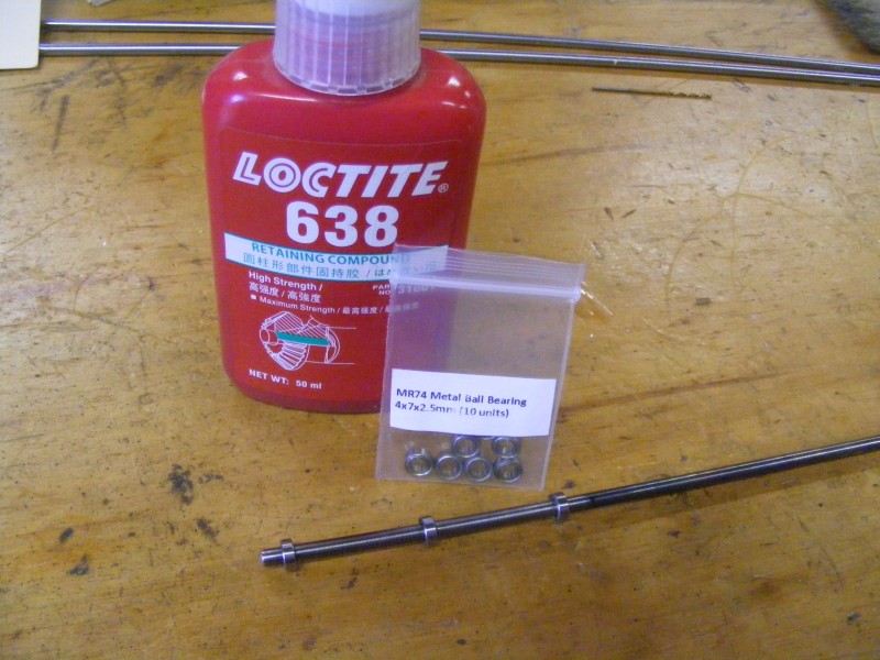

How did you make the other rods?
Take a plain cleaning rod and remove the handle. Order some bearings of the proper ID and use retaining compound or red threadlocker to bond them to the rod:
For the rod pictured here, I made a handle with a piece of 3/4" aluminum bar stock, but for a previous one I simply used a cutoff from a wood dowel.

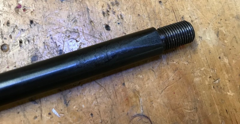

The barrel on my .22 Icon showed good promise so I decided to give it a little attention. First up was to remove the front sight. I was expecting it to put up a fight so I made a simple slide hammer with a scrap of wood. Before warming up the sight to soften it, I gave it a couple of moderate strikes with the slide hammer and it popped right off. Turns out it simply had a brittle adhesive holding it and a flat for indexing.

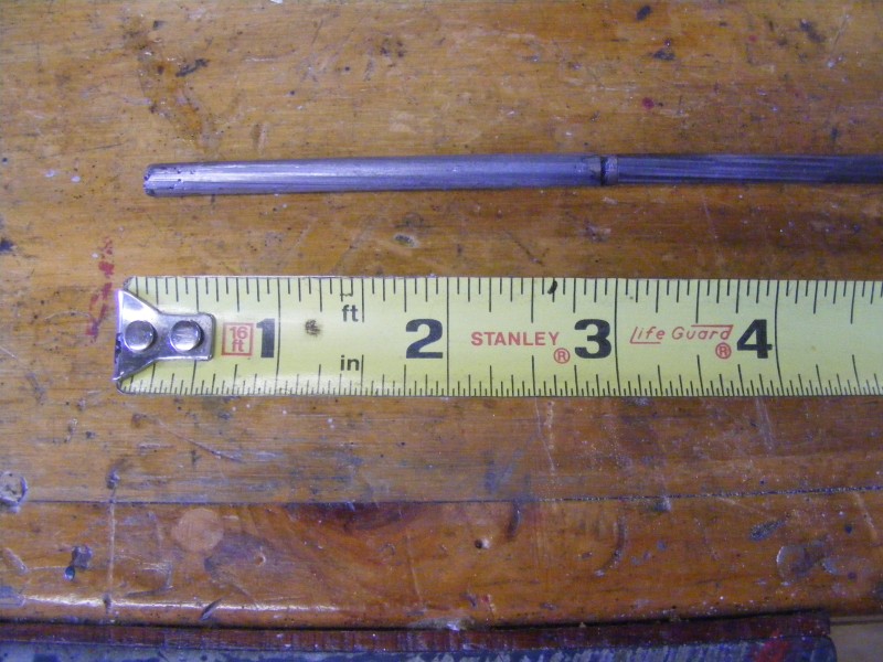

Starting at the leade, I used a generic Cratex point and wet/dry sandpaper to break the sharp step in the rifling. Then I poured a cast lap and worked the bore. There were two tight zones at approximately 25% and 75% of the way from the breech which took a bit of work to blend out. Here's a pic of the lap after the job was done.

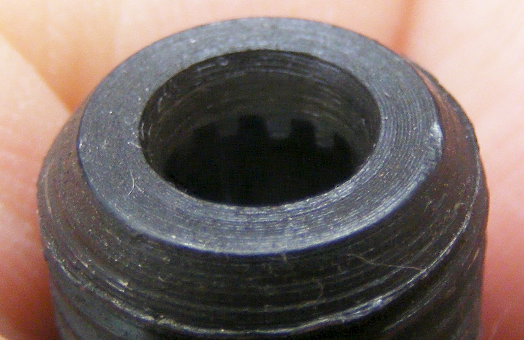

Then it was time to deal with the irregular factory crown

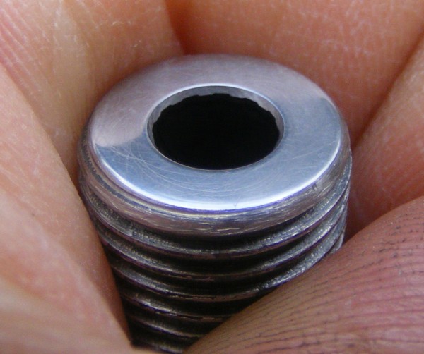

After cutting it back and recrowning:
Then cleaned the bore and reinstalled the barrel and pulled some patches with Johnson's wax. Waited a bit for the solvent to evaporate from the wax, then grabbed the Norma 17.6gr domes to shoot some test groups. It seems to have responded nicely. The first 3 groups at 30 yards measured 0.22", 0.36", and 0.19". Average of 0.257" or 0.82 MoA.

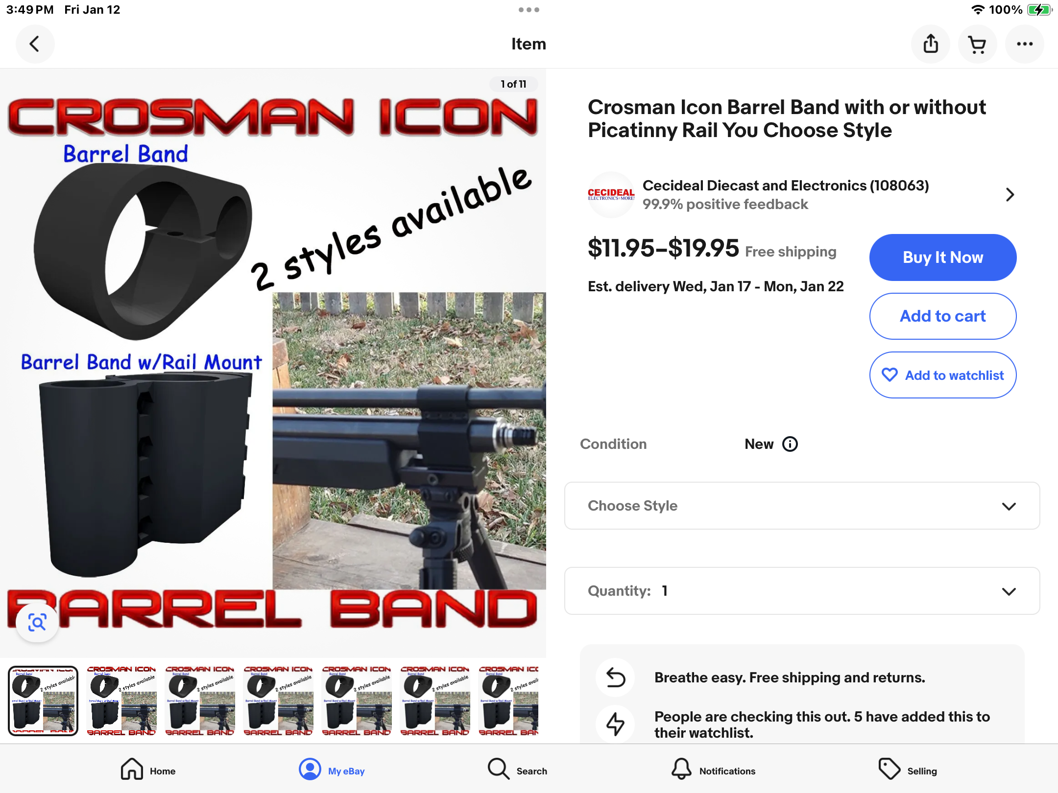

Finally got mine yesterday, did a few mods. Redesigned and printed a barrel band and was able to use an old scope that fits well. swabbed the barrel and laser bore sighted. It's holding air so that's a plus. hopefully get time to dial it in tomorrow.
Someone on eBay is using my pic and stl file selling on eBay now.
Reactions: nobody1
Thank you for your barrel bands.
I have one each on my 2 Icons.
The ebay guy is a jerk.
You should state that your design is only for personal use,
Or if they sell it they should pay you somehow.
If you add printing material cost, 3D printing power consumption, and shipping, it will cost $8 - $10 to make a single barrel band.
Why are they doing that ?
I don’t have anything licensed as non commercial so anyone can do whatever they like. Just kinda erks me they are using my pics listed there as those aren’t downloadable. I actually revised that barrel band and cleaned it up and resized pic rail as that one was slightly undersized.
