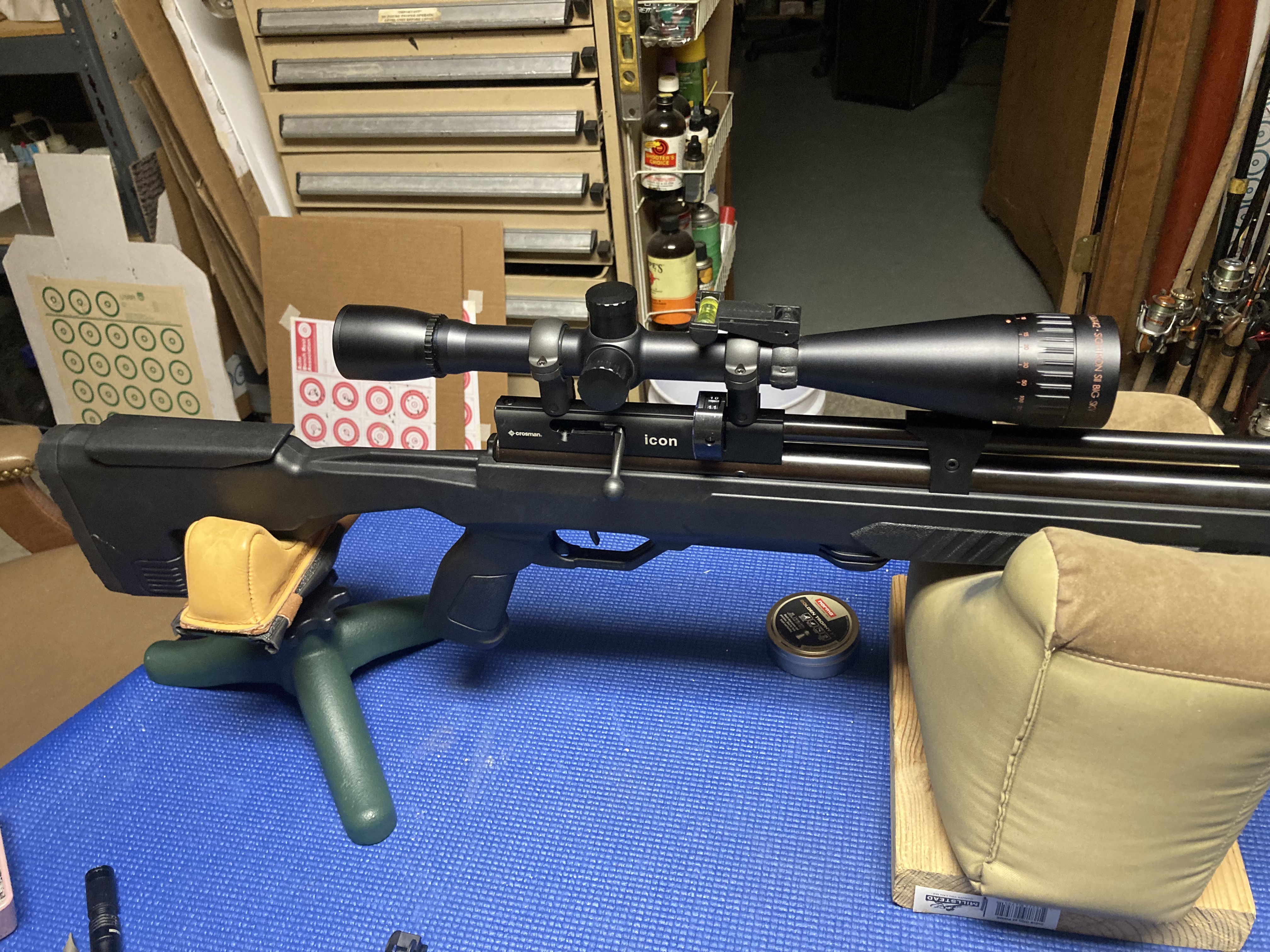

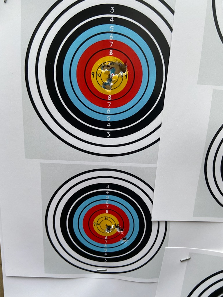

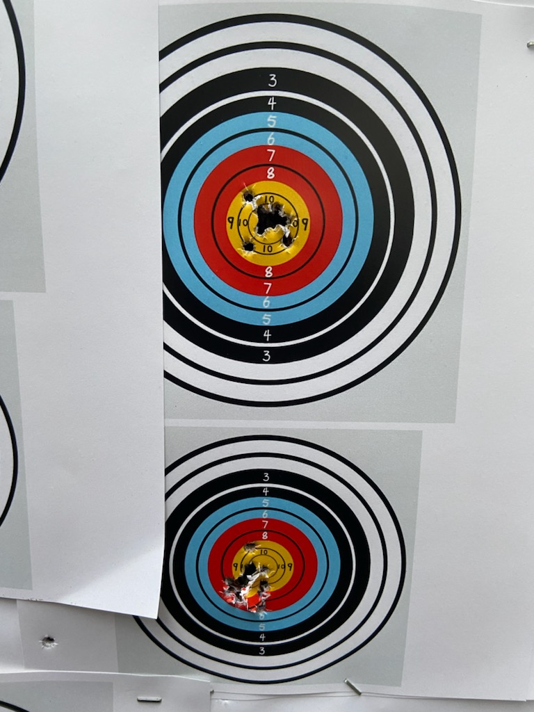

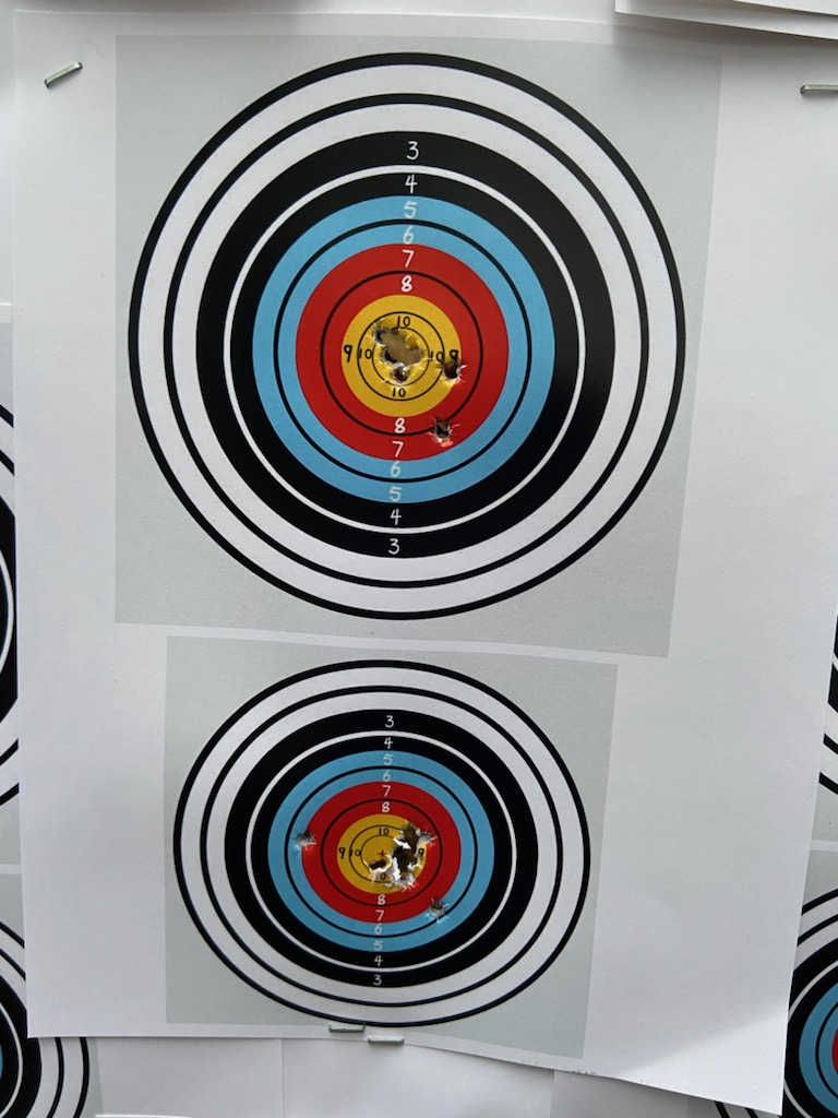

was able to get out with an hour break in the rain today, first group is with HN baracuda's and the rest are 14.3 g benjamin discoverys. Each are 10 shot groups at 25 yards at rest with bipod. good enough for me. the flyers are all me and not the gun.
