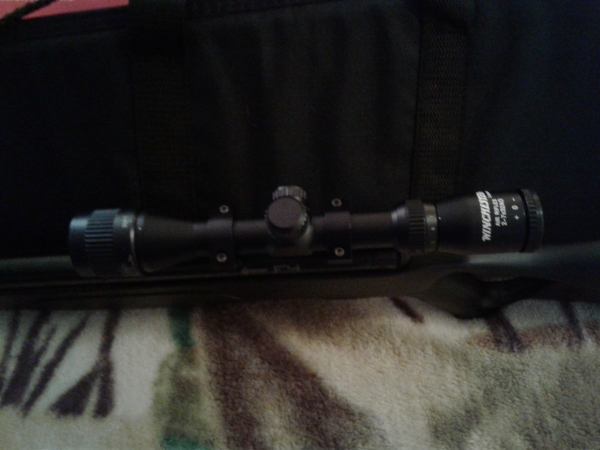

I bought it 10.03.2018 and already have over 500 rounds through it. $79 and it comes with a sweet CenterPoint 4x32 scope??? No complaints at all. I used at least 3 different types of ammo before I understood that different ammo comes out differently. I beat up a lot of targets and didn't write down any data on them. Then I went to the internet and learned a couple things. I decided I wanted a better scope and went with the Winchester 2-7x32 AO. Very nice scope. One problem: the rings that come with it don't have a set screw for the rear ring. I went ahead and used them anyway, bad mistake. The scope kept shifting around and I personally believe that the tape they put inside the rings is part of the problem. After switching to new scope, I could not find zero at all. I was bummed. I learned about the Leapers AccuShot one-piece mount and blue loctite. That gave me an idea. I decided to pull that tape and apply blue loctite to every screw, inside the scope rings where the tape was (not sure if that was a good/bad idea) and on the dovetail where the rings mount, as well as the set screw. I went back to the original rings that came with the CenterPoint scope since those have the set screw. However, they are lower in height compared to the rings that came with the Winchester scope, so I can see the top of the flared barrel at the bottom of the scope. Bit of a bummer.

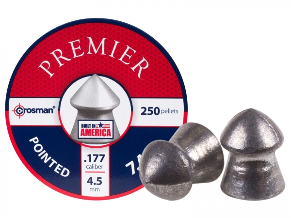

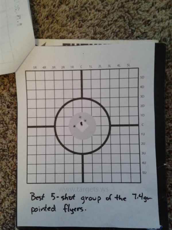

After loctiting the crap out of my scope and letting it set up for ~24 hours, I started shooting strictly .177 Crosman Premier Pointed 7.4 gr.
1542233963_13964893655bec9f6b7cee54.87889419_PY-P-108_Crosman-Hunting-177-Cal_1500409007.jpg

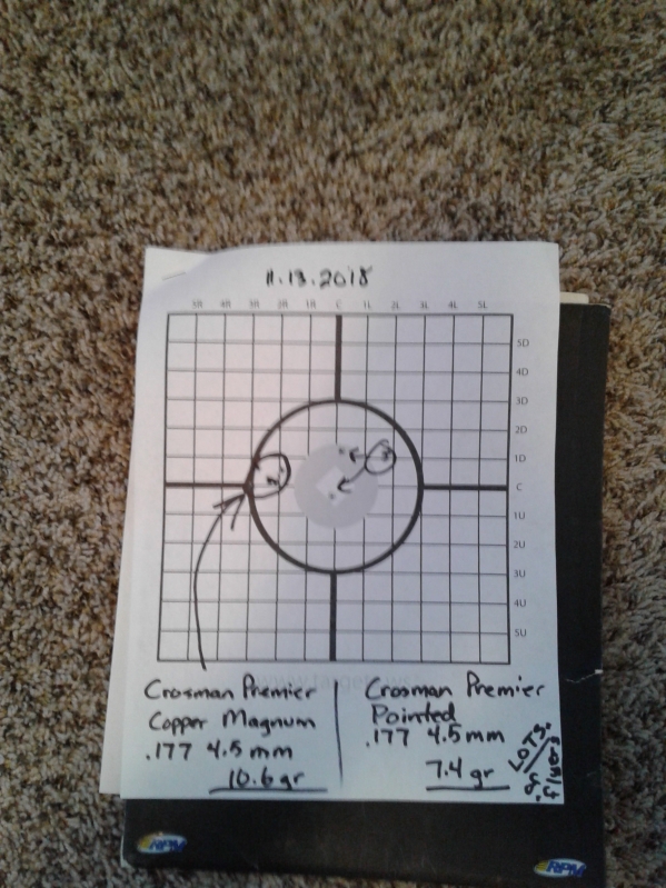

Now, I'm shooting 30 feet, indoors, and at least 1, usually 2 or 3 out of a 5-shot group were flyers. Even in that picture you can see the seem and imperfections. This ammo should be pulled from the shelves.

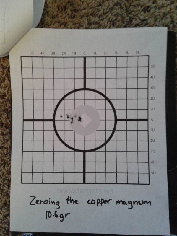

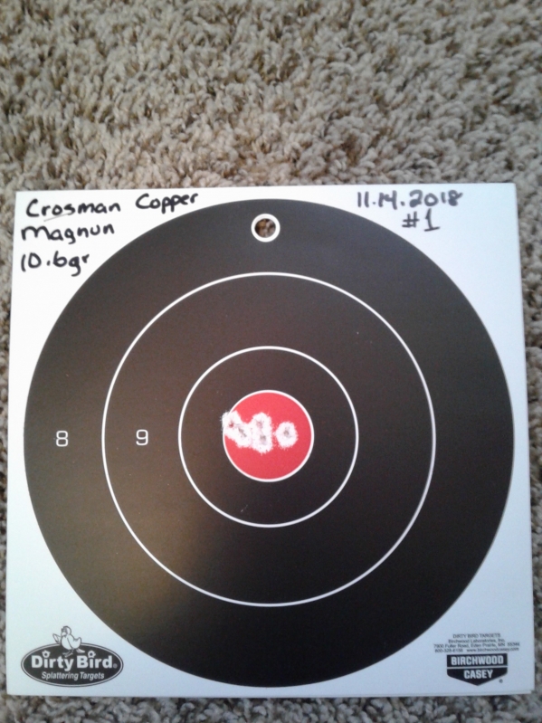

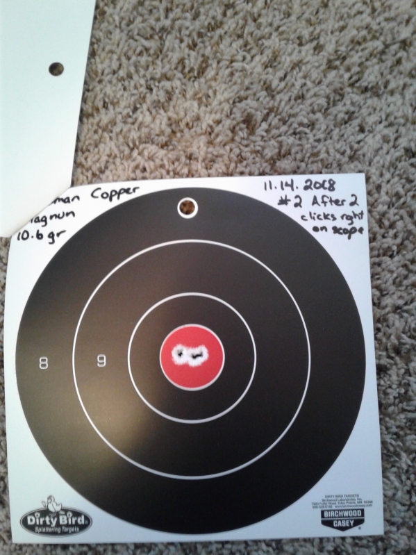

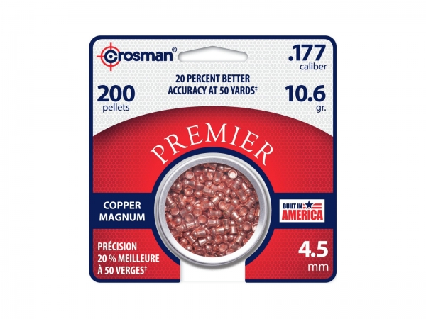

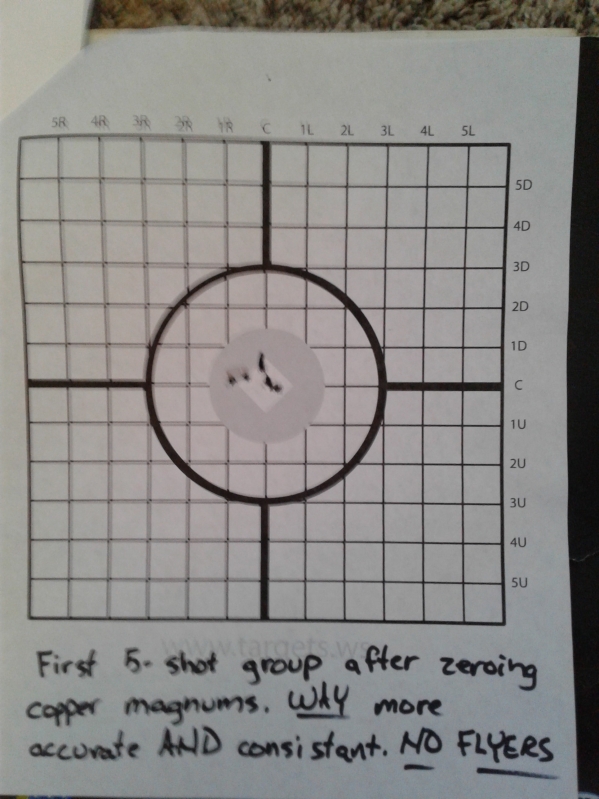

Next, I shot the .177 Crosman Copper Magnum 10.6gr
1542234188_19043514245beca04ce3cff7.68345835_PY-P-1352_Crosman-Premier-Copper-Magnum_1465908392.jpg
I will let the results speak for themselves:
I have found my ammo and I am sticking with it. It's lead free and the quality of each pellet is top notch. I love what Crosman says about them: "improved rifling engagement". They definitely fit tighter than those cheap pointers. I'm willing to bet this ammo works good in all these rifles because it comes from the same manufacturer.

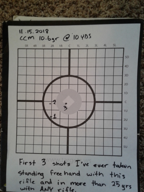

Pretty happy with this result!!!

    Those copper coated 10.6gr Crosman pellets don't shoot very well and are not worth the price that even Walmart sells them for
    so if you are only limited to Walmart pellets then I strongly suggest you try the 7.9gr Crosman Premier Hollowpoints and the 10.5gr
    Premier Ultra Magnums and there is no question and I am sure you will get better results than what you just got.
    If you are going to order pellets then order them from Pyramid Air and take advantage of the pay for 3 and get the 4th free deal and
    coupon special click on the banner above and also free shipping for orders for over $150.00 purchase.
    I would buy H&N Field Target Trophys in the 4.52 and 4.53 head sizes to see which one your gun likes best.
    I would also buy Air Arms Heavy Field 10.3gr but out of stock right now so buy the JSB Exact version 10.34gr,
    Air Arms diabolo Field 8.44gr but they are out so the JSB Exacts 8.44gr 4.52. Right there is your 3 plus 1 free.
    At least use the 10% coupon on top of that if you don't intend to spend $150.00 for the free shipping.
    These pellets are good to have handy for any new gun you want to find out what they like the best because they
    are already proven accurate in many guns.
    I have tried many different pellet samplers and too many of the selections were rubbish which I wouldn't even
    consider buying anyway IMHO.

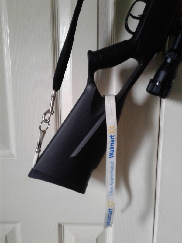

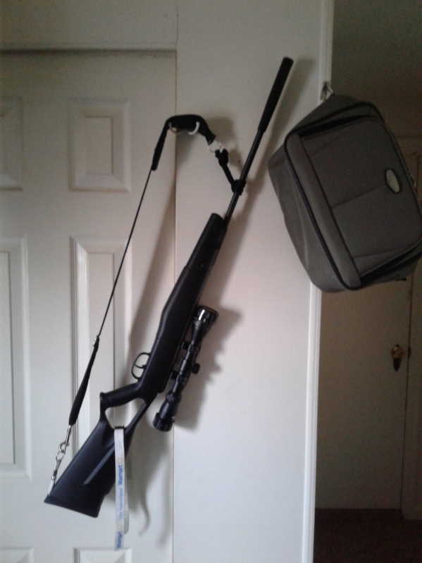

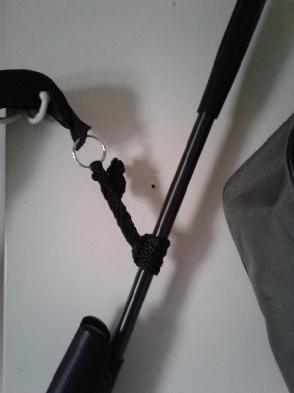

            Anyway, moving on from that nonsense, I fabbed up a DIY sling!! The components I stole from are all shown, minus the key rings and latches.
            And yes, @WaltherV, I AM appreciated! 😝
