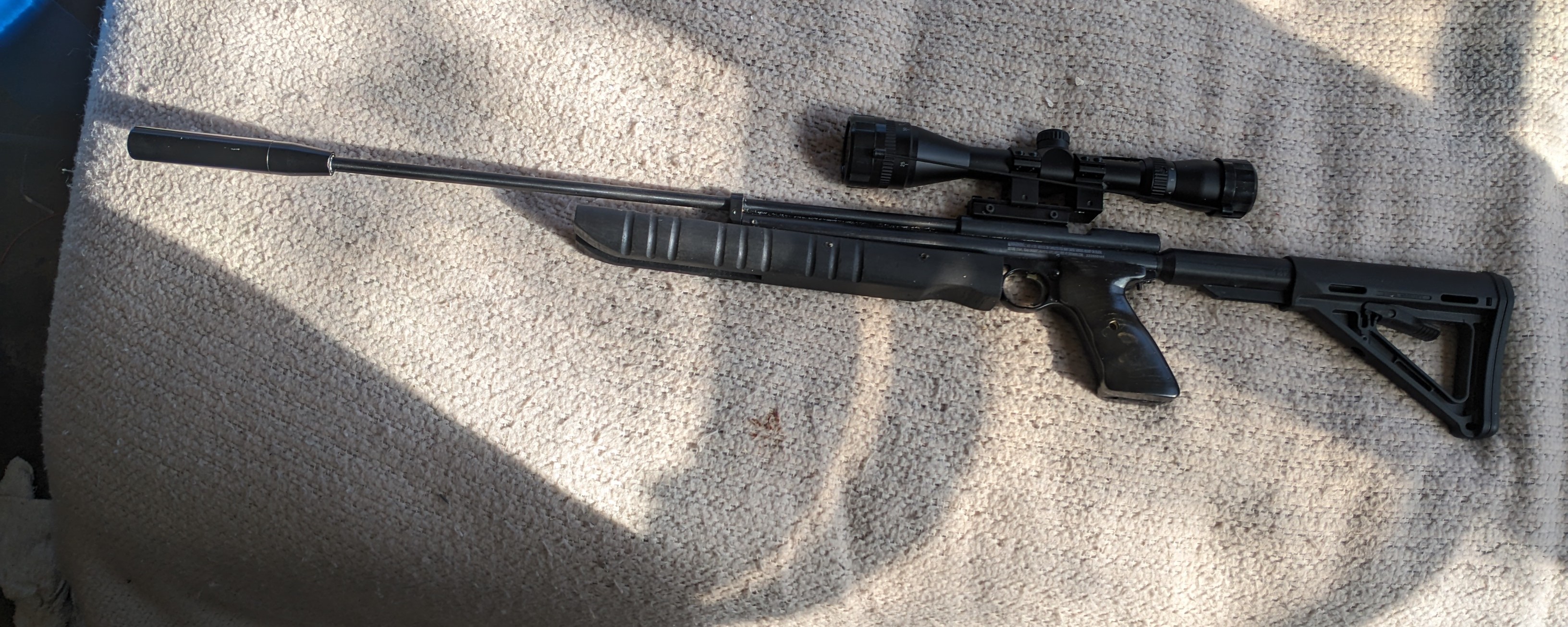

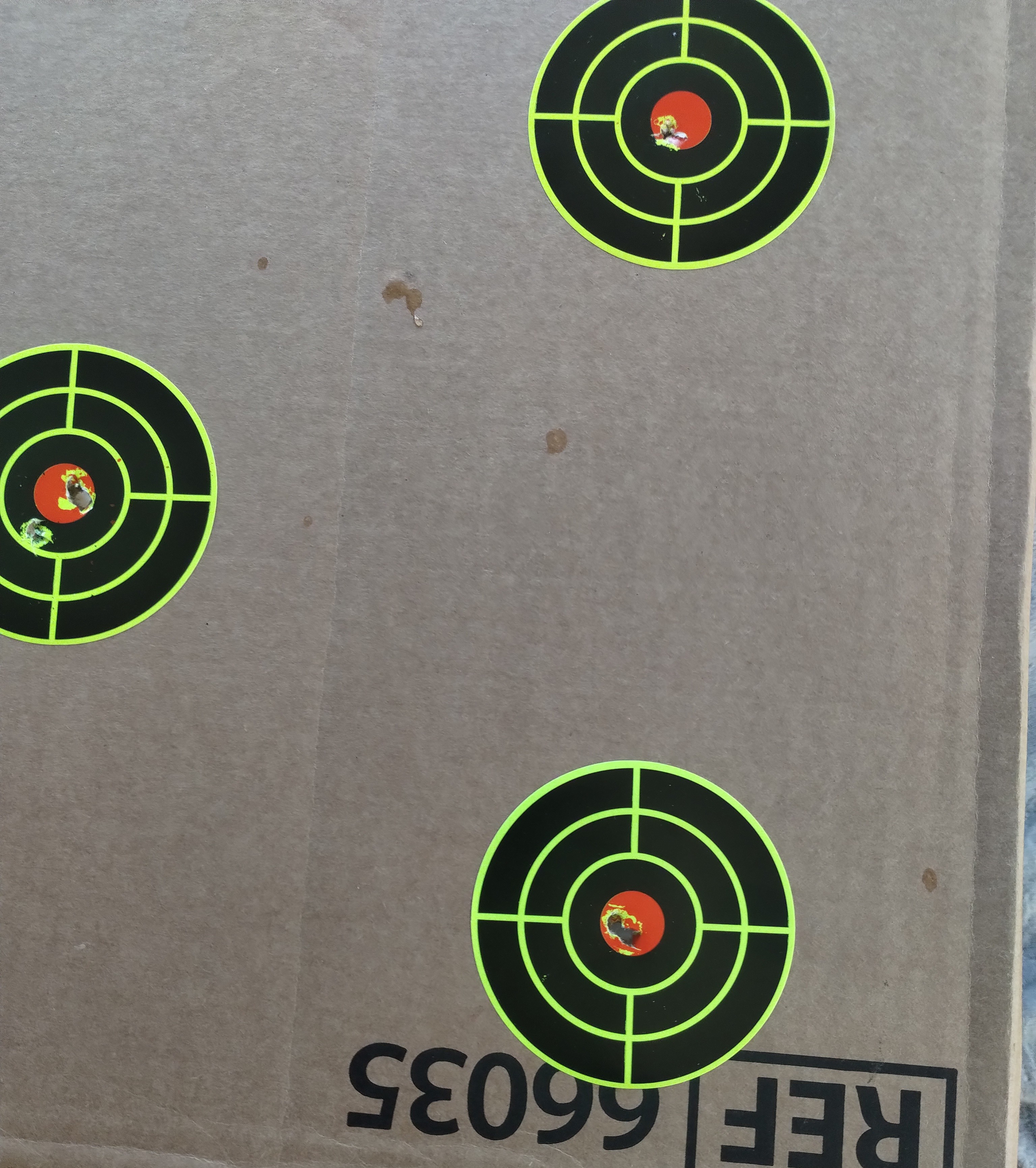

My Drifter has been so heavily modded, it's not even the same gun. 24" tuned barrel, moderator and brass extended bolt probe from MAC1. A 362 Powerplant with a flat top piston and valve. A wider delrin port. Polished lead into the rifling. Stock from Buck Rail. Pump arm and grips were made in my shop. Everything is sealed, bolt to breech, breech to barrel, whole upper part sealed to the lower. Powerful and accurate. 760 fps. These are 3 shot groups at 50 feet.
My Drifter has been so heavily modded, it's not even the same gun. 24" tuned barrel, moderator and brass extended bolt probe from MAC1. A 362 Powerplant with a flat top piston and valve. A wider delrin port. Polished lead into the rifling. Stock from Buck Rail. Pump arm and grips were made in my shop. Everything is sealed, bolt to breech, breech to barrel, whole upper part sealed to the lower. Powerful and accurate. 760 fps. These are 3 shot groups at 50 feet. It was basically an experiment to see how much performance that I could squeeze out of a basic Crosman pumper.
