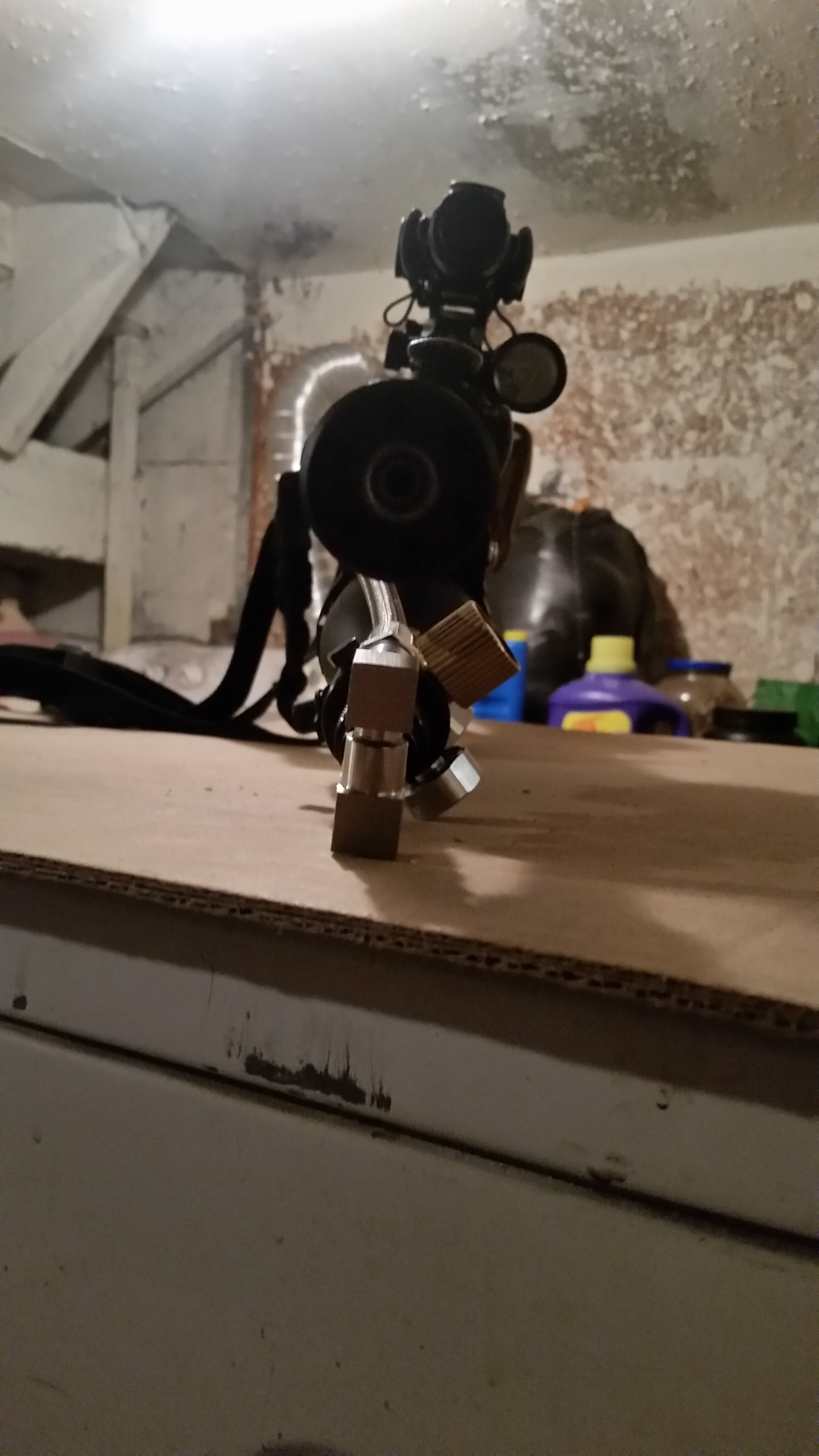

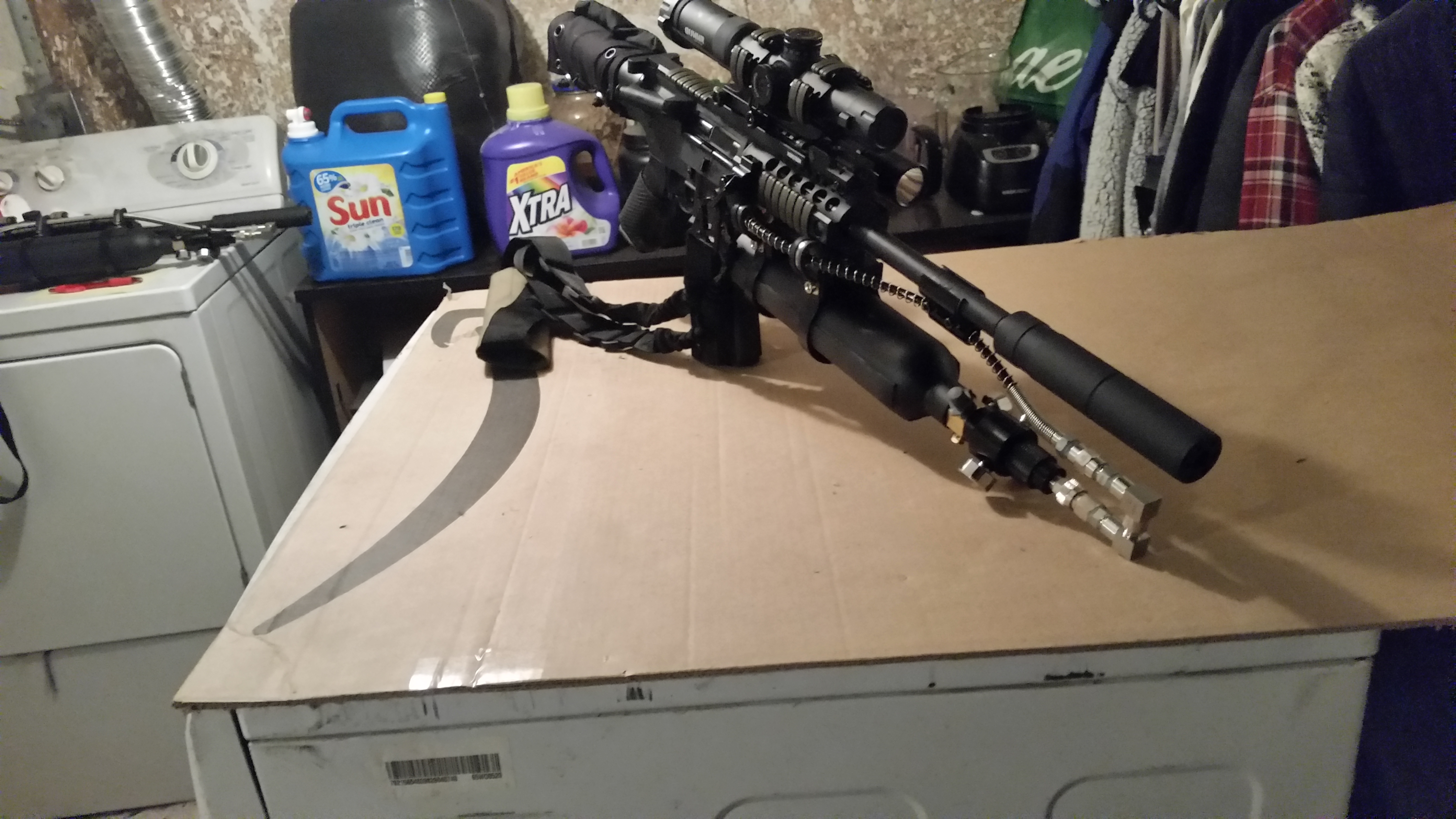

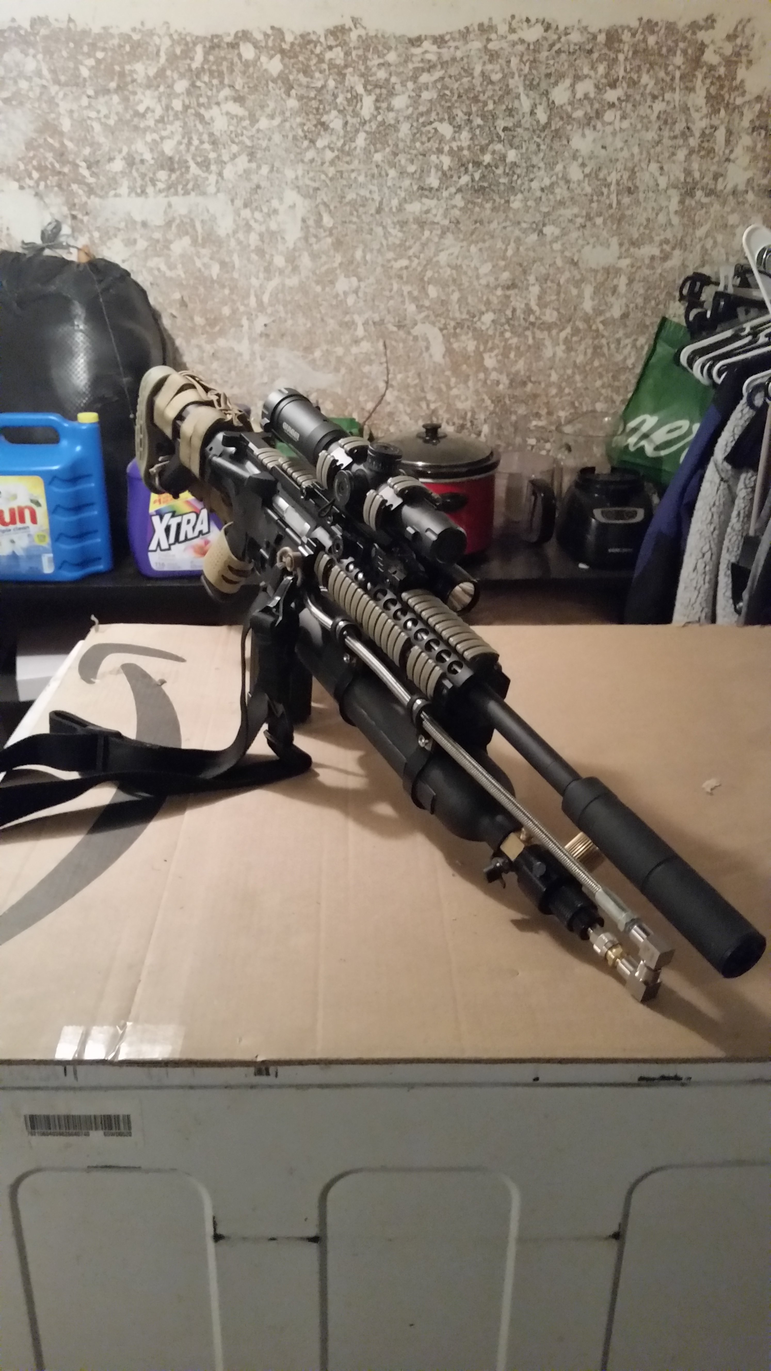

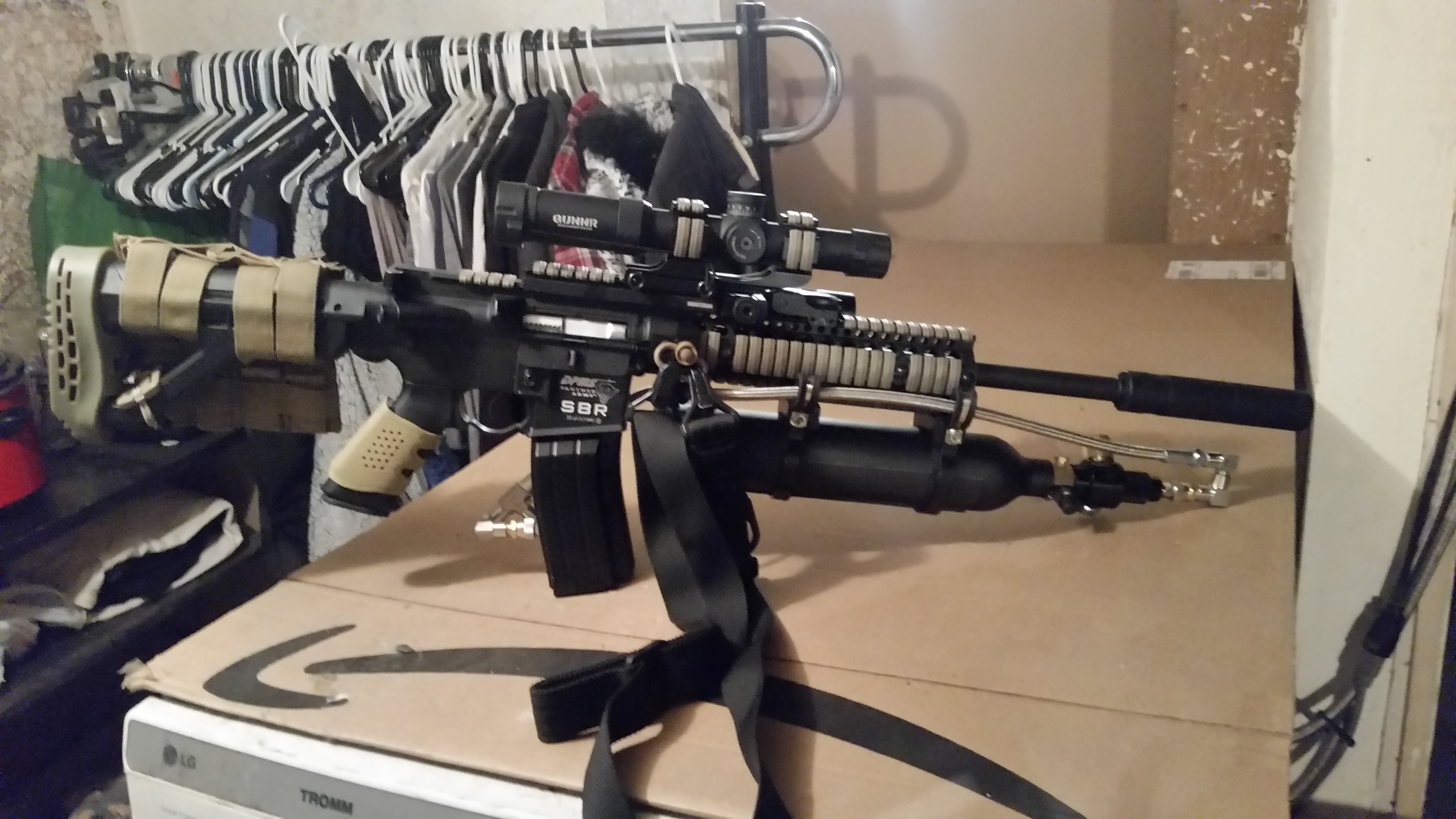

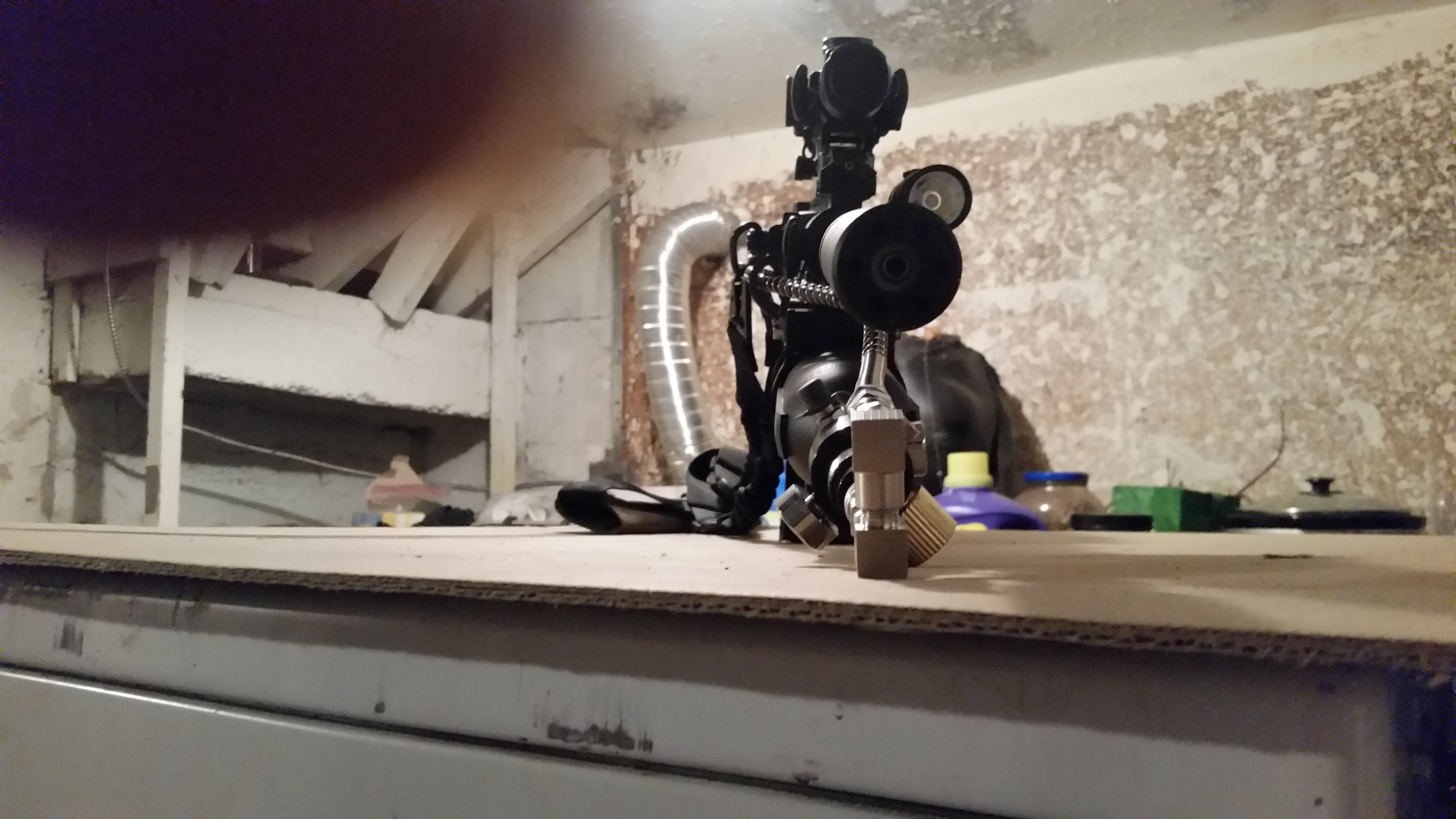

Actually I just put a ton more into it. It now has:
Even heavier hammer spring system.
Completely rebuilt breach and inner and outer barrel with a 20 3/8 in inner barrel.
4500 psi tank with picatinny mount
Adjustable regulator to shoot from 1000psi ( with factory hammer spring ) for plinking or up to 3k psi per shot. But I find they shoot best at about 2500psi
And honestly alot more that I really don't feel like typing. :)
I also built my wife a an A4P which is really the exact same gun but with a different stock setup. Both can move steel 5.1 g bbs at 1650 fps and I can push 10g nickle platted lead shot at close to that which is about 60ft lbs of energy per shot. I got a bb through a steel frying pan so thats pretty good.
All semi auto and full auto still works correctly. I have put about 500 rounds through them both and everything is holding together well.

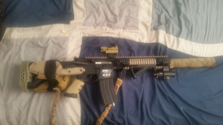

Just wanted to reach out to everyone and let you know I just finished doing a build on a Crosman DPMS SBR. I wanted to post this because I have not found any other info on this gun anywhere online. This also motived me to do this build. I did a sevral mods on it, including -
  1. Two stage hammer spring system
  2. Conversion to HPA regulated at 1100 psi
  3. REAL silencer made from mock suppressor
  4. Polished hammer bolt
  5. Rubber upper and lower support bushings
  6. Red dot sight
  7. Real iron alternate sights with quick use
  8. Many other cosmetic items
    [/LIST=1]
    If any body has any questions on this gun I know it inside and out. I would be happy to help anyone else who might be doing mods on this gun. I ran it over a chrony and I am just about at 1000fps. It hits pretty damn hard in full auto. Now if I could just figure out how to build a 100 round clip. :)
