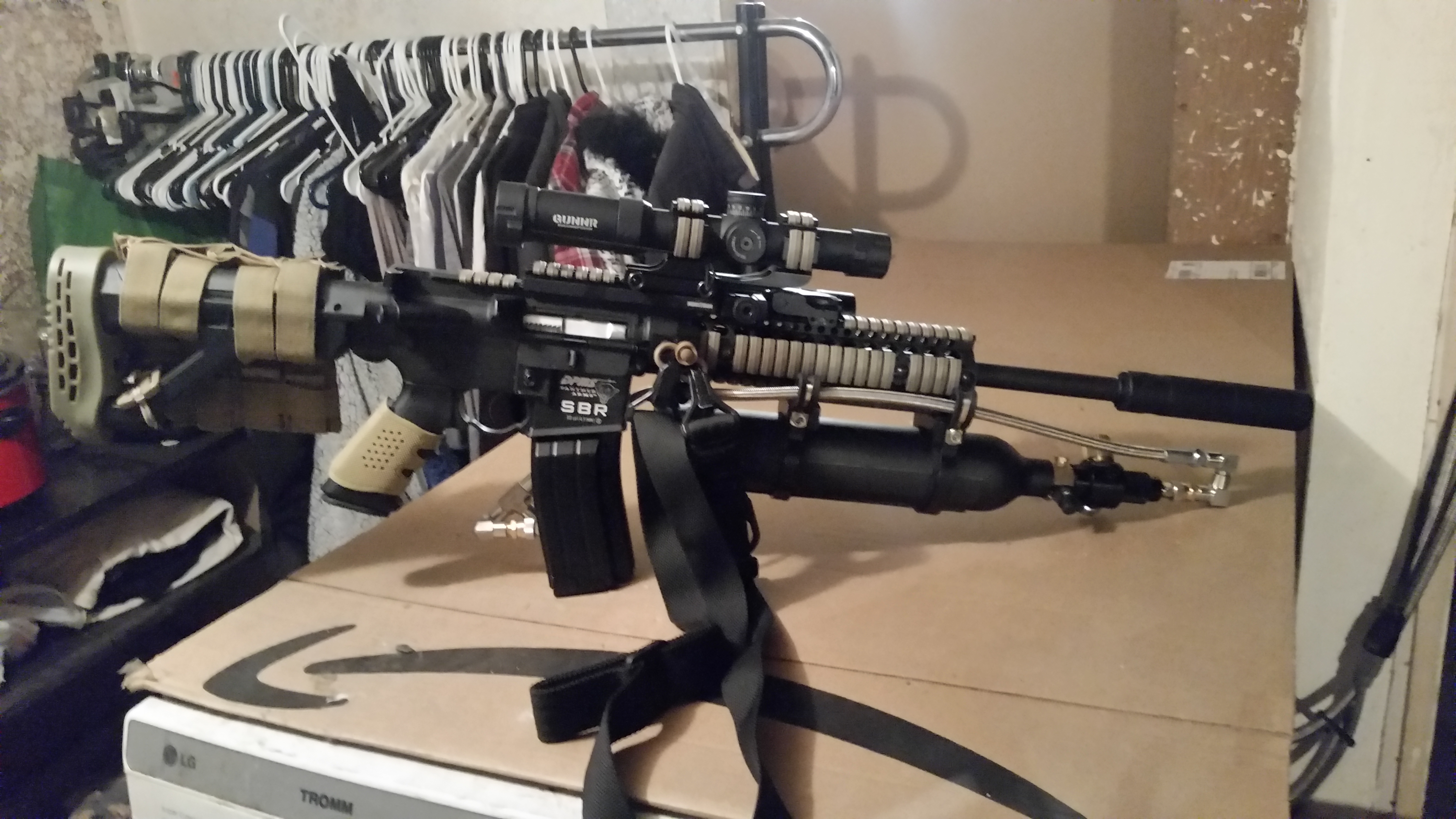

Just wanted to reach out to everyone and let you know I just finished doing a build on a Crosman DPMS SBR. I wanted to post this because I have not found any other info on this gun anywhere online. This also motived me to do this build. I did a sevral mods on it, including -
- Two stage hammer spring system
- Conversion to HPA regulated at 1100 psi
- REAL silencer made from mock suppressor
- Polished hammer bolt
- Rubber upper and lower support bushings
- Red dot sight
- Real iron alternate sights with quick use
- Many other cosmetic items
[/LIST=1]
If any body has any questions on this gun I know it inside and out. I would be happy to help anyone else who might be doing mods on this gun. I ran it over a chrony and I am just about at 1000fps. It hits pretty damn hard in full auto. Now if I could just figure out how to build a 100 round clip.

Ok - First off thank your for the post. I have put a ton of time into this so I do appreciate when people notice. Secondly - I have changed this gun a bit since I posted it. I have mounted the HPA tank to the stock with a remote line and cover. Also I have polished the inner barrel and added the 300rd clip. I went with a different HPA adapter that allows me to run the gun regulated at 1400psi. Its a beast! Below are links for the items you would need. I used the xxxl wire ties from Walmart to mount the bottle to the stock with some padding between them and then hid the ends of the wire ties. It looks super nice. I cant take pictures now but I will post some later.
HPA tank
Remote line ( W bleed valve. Its a must! )
Remote line cover
HPA adapter from co2 that can handle up to 2k psi
Mock supressor
Supressor cover
300rd clip ( 25 round quick reload )
For the gun to be able to handle over 850psi and still open the valve fully, You have to add tension / weight to the hammer spring assembly. Let me know if you want details on this. For the supressor, using the mock as a base it is pretty easy to make this into a functioning silencer. Let me know if you want details on that as well.
Let me know if you have any questions
