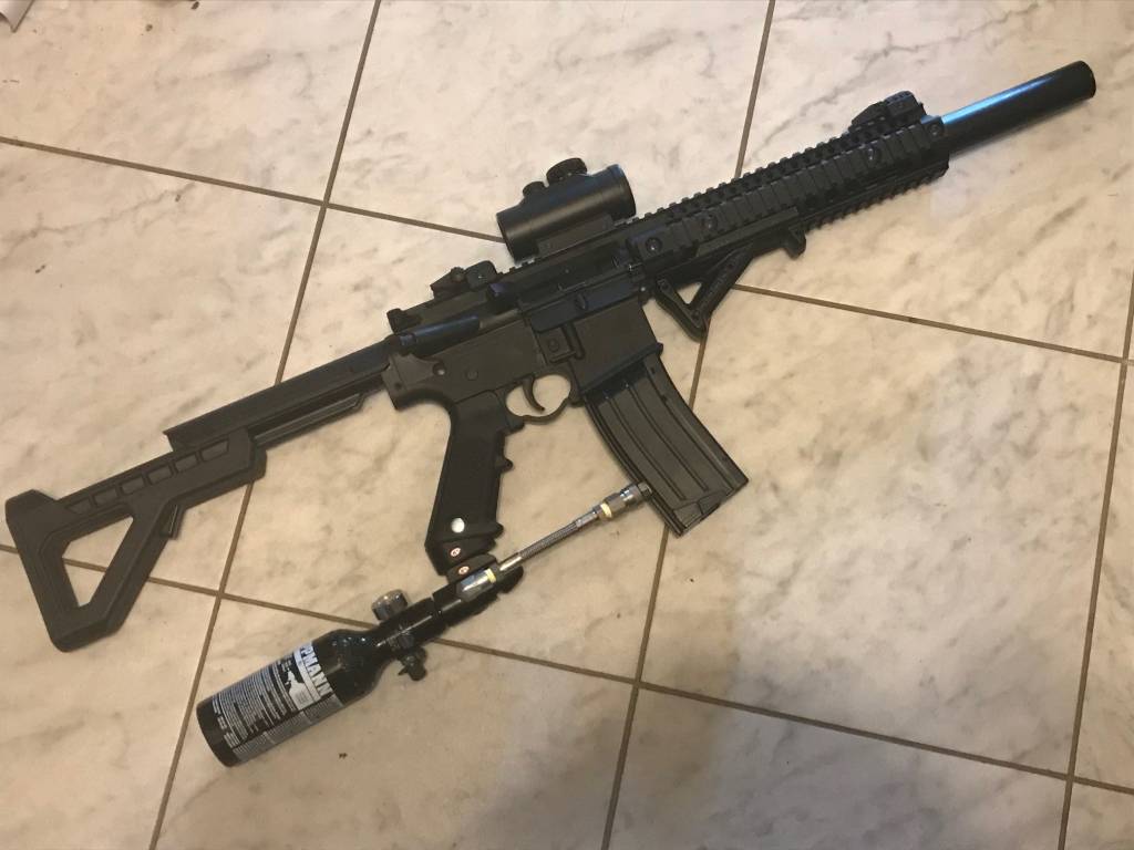

Joey, you appear to have one of the few performance builds out there. Were you getting close to 1000 fps at 1100 psi? It looks like you went up to 1800 psi after your original post, so I am curious what the performance is like now. In your experience, would there be any benefit to shimming the hammer spring at the stock air pressure? I’m sure a lot of people would like to see any videos or pictures you can put together to show the change in performance.
HPA seems like the way to go. I’d just like to see more information on what kind of results to expect before I order a bunch of stuff. I thought adding preload to the hammer spring might be something inexpensive to try while I consider my options.
