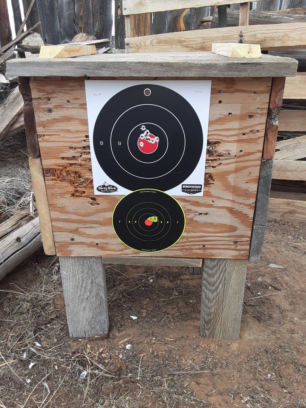

Last night, I went to do the trigger fix with the rc bearing and learned this trigger is different/way better. The adjustment screw is buried all the way in and you move it counter clockwise a good couple turns and suddenly you feel the second stage wall. I prefer this and it feels a lot like my F4 with the bearing mod.
Good thing I took it apart! Both forward screws that hold the stock were LOOSE. Once I got them out and the stock removed, I noticed two screws on either side of the back area of the piston. Flathead. These were LOOSE. Also, oil or grease that had liquified had gotten into the 2 forward screw holes, causing the loctite to let go and the screws to back out.
Cleaned it all up with rubbing alcohol, reinstalled cleaned-up screws with fresh blue loctite and cinched em down good. Put up fresh targets on my home-made pellet trap and took some shots this morning at 15 yards. The top target was shot with the Crosman Domed Ultra Heavies. The bottom is three shots with H&N Barracuda Power 21.14 gr. I believe, with everything tightened up and trigger adjusted, I have made this rifle accurate and found a pellet that works!
Nice Grouping.
