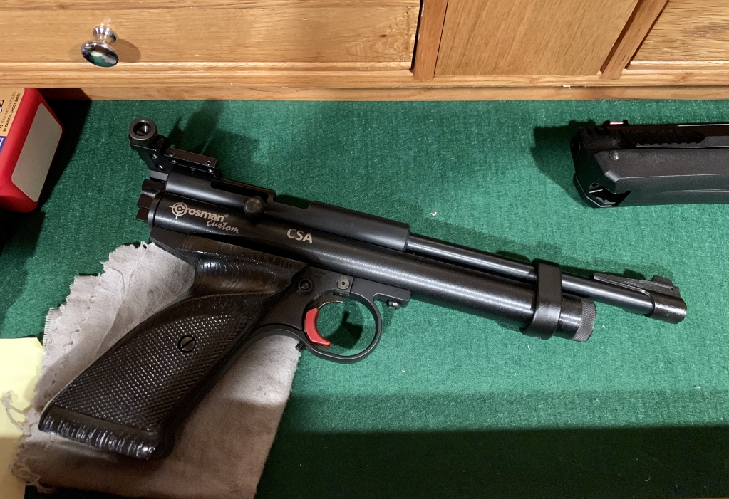

I just received this pistol (see pic) it’s .177 caliber. I’m only getting about 35 usable shots from a Umarex 80g cartridge. 7 grain pellets seemed to get more than the 8.6 grain which is kinda strange. At any rate, shouldn’t I get at least 40?
Also .. at 10 yards I have the Weaver rear sight almost as low as it can go. Probably need a higher front sight.
At any rate .. any thoughts on the above? Thanks !
They have far too much hammer strike. The simplest solution is to shorten the hammer spring incrementally and check over the chronograph. Eventually you'll begin to see a drop in velocity and you can stop at that point. An ideal velocity goal would be about 95% of the maximum.
That will make a substantial improvement in shot count, perhaps 50% more.

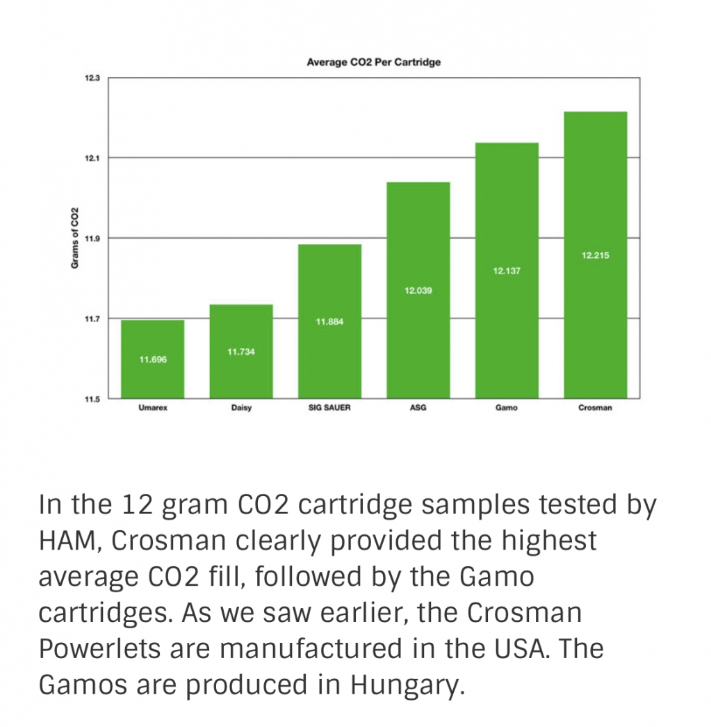

Thanks for the reply. That looks like a viable solution, but I really don’t want to do that much modification on this new pistol. I talked to Crosman and they said heavier pellets can use more CO2. Not sure I agree with that however. Also .. it seems that Umarex cartridges may have a tad less CO2 than Crosman Powerlets. See pic. Not sure if this is good data or not, but I’ll see after I try a Crosman one using the same 8.6 grain pellets
https://hardairmagazine.com/reviews/how-much-co2-does-a-12-gram-co2-cartridge-contain-heres-the-answer/
