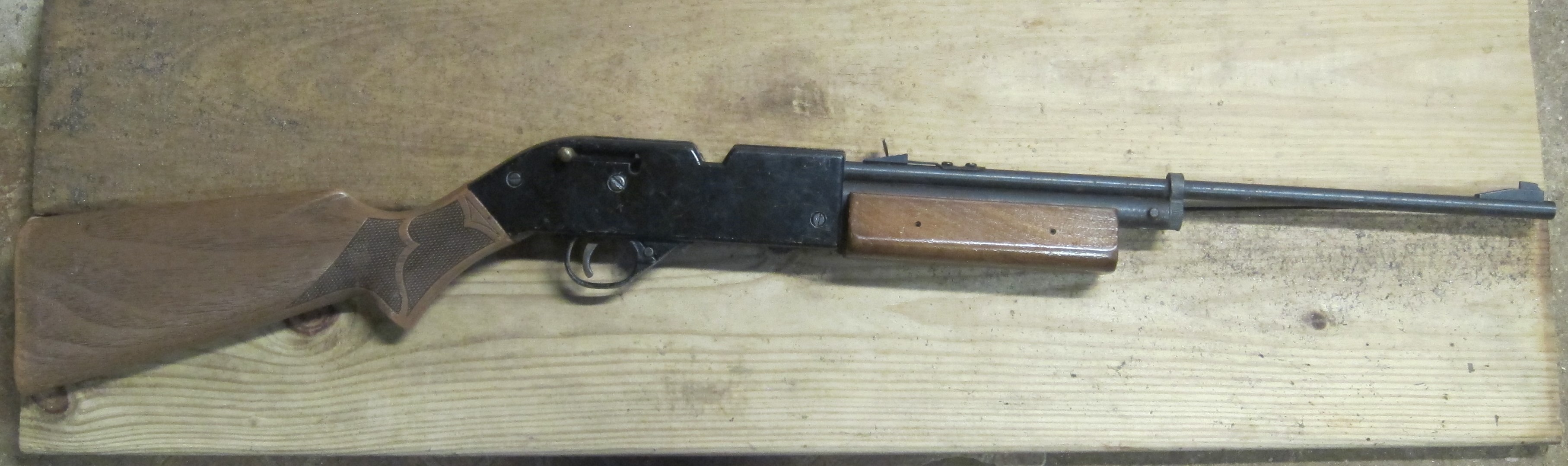

I'm working on my pre 75 760. Well it's a bit of a Franken-gun I think. The receiver is later I think since it has a serial number. How ever, it has the early pump and compression chamber. So I'm calling it a pre 75 since the tube cap is from 73.

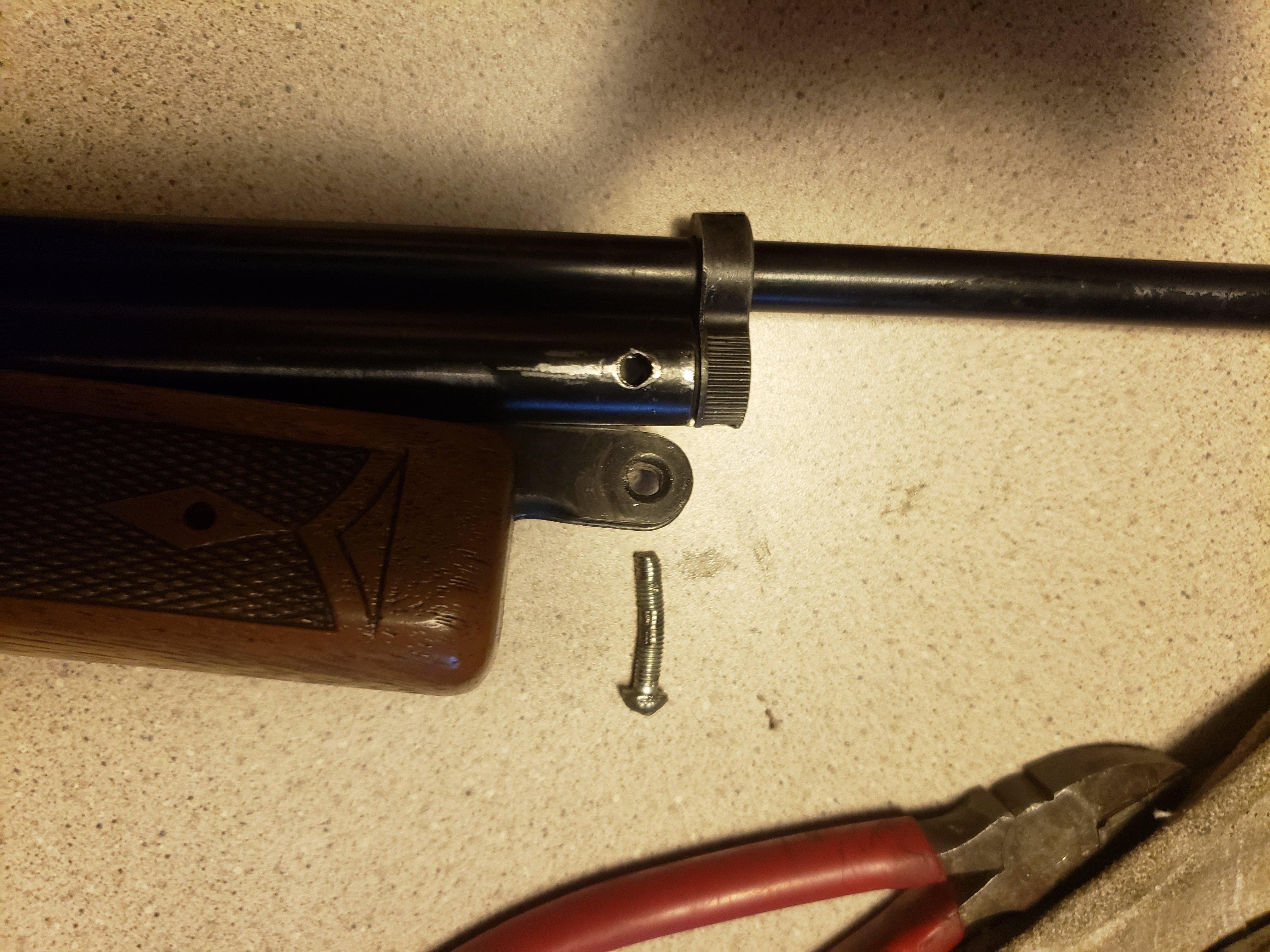

So the roll pin hole is all wallowed out. It had a 3/16'' screw in it when I got it. It was bent, and loose. It was rocking all over the place and really elongated the hole for the roll pin. I put a 3/16'' roll pin in there when I had everything apart cleaning the gun. Suddenly the forearm would not close all the way. And I was not getting any air pressure. Never was before. I thought I assembled something wrong. I must have tore it apart 50 times.
Turns out it was that bigger roll pin, for what ever reason, was not allow the linkage to function properly. I actually think it must have been crooked in the elongated holes. I tried a smaller nut and bolt that I had and it works now. But it's way too sloppy loose.
So I've ordered and upgraded roll pin that has a screw going in from each side. But I fear the hole might be too big. What have you guys done to repair something like this? Thanks for any info.
This pic does not show how bad it really is,,,lol.
