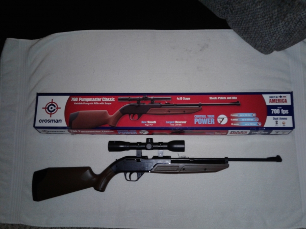

Since I'm on a fixed income, that likely will not happen until after the new year. Then I saw the Pumpmaster 760. It was actually a few bucks cheaper at Murdoch's, but no 4x15 scope. Since it was only a few bucks more, I decided to stick with Wal-Mart and check out the cheesy scope. Got it home, no scope in the box, have to take it back. Next day, I take my boxed rifle to the sporting department where I had seen 2 or 3 boxes like mine that advertise a scope. I put the box down on the counter by the register and go to the shelf where I had seen those boxes just the night before. As I'm standing there with my wife's daughter, the Wal-Mart employee walks up and stands next to me, but says nothing. So I just start explaining what's going on and that it looks like the boxes I saw the night before have been pulled from the shelf.
We walk over to the counter where I set my box down and he goes behind the counter, bends down and picks the top box off a stack of three that are set on the ground, out of sight, behind the counter. Instantly I knew something sketchy was going on. I told him I just want to exchange mine for one that has the scope, as advertised. He opens all three boxes, no scope. So I say whats up? False advertising? Somebody open up boxes and steal a bunch of 4x15 scopes? He says maybe it's just showing that it's possible to mount a scope. Now, if I didn't have my wife's daughter with me, I would've went to battle and walked out with a 4x15 Tasco scope for free for that silly comment. But those things take time and 9 year olds just don't have any patience. I went ahead and bought that $8 Tasco scope, which I will be returning today. Why produce something that is next to useless? I didn't know if my 4x32 Centerpoint that came with the F4 would fit. Well, it does and THIS should be the included scope.

This little rifle takes me back. Loading BB' s in the pellet port and then wondering why they roll down the barrel when I aim downward.
I haven't even broken it in, yet and the groups are tightening up. Can't go wrong for less than $30!!!

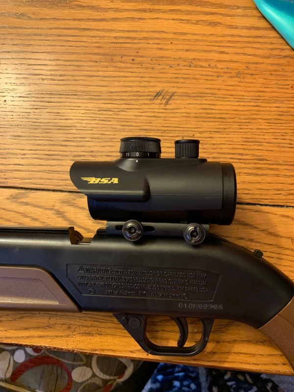

I bought this exact rifle over Thanksgiving to begin teaching my grandchildren to shoot (5, 6, 6, & 8 years old). The 8 year old killed a big ole fox squirrel on our 2nd hunt, it was his first ever on his first hunt. He is hooked! He didn't kill it with this pellet rifle he used a single shot .410 but I'm teaching him to shoot with it.

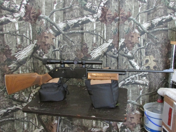

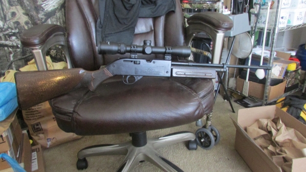

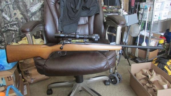

I like the Winchester 4x32AO scope. I also like the Centerpoint 3-9x32 mildot scope that came with the GuideHawk NP, that went to the model 70 before landing on the 760-D Pumpmaster, variant 8. The Winchester 4x32AO adjusts down to 15ft & 30ft markings (5 & 10 yards, respectively) before going to yard markings. Clear and accurate so far. And the Centerpoint 3-9x32 is their German-style mildot I happened to like.
I'd like to get a few more of the Winchester 4x32AO's for the other 760's in my collection. Good scope for their limited range.
Here's the model#70 Pellgun with the Winchester 4x32AO on Hawke mid-rise mounts;
And the 760-D Pumpmaster with the Centerpoint 3-9x32 mildot on Hawke mid-rise mounts;

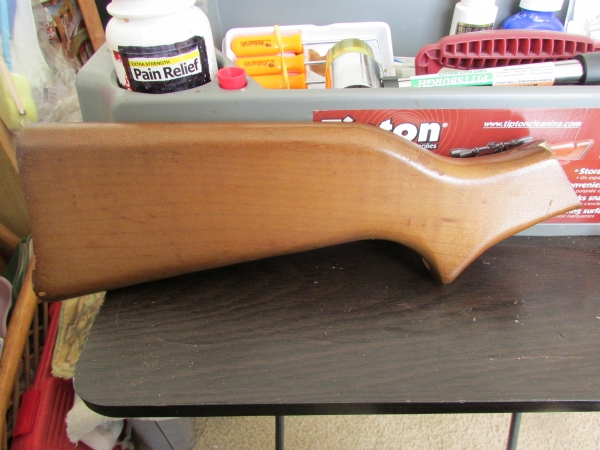

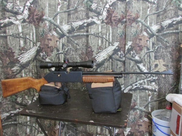

I also have a 760 Powermaster variant one with wood stocks. Built 6/70. Only the plastic ones were called Pumpmaster. And only the variant one through variant four that I also have are metal receivers. It also shoots BB's and pellets, but it only sees pellets from here on. The 760 variant 1 looks to have been originally given a low-grade flame maple set of stocks. But the brittle, murky spray stains factories used in those days mostly hid it. You can see them faintly in this pic.
And after being restomodded with a NOS 761XL barrel, mac 1 seal/piston upgrade kit, and MOE 2.5" picatinny rails for the scope. The Minwax #224 special walnut nailed the original stain color. Polished & reblued all steel parts, even the screws.
