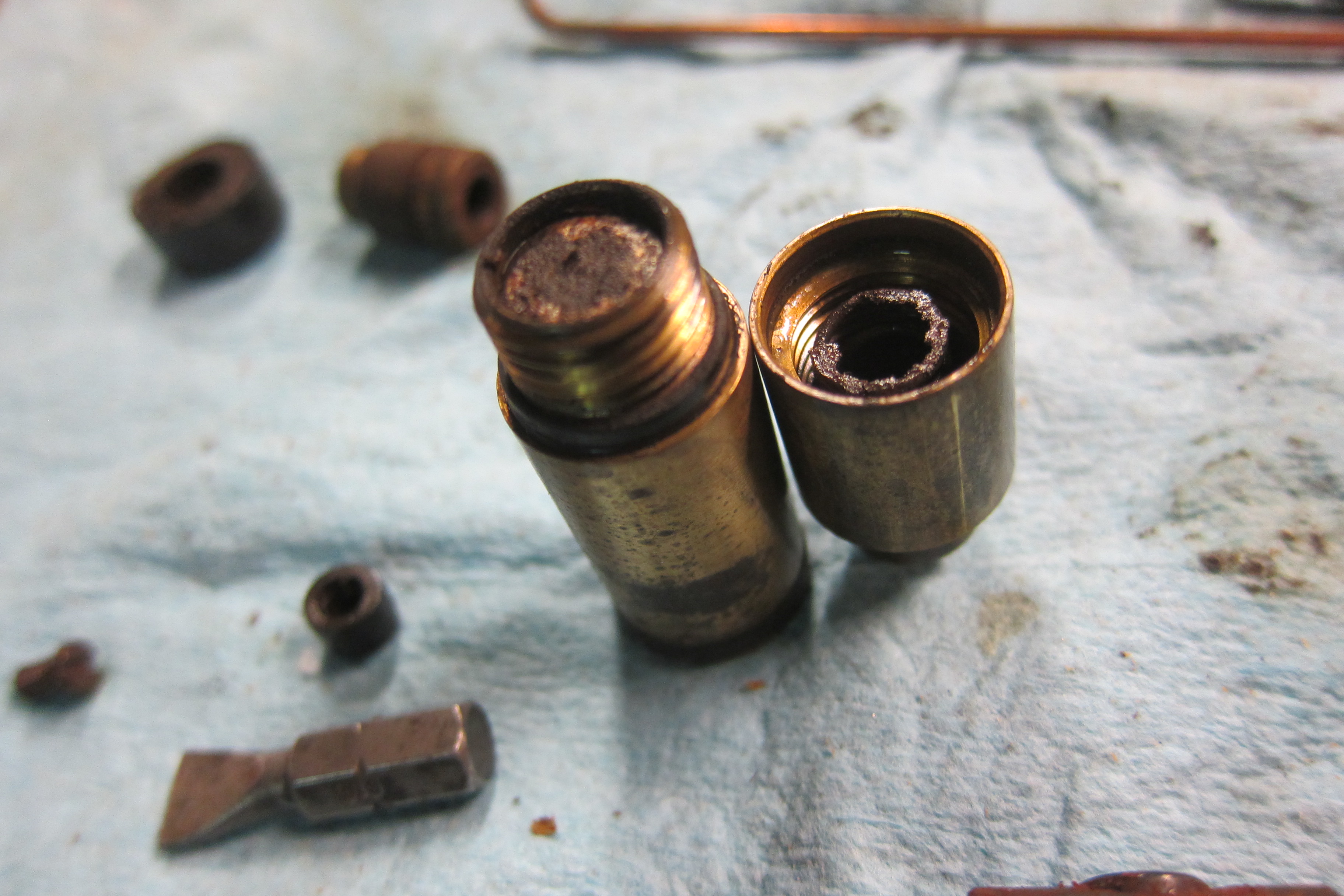

I found the article very informative about replacing the seals on my Crosman 760. I also found out it was made in July 1970. Thank you. After replacing 3 of the 4 seals and reassembling the BB gun, it still will not pump up and hold air. The 4th seal in the replacement kit just did not look compatible. I noticed when I took the brass valve apart the spring was corroded a little and only one plug came out. It looked like another piece was still up inside. Any suggestions?
The valve in that model resets after firing, so it doesn't need to be cocked.
Fom what the OP is saying, it sounds like it isn't keeping the air pushed into the valve. Does it hiss from the rear of the barrel when you pump it? If so, that's a leak in the quad-seal side of the valve. If it won't take the air in the first place, then the problem is on the pump end of the valve.

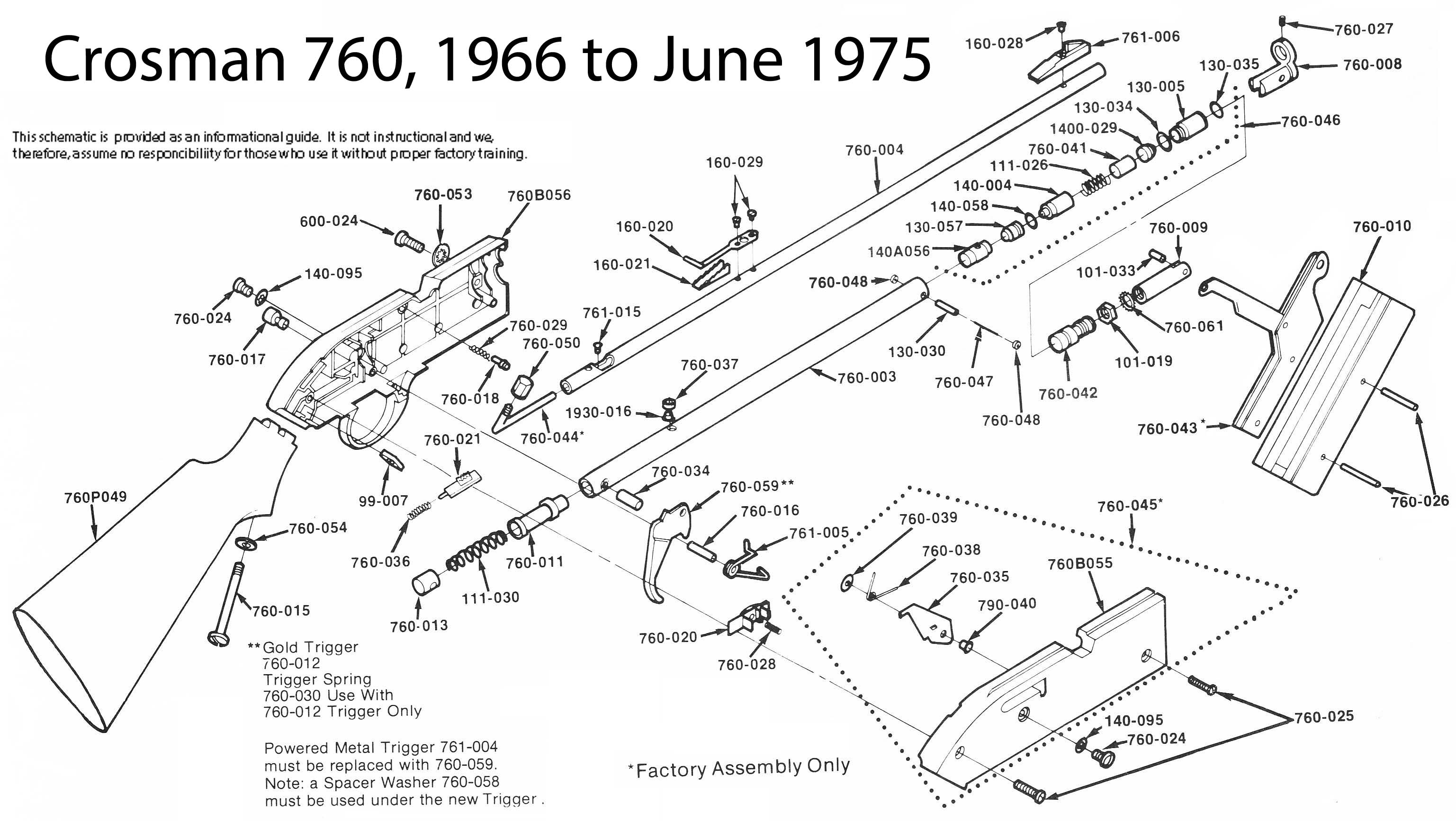

Here's the parts diagram.

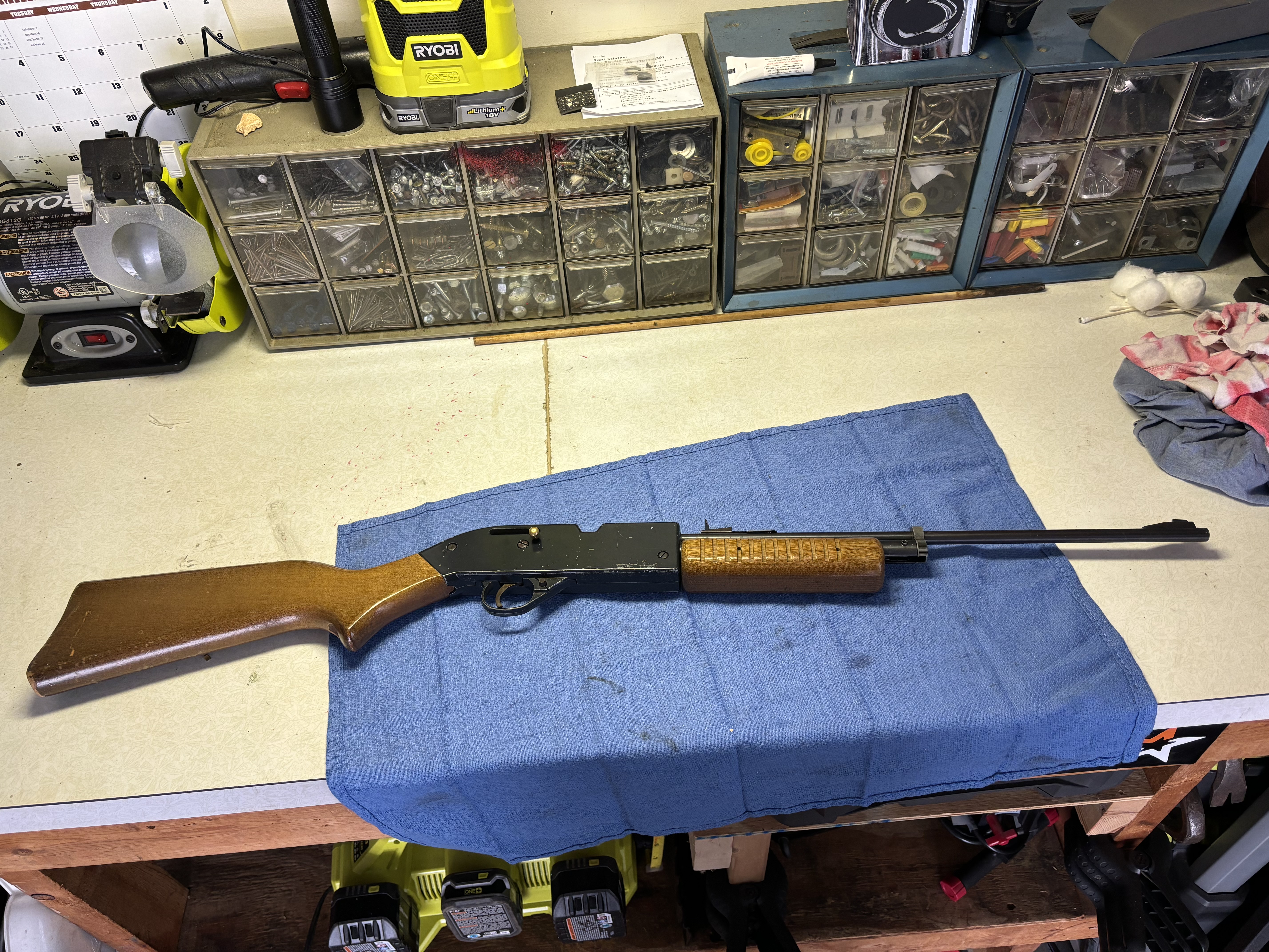

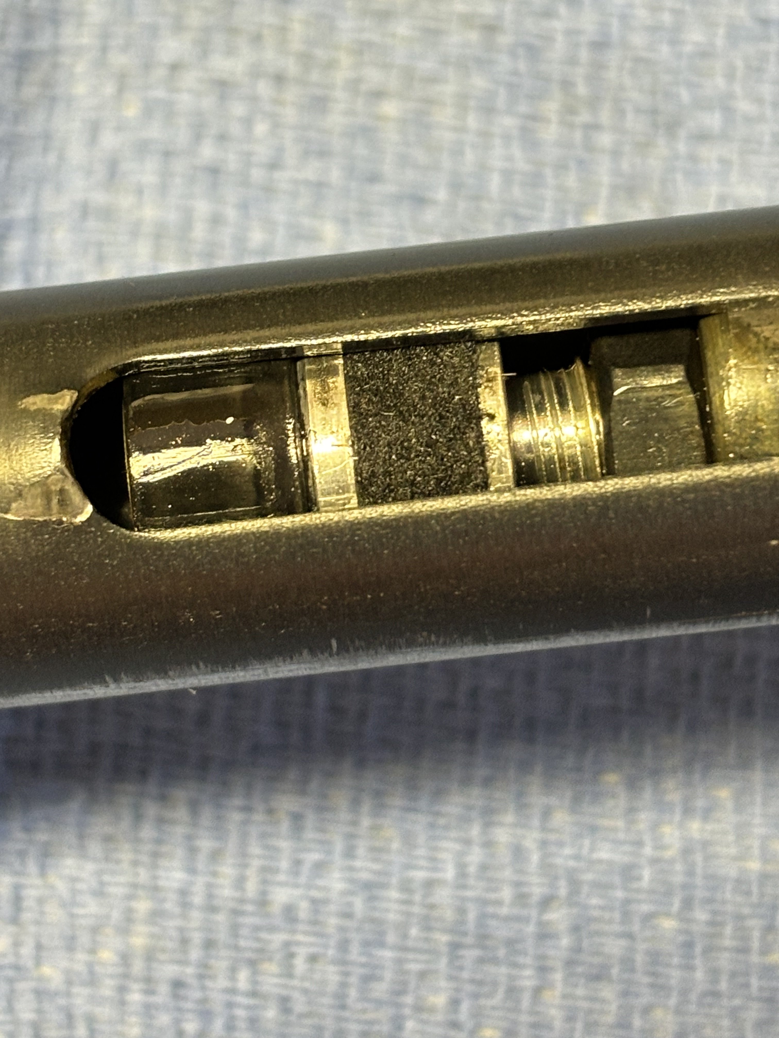

Okay I just tried an experiment. I opened the pump handle and laid the BB gun on its back. I got the pump handle started and it closed on its own except for snapping onto the tube of course. There was very little resistance down. It didn’t slap down instantly. It was a gradual down. It did not stay in an upright position like as if it there was a good seal. Here is a pic fully opened. This is my BB gun from when I was a kid a long time ago so I would like to get it operating again.
Okay. It sounds as if the piston pump-cup is getting somewhat of a seal. Does it spring back open when you pump it quickly? If so, then the seal within the pump-side of the valve (part #1400-029) isn't holding the air in. You're probably going to have to pull it down and re-do it. Been there a few times... Cleaning the mating surfaces on the interior of the valve with 000 steel wool will help it seal better. Pell-Gun oil is good to use and you can get it at WalMart.
