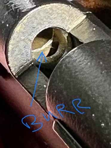

My Crosman 392pa has never been an accurate rifle with any pellet (1-2 inch groups at 10 meters, on a rest).

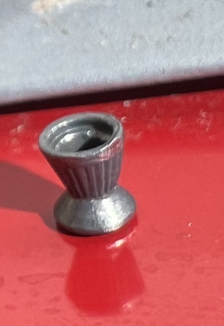

Did a pellet push through today, and what do you know, there's a flat spot on every skirt and some of the heads (same orientation).
A flashlight in the breach shows what looks like a burr in the bottom of the chamber, where the transfer port comes in.
I'm thinking a little Dremel abrasion to grind off the burr, but I'm concerned about getting brass shavings down the transfer port.
Maybe stuff a small bit of cleaning patch into the transfer port to block it? I would dampen the patch with Ballistol to help hold on to the shavings. You can always do an alcohol flush afterwards to clean out the valve. Then lube afterwards of course.

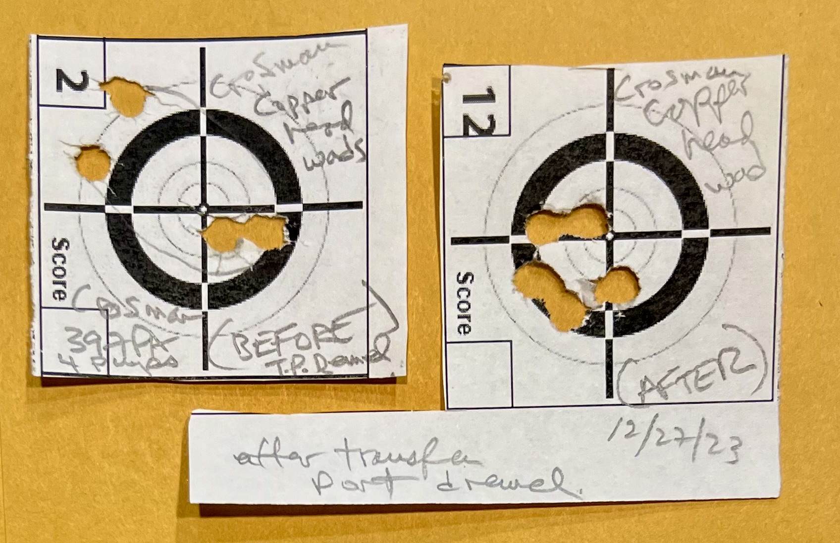

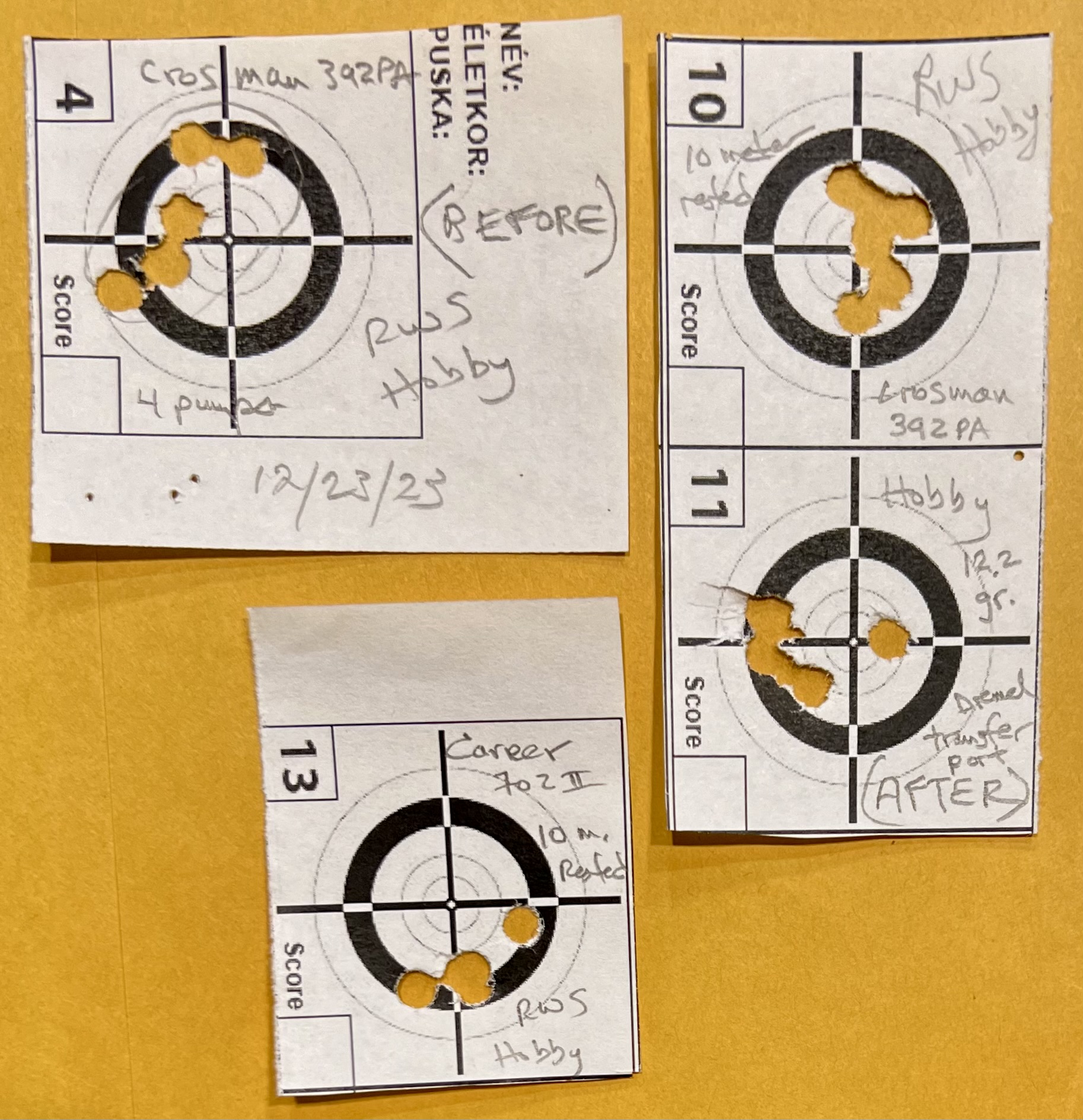

Thanks, Virge! I did as you suggested and don't think I hurt anything with the Dremel (fine diamond ball bit) :)
Will post results shortly.
Thanks, everybody, for the advice!
That diamond ball Dremel tool made quick work of the burr, and the pellets load MUCH smoother.
Here are before and after groups red dot sight, 10 meters, rested.
The group with the Career 707 II (peep sight) is to give you an idea of the best I can do with any rifle, off a rest without magnification)
I think the burr removal helped some — still no tack driver, though…

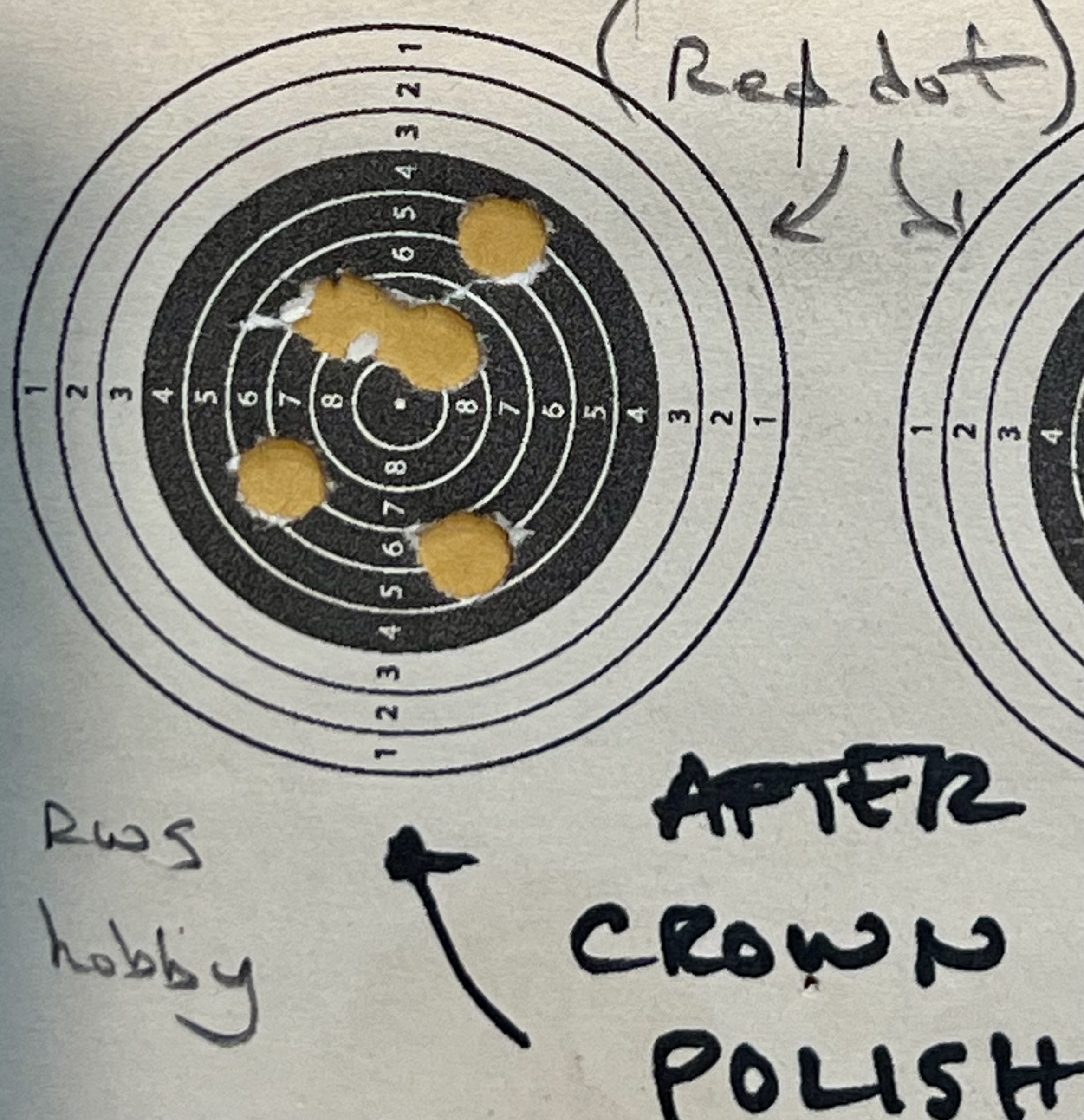

My 397PA does much better with 8-10gr domed pellets than wadcutters. Have you checked the crown for burrs or other damage? My brother's 392 was a mess, but got it shooting great with a hand drill, brass screw and some lapping paste.

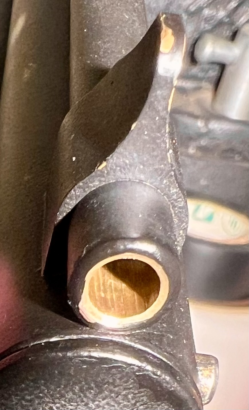

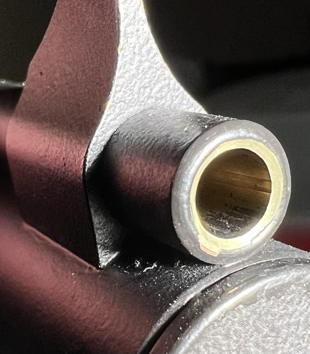

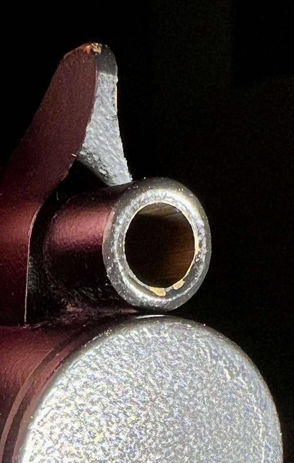

Here’s what the barrel crown looks like. Looks like I need to work on that a little before trying different pellets, eh?
Crosman 392PA — paint overspray in the crown.

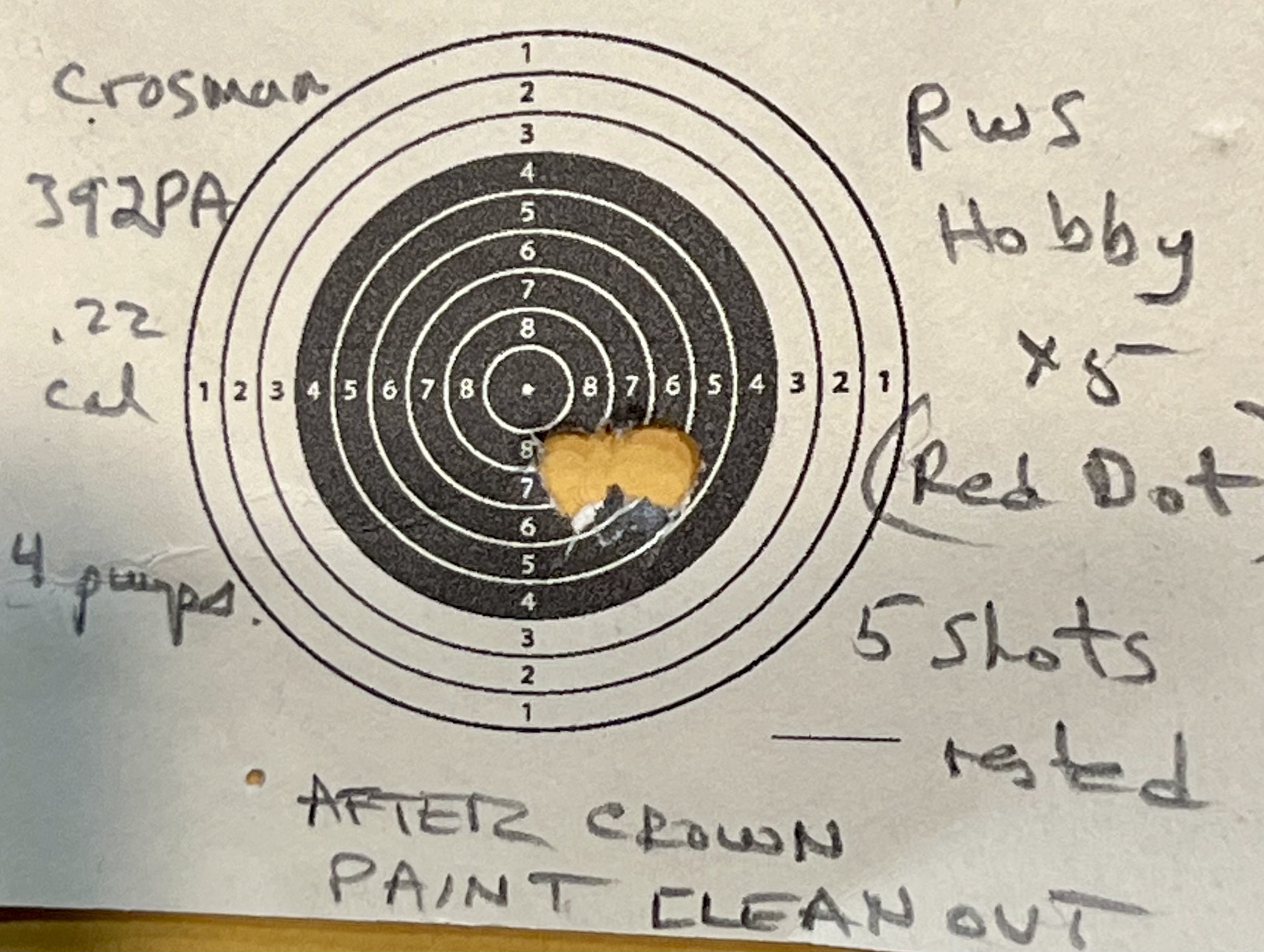

Paint remover in the bore overnight and thorough cleaning this a.m. did the trick!
At long last, I have a rifle I can shoot with satisfaction.
Both targets 5 shots rested at 10 meters, 4 pumps, .22 RWS Hobby 12.2 grains.
GET THE PAINT OUT OF THAT BARREL!!!
Wow, getting that bit of paint out makes a huge difference! I'm going take another look to see if mine are that clean. What did you use to remove the paint?
I used Sunnyside Ready-Strip, contains:IMG_7876.jpeg

I was pretty unhappy with my Crosman 392PA with its huge groups compared with my old Sheridans, even though the overall build quality seems quite similar. As you can see above, removing the breech burr (that was deforming the pellets) and the redneck crown job I performed (with the brass screw/glass polishing compound) didn't do much (likely just cosmetic), but after getting that paint out of the barrel, accuracy of this gun is LOTS better, and the thing is finally fun to shoot offhand. Restored my faith in modern American manufacturing (although whoever sprayed paint into that muzzle sure can’t be proud of his/her workmanship).
