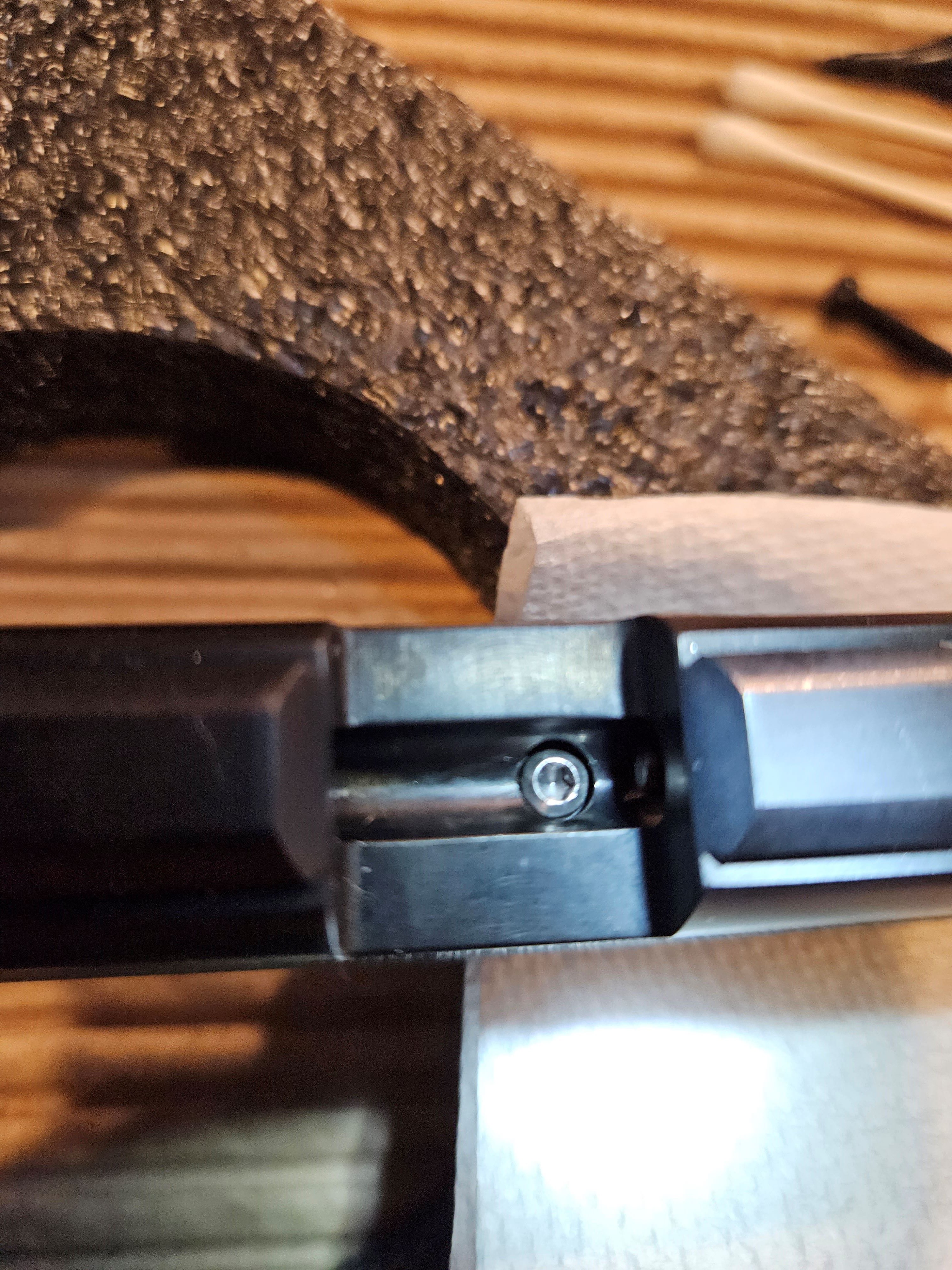

Disassembly/reassembly is pretty easy. The frame screws were reasonably tight as were the barrel band screws. All of the others were very loose, except of course the .050" allen breech screw. That required drilling & an ez-out. It has been replaced with a stainless torx head. Even the barrel screw was loose.

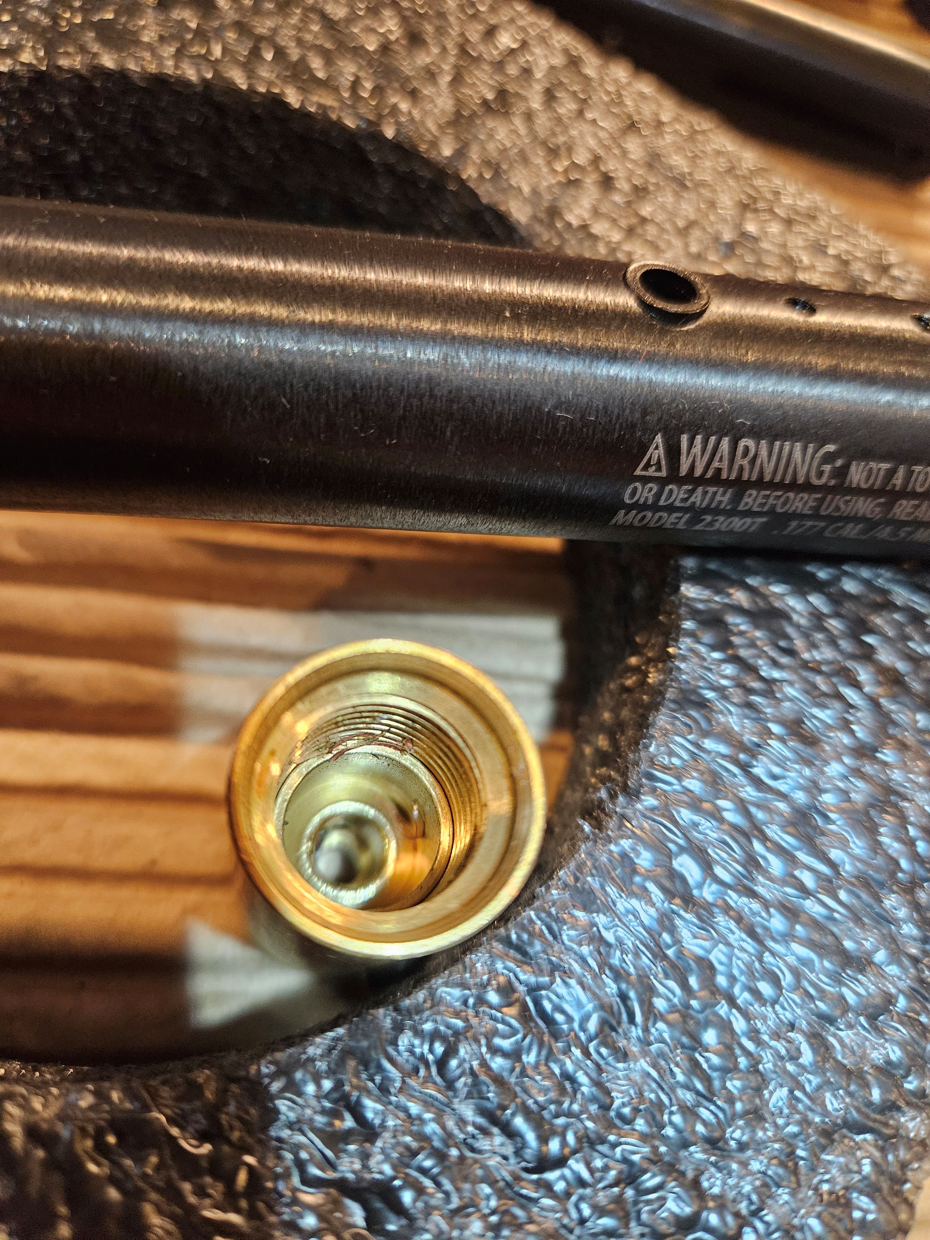

I had ordered a poppet valve and face seals, but neither one was required. The valve disassembly fought me until the last quarter turn when it revealed red thread locker and brass burrs. Remember, this was purchased new from Crosman at Christmas.
Once the schmutz was removed from the threads the valve went back together with ease. The poppet was just oily with no burrs or damage. I hate that I had to tear into it, but it is better for it with a clean valve and tight screws.

While I'm very much a fan of threadlocker for things at risk of backing out or self-adjusting, I see no need for it on the threads holding the two halves of a 2300 / 2240 / 2400 valve together.
If you do use it, be very careful that it does not come into contact with any synthetic materials like the O-ring or poppet. It aggressively attacks many plastics and elastomers. "It" being methyl methacrylate.
