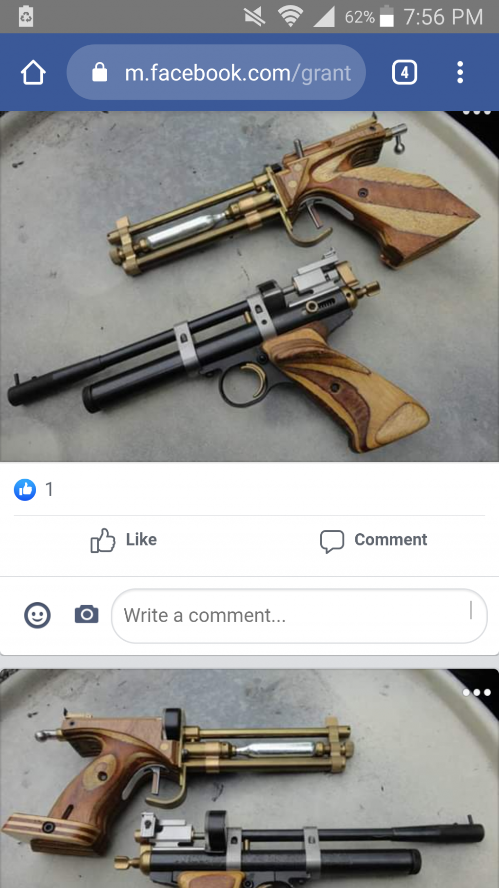

Crosman 22xx?
Several of us still mess with them here is my most recent. It's a twenty year old mod re-invented.
Custom air shop repeater breach https://www.airgunbuy.com/
Modified valve
Modified fake co2 cart
HPA conversion running 850-1200psi
System-X drop forward https://www.e-paintball.com/brand/system-x/
Made an adapter for the;
FX barrel liner https://www.trenieroutdoors.com/airguns/fx-airguns/fx-airguns-4/
I made the carbon fiber shroud but just recently received some Delrin rod so now I can shorten it a couple of inches
It will shoot the 18.2 JSB @ 700 fps. Although I tuned it down a bit to shoot five and ten shot groups through one ragged hole at 25 yards
