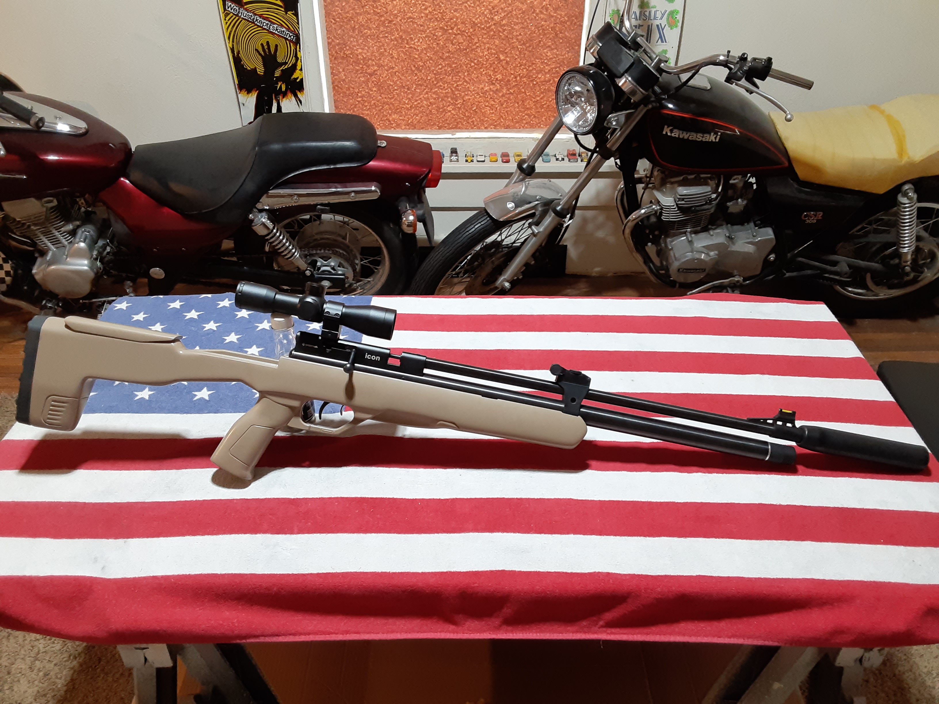

The Icon is one of the reasons I sold out of co2 stuff. After pumping probably (definitely) thousands into the 22xx platform, i have a whopping $135 into this setup including the buck rail mod and it's putting out just a squeak under 40fpe with slugs. Cheap optic in this pic was just a temp thing.
Just port job and hammer spring on the icon to get that 40 fpe? I've got a beeman 1358 I'm tinkering on and thought about upping the power.
Yep. Hammer spring is about 8 turns in to max fpe. I didnt even port the valve block. I started a thread in the pcp section. I would LOVE to have an underlever so I could do the same.
