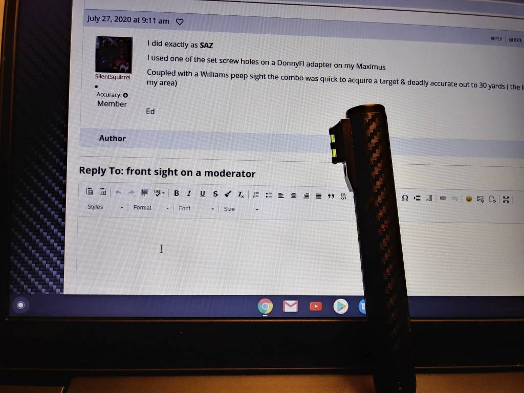

I've received my 2240 and as we all know it is a jewel. Where i erred was in not noting that it evidently takes an XL to be able to put a moderator on the thing. Oh well, if I ever develop a continuous use of the pistol that requires more discretion I'll solve it then.
Donny Fl, a maker of good moderators for air guns makes an adapter for the 2240, Probably requires removing the front sight,but that is easy with a couple of light taps with a small hammer or block of wood.
Get a TKO, and add a Discovery front site via super glue
