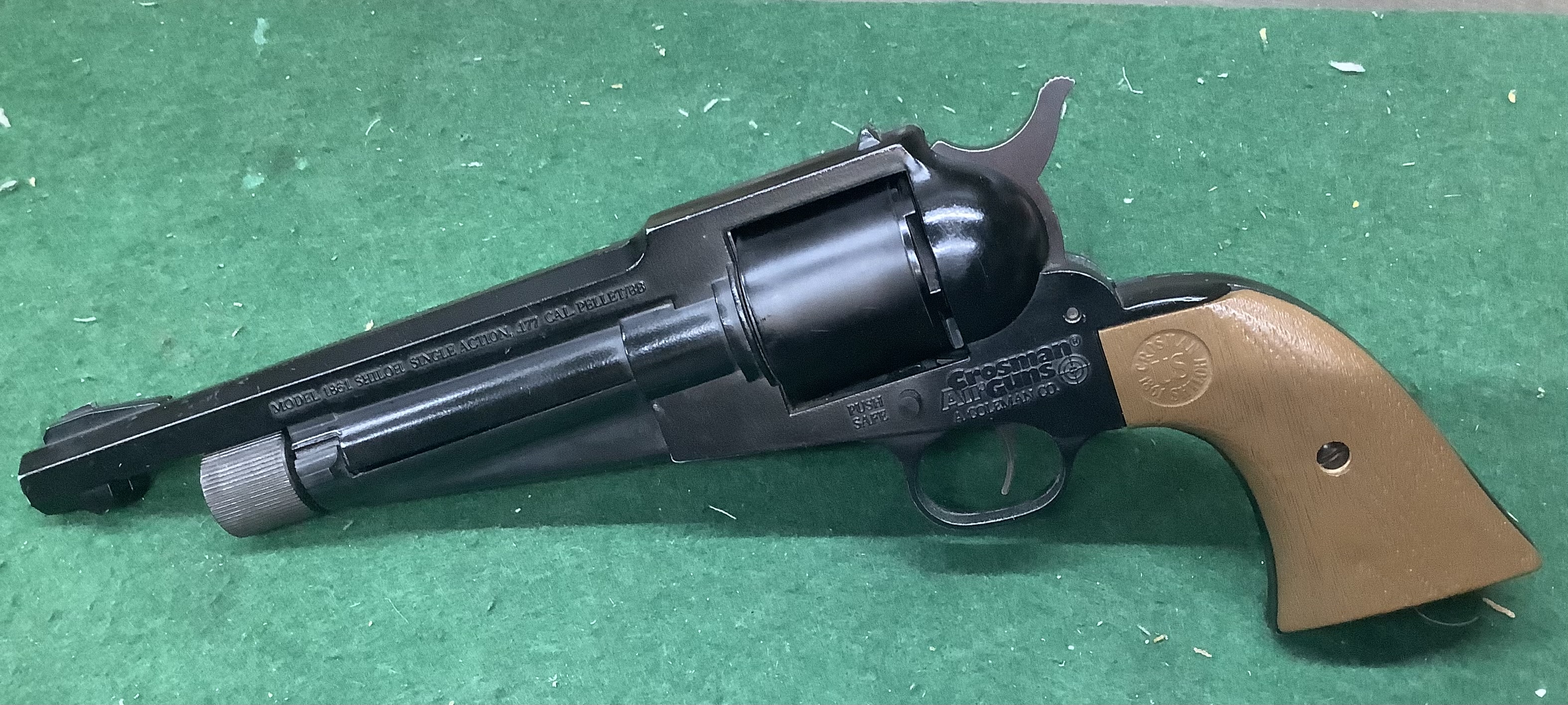

I sealed a Crosman 1861 Shiloh this afternoon and thought I'd share a few pics.

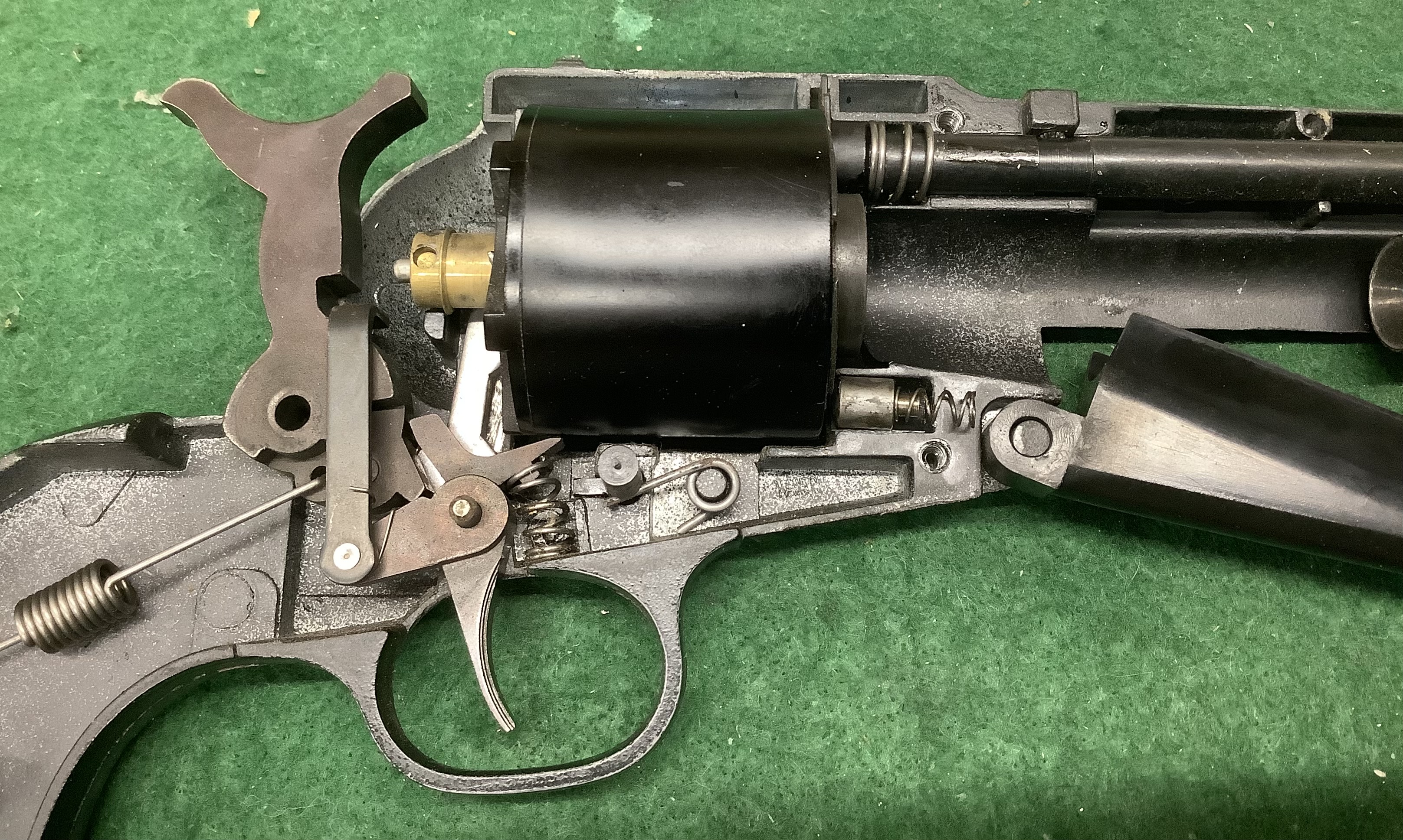

The side plate is held on by five screws. If you maintain pressure on the cylinder pushing it down into the frame of the pistol, the parts will stay in their correct places. Most of the parts will hold themselves in place until you start disassembly.

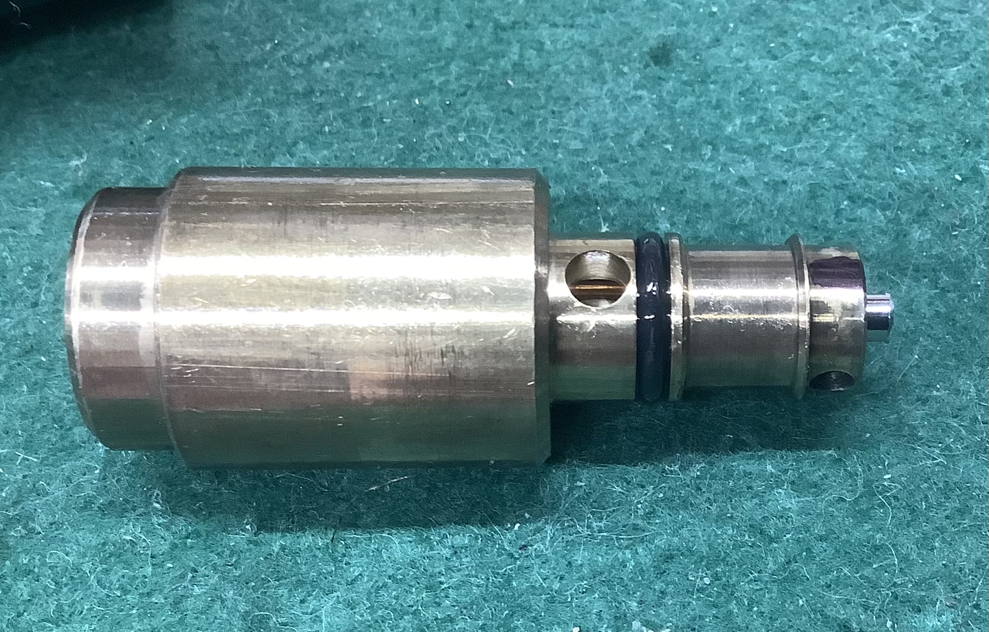

The only seals that can be replaced are the CO2 face seal and one o-ring on the outside of the valve assembly. The exhaust port needs to be indexed correctly so I added a Sharpie line to the end that's visible when the valve is back in the cylinder.

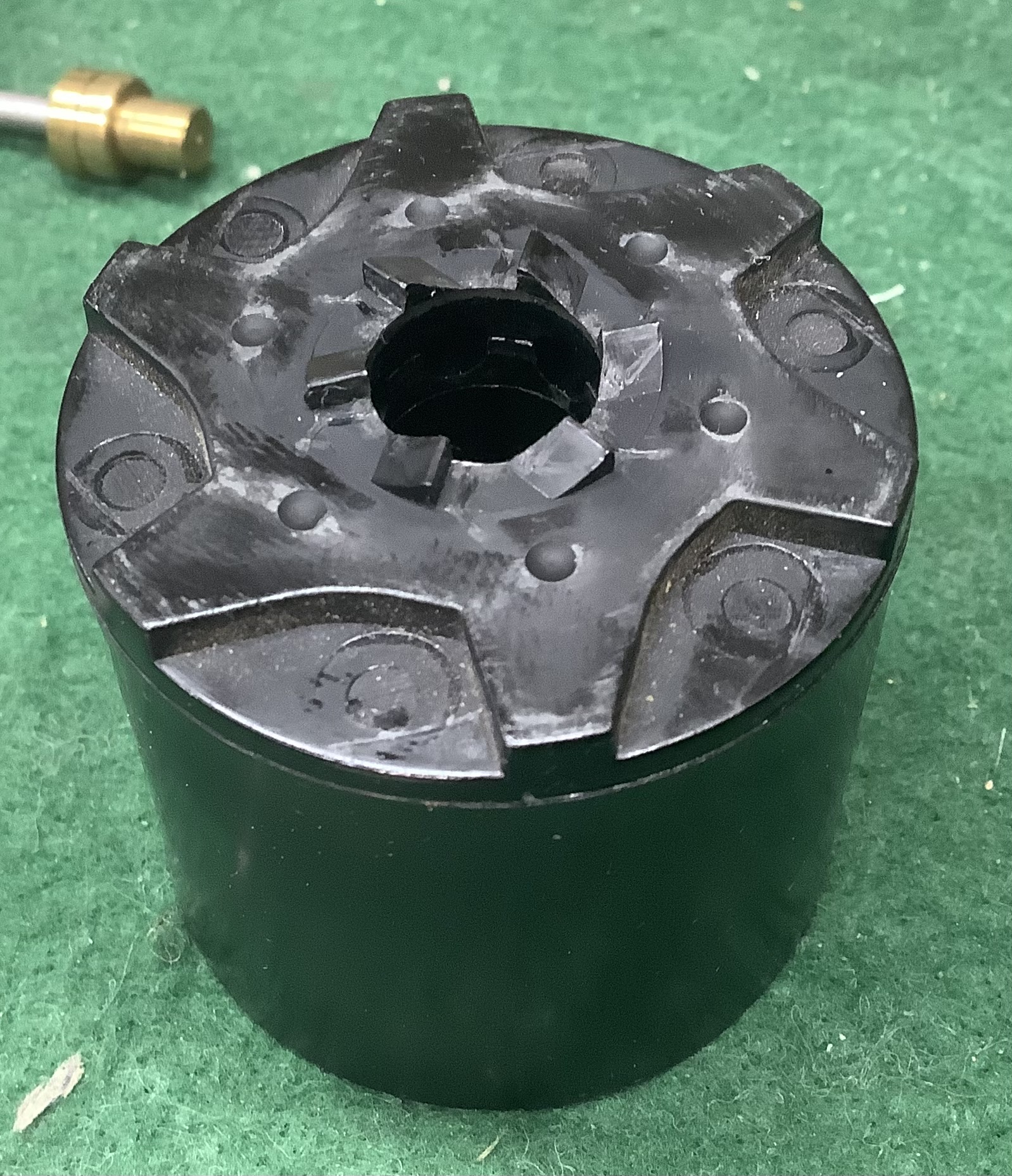

The cylinder is plastic. Luckily this one is in nice shape, and it rotates and indexes properly.
